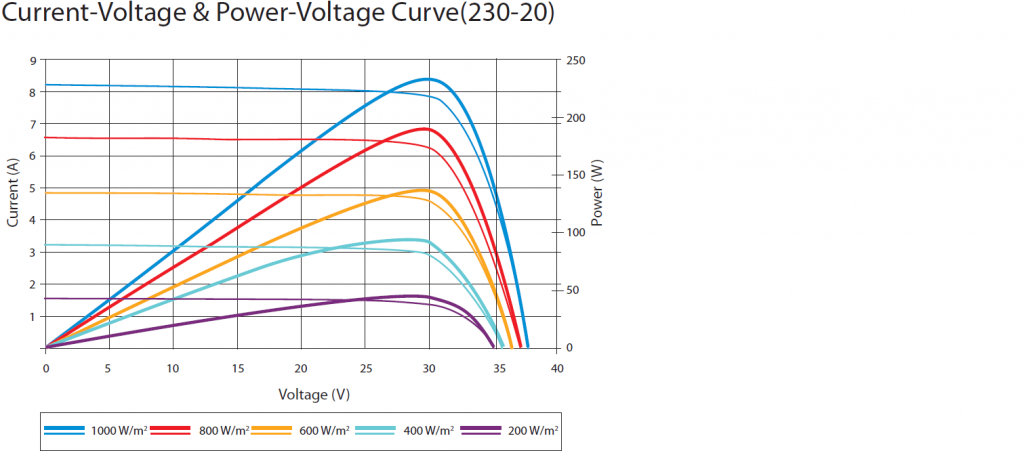

This idea keeps going round in my head and won't give me any peace so I decided to put it into practice and to the test.
Reading up on the much more sophisticated solar water heater Controllers last year I came up with the idea of simply pulsing a Mosfet connected to some caps to keep  panels on their efficiency Curve when driving a mains rated element.
What I have set up is an arduino driving a Mosfet for turning the 240V, 3.6 Kw element on and off so the caps are either charging or dumping into the element.
After a few days of getting my head around it again and remembering the more I had forgot than remembered, Today I got it working, set up 4x250W panels and hooked it up. I can't remember the size of the cap bank i'm using but from memory it was around  12-1800Uf.  I taped it up real well to avoid nasty surprises.
After figuring out after a couple of hours the thing WAS working correctly, just my testing was stupidly flawed ( It is NOT easy being Dumb and most frustrating let me tell you) I set to " Tuning" It by measuring the voltage coming from the panels. One thing that did come out of this, I -may- have found where I went wrong with Tony's board he made me. I robbed the cap bank from that so when I'm done with my simpleton setup, I'll retry the intelligent designed one again and see if as I think, the testing by the idiot was flawed not the board at all.
So far what I have which was done in the late afternoon, is a Discharge time of 5/1000ths of a second ( can't figure that out in Hz  :0(  ) and a charge time of 250/1000's of a second ( 4 Hz? ) seemed to put the voltage where I though it should be around. I was seeing a low of 115V on the meter and a high of 128 with 132 Open circuit and a stated MPPT on the panels of 30V so 120 all up as should be the sweet spot.  Never tested panels yet that came out at the stated numbers so i'm not worried about a few volts off.
I'm sure the meter reading isn't accurate at the speed of the switching but I was also seeing down to 50V with my initial guess setting of 100/ 1000ths on the discharge and 200 on the charge so I think I'm in the ball park.
By varying the numbers I could see the voltage changes on my Multimeter which I guarantee is way too slow However I think it's fast enough to allow me to see when I was hitting the upper voltage coming from the panels unloaded and when it was also bottoming out.  I'm seeing a swing of about 10V which may in reality be a lot more but it's a start and I do not know any other way to do the tuning.
I was thinking of putting an Incandescent light bulb in parallel with the heater thinking perhaps the brighter I can keep that going the better.  It will be interesting to see what readings I get in more midday sun tomorrow as it was pretty late this afternoon time I got things sorted.
I chose 4 Panels because they work out to be the best for direct Ohms matching to the element.  I am trying to see if I can better the direct ohms matched connection which I will try to set up another 4 identical panels I have tomorrow and test them side by
side but I'm wondering if I'm flawing the test doing that?
Perhaps I should be using 6 or 3 panels and testing for non matched Ohms?  I don't think the power out of 2 Kw of panels direct would work well but perhaps that's where this dumb switch might have an advantage? That said, I did direct connect the panels and saw a bit under 50V where as what I was seeing with the setup running was well over 100.  From this I take it i'm on the right track at least.
If I can find 2 Identical buckets ( Refuse to go to bunnings and wear a BS face nappy for the stupid population control measures we have here atm) I'll set up another 4 panels and the other identical element I have and give them a run and see if I can do better than the direct connection with the best panel config or it needs to be  Not Ohm matched... which would still be OK. I think more practical to throw 2 KW at water 1 anyway.
I don't know what the power delivered is with 4x250W panels ohm matched to a 3600W element ( But I'd like to know from the people clever enough to work it out) but I bet it's pretty inefficient even still. I don't know what I could use to measure the power that I have or wouldn't cost a bomb but if there are any suggestions.... I did buy a DC powermeter but soon as I set it up on the test load I could see it was reading fantasy numbers and there is no way to calibrate the rubbish thing. I have the same one in AC and it seem very good.
Anyway, in line with the rest of this crude setup, I spose the only test I need to do which I can is back to back the " Controller " with a set of panels direct connected to an element and see which one makes the water hotter over a given time and different times ( morning/ Afternoon).
If this does show promise, I spose the next thing would be to make some water heaters out of 44 gallon drums so I can run from dawn to dusk and take measurements though the day and see which is the winner that way. Other thing would be which one wins in overcast weather.  I -think_ the ohms matching might go off the rails a bit there.
I was looking to use some other timer boards for the pulsing but so far all I have found ( and setup) are ones that do 10'th of a second and that may be too slow.
Still unsure about the speed I can charge and discharge these Caps taken from a Solar GTI and how many I need so as not to fill them and waste power as this setup is a constant pulse rate and does not take into account the voltage in the caps.
I'm hoping it still may be better than straight Ohm matching and other pelicans like me could set one up for themselves.  The arduino sketch is merely the Blink  program re timed.
Anyway, any input appreciated and I'll report my faili.... findings when I get some.

Within reason the heater load discharging the capacitors is not all that critical.
Obviously you need enough load to discharge into to recover worthwhile power, and a hugely excessive load will draw enormous current peaks, which would be inefficient.
A light load will have a much longer discharge time, and a heavy load a short high current discharge.
Likewise poor solar will require a much longer charging time, than full solar.
The optimum timing will change a lot, and larger capacitance will slow everything down too.
The basic strategy would be to charge up to a specific capacitor voltage, then connect the heating load, and allow the capacitors (plus solar) to discharge down to a lower capacitor voltage, then disconnect the heating load. The whole thing then charges back up, and the cycle repeats.
Its the voltages that should stay the same, and the timing self adjust to suit.
That could be done either with an Arduino, or the LM555 timer chip I used.

  InPhase said  Couldn't you just strobe the current as the maximum power point is exceeded? If you monitor the voltage and current from the PV you could turn off the FET when you exceed the rated knee current. By measuring the capacitor voltage on the output of the FET, you turn it back on again after the voltage has fallen below the knee voltage. I have no idea if that would work, but it sounds at least testable.
Yes, that is what the boards Tony made do. Measure the voltage each way and turn on and off accordingly.  No question they are a much smarter and more effective approach but I really just wanted to see if a sticks and stone simple Idea a moron like me had could do better than the ohm matching technique. I think this is a bit more doable than other methods for those electronically challenged but may be more capable in just wiring things together. If I can do it, a lot of others can that's for sure.
I know this has a lot of inefficiency but then again, I believe the ohm matching approach may have more so it's just a hope for improving something to be a little less worse than it could be while still being not bear as good as it can.

The really simple system is Ohm matching which you've obviously worked out:- 4* 250w 30vmpp = ~120v  ~1/4 power of the element, or 2*8* 250w 30vmpp for full power. But only works efficiently with more or less full sun.
I suppose with your adjustable on/off controller you can compensate for different levels of sunshine by changing the on/off ratio to match the ambient light, but that's quite laborious if your having to change it manually every time the light level changes.
You could also do 6*250w with a 75/25 on/off ratio (full sun), or 8*250w with a 50/50 ratio, which gives you more power options, but you still have to adjust for actual light level.
Trouble is you seem to have a working system that's 90% of the complexity of a voltage sensing system, but without the benefit of it being self adjusting to variation in the light.
Hence we keep coming back to voltage sensing. :)

Thinking about your 4 panel test setup: you can't achieve max efficiency in full sun as the Vmp of 120v (I'm assuming your panels are 250w and exactly 30v vmp, Imp 8.33A) means the Imp will be >7.5A in full sun, and you can't achieve that without going above 120v Vmp even with 100% on time.
If you went to 5 panels Vmp 150v then full sun voltage on the element will be 133v nominal (89/11 on/off). At that point you should win vs ohm matching - as long as it's 100% sunshine. In theory :)

It needs to swing through the max power voltage.
I think you said earlier that VMP was 120v, that sounds about right for four 24v panels in series.
Something like 10v above and 20v below might be suitable set points, so swing between 130v down to 100v perhaps.  Power falls off much faster on the high voltage side.
Your directly wired panels are pulling the voltage way down to 88v which will be overloading the panels well below the sweet spot of 120v.

It will probably not work nearly as well with a lot less panels, either direct, or through your capacitor cycling system.
The reason being there will be a lot less loading on the panels at much lower voltages, power drops to one quarter at half voltage with the same heating element load.
There may not be enough loading for the capacitors to dump enough energy, and the voltage will not be pulled down far enough to get it to cycle properly. It will very likely work better with direct permanent full time connection to solar under those conditions.
The system really needs a heating element big enough to be able to easily overload the panels, even with full sun, so it can cycle properly with a relatively short discharge time.
Earlier you had an ohm matched system and the cycling system did not offer any improvement.
If you reduce the heater loading even further, I suspect its not going to work at all.
This is going to work far better at higher voltage, or at least enough voltage so that the heating load will be heavy enough to readily overload the panels under full maximum summer sun.

  Quote  "There may not be enough loading for the capacitors to dump enough energy, and the voltage will not be pulled down far enough to get it to cycle properly. It will very likely work better with direct permanent full time connection to solar under those conditions."
This bit I am unsure of what you mean.
You will probably find that with a very low solar voltage, the panels really want to be continuously connected to the load for maximum power. Any time the load is disconnected (during charging) reduces the power in the load.
If the heating load is exactly ohm matched to the panels, such that the panels are operating right in the sweet spot, where the system voltage is spot on the maximum power rated voltage for the panels, that is the perfect situation.
Nothing can improve on that.
Now if we reduce the load, by (say) fitting a higher resistance, lower wattage rated load, we will be cheating ourselves. The panels will be insufficiently loaded, and the solar voltage will be higher than optimum.  Power is reduced because the load is just insufficient to draw enough current to be useful.
That is pretty easy to understand, no load, no power.  We can increase the loading right up to the ohm matching point, and get more power as we go.
Now consider what happens if we have a large number of panels, all in parallel. Very low voltage, but a huge potential current available. your 3.6Kw element is going to look like a very small high resistance load, compared to what the panels COULD handle.
So the panels remain under loaded, and performance is poor.
That is the situation you will have if you reduce the panel voltage below the perfect ohm matching point. The best you will ever be able to do will be just connecting the panels direct to the load, or running your system in CONTINUOUS discharge, which is basically the same thimg.
In other words, minimal charging time, maximum discharge time (like forever) will give best power, which is going to be be piss poor anyway.
So the hot tip is, work out the ohm matching point, where the loading is perfect for the solar panel voltage and rated power.
For the capacitor cycling method to work at all we need a heavy load and a high solar voltage, such that the load would be far too much and pull the panel voltage right down if direct connection was used.
The capacitor system then cycles REDUCING the effective load on the panels, allowing them to run at the sweet spot.
On a grey cloudy day, this will happen naturally as the load stays heavy, but the panels are very weak under those conditions.  The capacitor cycling needs a very long charging time, and will dump into the load transferring all of the available power, without overloading the panels.
