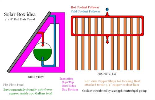

I want to make a test rig for warming my garage during the winter. If it works well I might build more boxes like it. I currently have a few types of insulation, plenty of copper strips, access to sheet metal and a brake, soldering equipment, etc. to carry out the plan. My worry is that this box will get overly damp from condensation or that if the pump overheats it could catch fire or something.
My basic plan is to use a flat panel to heat anti-freeze and store the heat energy into a tank that double as the heat exchanger. The tank will have a second set of insulated lines that run to the garage and a thermostat controlled pump in the garage will drive that closed loop to a heat exchanger therein. The pump on the tank will be controlled by its own thermostat so that it shuts off when the flat panel gets cold. The coolant will be a drain-back loop, so it has no coolant in the line if the internal pump is not active.
The idea I have it to build this thing on a pallet that can be readily moved around by a fork lift. This should make it easy to detach the lines and store ii under a lean to in the summer. The glass is going to be common tempered window glass. The backplate of the flat panel will be matte black sheet metal. On top of the flat sheet will be strips of copper that tie into the coolant lines. The idea is that copper will leach the heat off the steel. I'm not too worried about the ionization migration between the two because of the limited time they will get used this winter.
The internal chamber of the box will hold the tank/heat exchanger. Do I need to use a moisture barrier inside of the chamber? Whats the best way to separate the hot flat sheet of metal from the insulation that surrounds the internal chamber? Lastly, now much water should realistically be moved to get the maximum heat to the tank?
Any other suggestions?

Hi madrat,
You will need more coupling between the copper and the plumbing. If you use a centrifugal type pump, then feed the ccolant in at the bottom and the warmed coolant will come off at the top. When the pump stops, then coolant will flow back through the pump and empty the plumbing system anyway. I suggest you check out a commercial solar HWS for some ideas as well.

Copper sheet is 99.7% pure which gives it better heat absorption and conduction than the underlying copper piping. I can't imagine that the heat won't travel properly because if copper strips were not so effective at moving heat from point A (heat sources) to point B (the chassis) then laptop makers would have real trouble on their hands. :)

Copper is a good conductor of heat and electricity. Understanding the heat transfer process require a good grasp of calculus and solving of differential equations. You will need the heat transfer coefficients of steel to copper bar, steel to air, copper bar to copper tubing, copper tubing to working fluid, etc. I hope you solved the equations to determine the required cross sections to get maximum transfer of heat from the incident solar radiation to the working fluid.

Not really sure the OP needs to even simulate his collectors with FEM. Just a few rough-and-ready rules of thumb should suffice for this purpose, I expect. Some quick heat gain/loss (balance) calculations, and an idea how much energy he needs to heat the area/volume of his garage to a desirable (which?) temperature in a reasonable (how long?) time. Nothing too fancy.
To the OP: are you familiar with this site ? http://builditsolar.com/Projects/SpaceHeating/Space_Heating. htm I think you'll find it has all the information you could ever want, and then some more. There are some garage heating projects in there too. Website with a practical point of view. It's not rocket science. Unless you want to squeeze the last % of performance out of your design.

You know the more I think about that first suggestion on "flow back" the more I like it. Will have to figure out mass flow through the piping to see how much transfer is possible. Or maybe I'll reduce it off the first t-bar and run some zigzag strips of soft copper tube up the flat sheet strips. That would give me more transfer than I'd know what to do with. One problem that will probably get me in the short term is how cavitation in an impeller pump may kill its lifting power as the water heats up. Anyone run into problems with lift from the pump suffering as the water heats up?

I don't see a problem if the pump is lower than the drum.

First, in your picture, eliminate the accumulator (tank). Just run a loop
with a fan-forced heat exchanger inside your garage. Thermo-syphoning
will take care of circulation. As the coolant heats, it becomes less dense
and rises against gravity, forming a self-pumping loop.
Second, use filtered waste car oil in your system; it's free. The oil will
hold several times the heat of anything with water. Just make sure there
are no leaks, because very hot oil in air will flash and burn violently.
