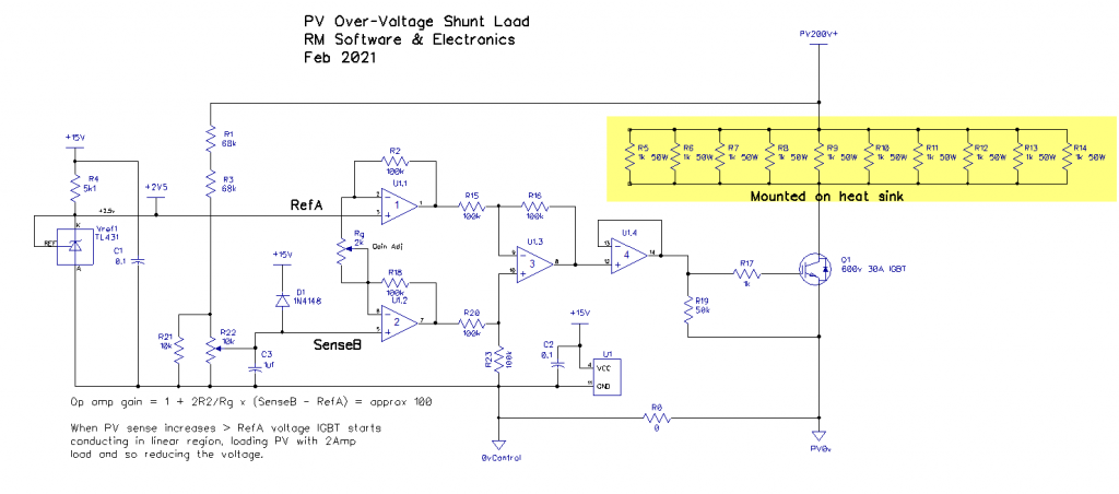

During testing of these controller designs on a common set of panels, these series strings can reach quite high voltages when unloaded, for instance I want to put up a 5s array where each panels unloaded voltage is 40v, but the mppt voltage is a lot lower 31.5V; this gives a working point of 155V which is ok, the controller can handle that. However during float or first connection the PV input voltage is around 200V, dangerously close to the input capacitor max ratings and the mosfets max voltage.
Rather than use higher voltage caps and higher spec'd mosfets (with higher on R) thought it may be simpler to place a device across the PV input that allowed a load be placed across the array when the voltage increased beyond a set value.
A voltage sensitive shunt load springs to mind, using an IGBT device running in linear mode, so the higher the voltage above a set point, the more it turns on, thus lowering the voltage. Couldn't find anything suitable on the net, so here's the result of a thought experiment.
IGBT devices are quite robust, their SOA curves have good operational area down to DC and they are cheap. The old style LM324 op amp can run single supply at quite high voltages, certainly high enough to drive the IGBT in its linear region. The PV voltage is compared to a 2.495 reference by a subtractor circuit, the difference multiplied by the gain of approx 100 is the linear drive.
I could use a bunch of 50W resistors or something like an old single bar heater as the load.
Has anyone ever built something like this...

Posted: 12:17am 17 Feb 2021
  wiseguy said
I assumed (wrongly?) that using the STGW30H60D which is a 60A device & that using it at 120th of its rating would probably be ok and it looked well within the SOA but that does not indicate true static data.
If you look up the safe operating area, there is NO dc safe operating line, which indicates the device is basically highly unstable in the linear condition.
The longest period it is rated to hold a single pulse of current is 1ms, and that might be something like 5 amps at 150v for one millisecond.
So its pretty useless in the linear region for any application.
Mosfets are much better, but still have their limits.
A good "big mutha mosfet" for higher voltages might be an FDA50N50. There are better ones, but not at the price of the FDA50N50. Its an absoluterly huge hunk of silicon with a power rating of 625 watts at 25 Celsius junction temperature.
https://www.onsemi.com/pub/Collateral/FDH50N50-D.PDF
Dc safe operating area about three amps at two hundred volts.
That does not sound like a lot, until you realise that is 600 watts !!
It would do it too, but it would require a refrigerated heatsink to keep the junction at 25 Celsius.  That is not realistic, the device will need to be derated for use with any practical heatsink.
But its stable, no hot spots or thermal runaway.
But you still need to derate it according the the thermal resistance of the heatsink, and that three amp safe area rating must be reduced at least half, if its not going to burn up on even a very large heatsink.
So really linear operation of anything is just not practical at higher voltages.
Best to hard switch one or more big resistors such as heating elements.

Excellent, thanks for the comments, looks like the linear mode is not going to work with IGBT's; even that "Big mutha Mosfet" which has a DC load line on the SOA graph is going to be touch and go with only a few amps, at these high voltages anyway.
Will have to think of some other way, that switches in multiple loads as required to keep the PV voltage from increasing too high, preferably not having a cpu in the mix.
Mike
Posted: 03:49am 17 Feb 2021
Its going to be difficult to stop it cycling if one big load is simply switched in and out.
It might require say three binary weighted loads that can switch in sequentially. That will probably still cycle the least significant bit, but that will be far less dramatic, and probably will not matter.

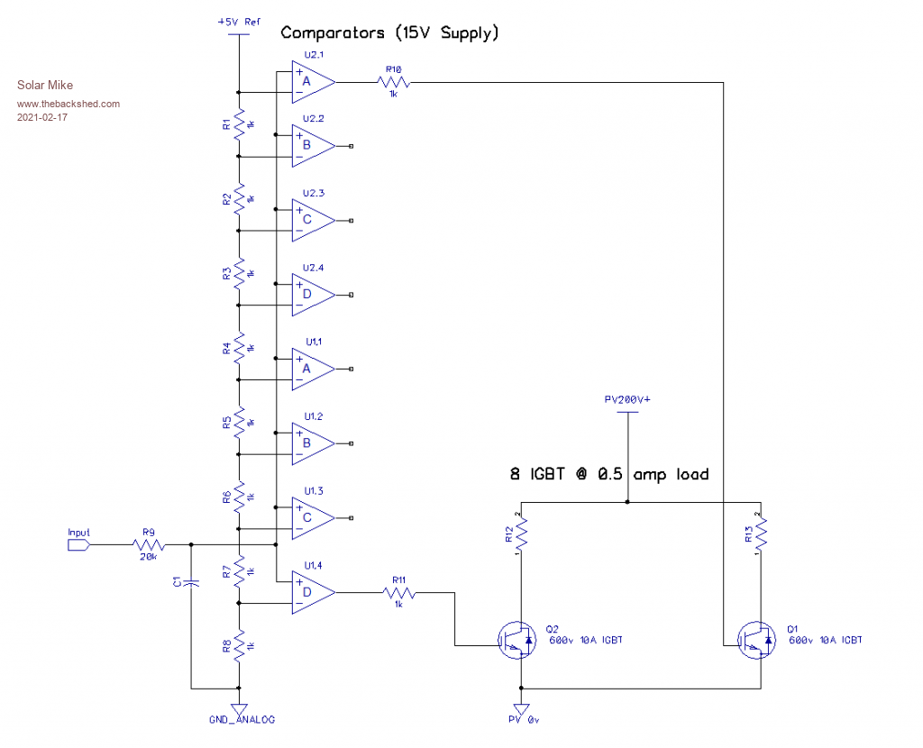

Use something like this, 8 comparators each connected to an IGBT\Load, connected in place of the IGBT in the original circuit.
Mike
Posted: 06:56am 17 Feb 2021
Yup.
That is basically what is inside an LM3914, but with a pair of discrete quad op amps, and a few 1k resistor packs, it should be able to work a whole lot better.
A bit of transient protection across the IGBTs might be a good idea.
Edited 2021-02-18 10:40 by Warpspeed
