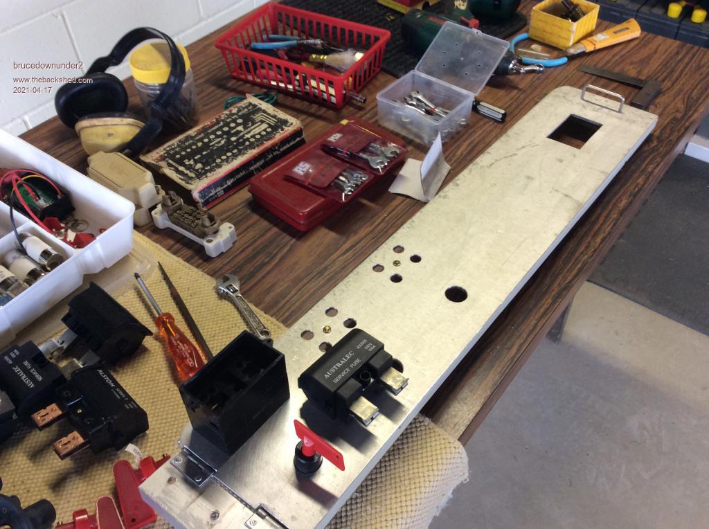

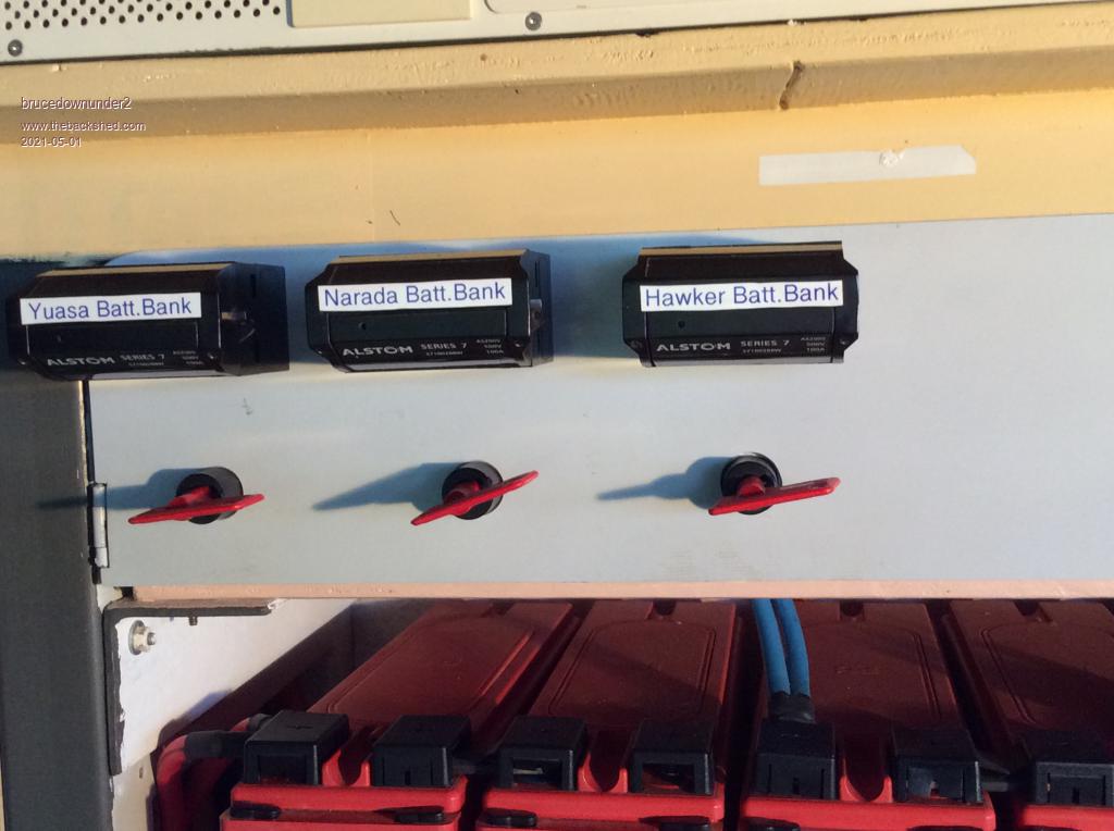

 I'm building a new panel for switching three battery banks ,individually or ganged.
The switches are those cheap battery switches on e bay ,OK if you always remember to lighten the load if they are "ON" and you decide to turn them "OFF"., although I've not "welded" any contacts up in 20 years, so I must be doing something right.?
I use the 100 Amp domestic house entry fuse holders and the cartridge type fuses-have blown one of those ,was late in the afternoon and I was tired, you learn fairly quickly after the event !!. nothing damaged.
The battery cables are 50mm ,so what I do is divide the conductors,heatshrink them into two bundles and they go nicely into the connection brass block, there being two entry ports. Also makes the cable ,if you make the tails ,say 20mm long , fairly flexible for when I open and close the panel , as it's mounted on hinges for me to open and get behind it for all the cables.

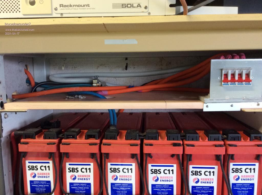

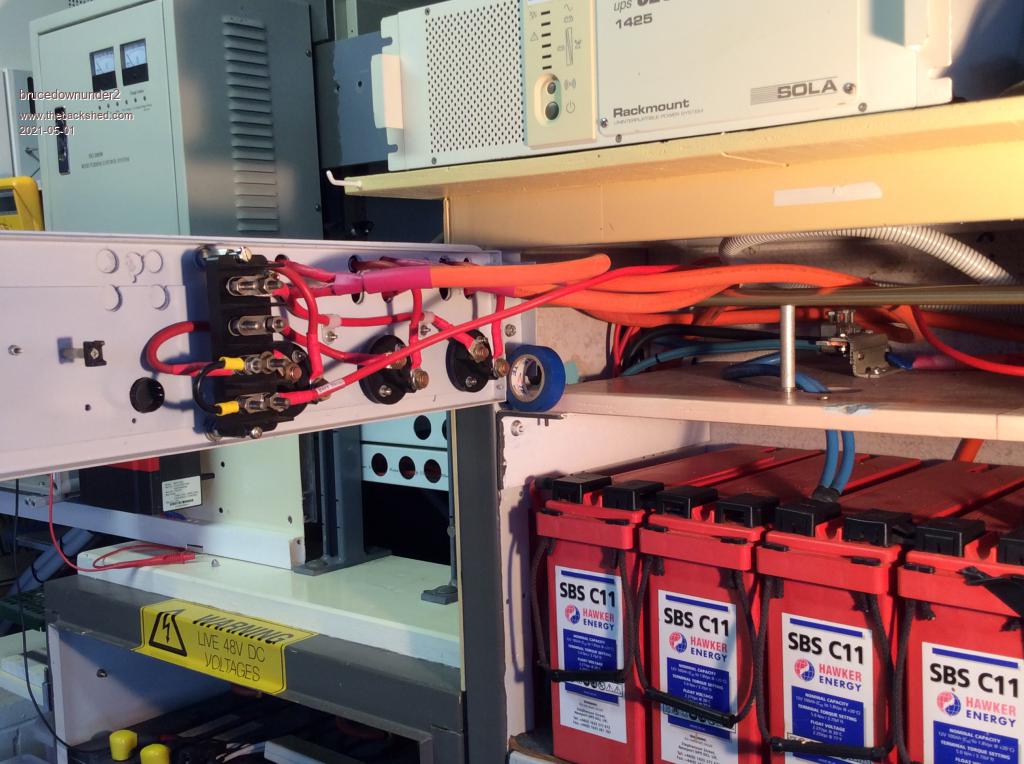

brucedownunder2
Joined: 14/09/2005
Posts: 1548
Posted: 11:56pm 30 Apr 2021
Thanks Mike.
I'm sort of in a similar construction stage with mine..
In the Photo , I have not installed the controller rotary switch ,so at present, the three master switches are on a common bar connected to my MPPT controller . The other two controllers are disconnected. I can still use any of the three battery banks .
I have drilled the position for a spare battery bank in future.
Common buss ,seperate master switches,flexability.
I'm sort of comfortable with the rotary type switches ,,,as, in my thoughts , we  are mostly switching a light controller load (for it's functions).
The caution needs to be considered for the Solar output power through the controller to the batteries.
So, I will ,as I do normally, turn down the Solar power first, then switch the rotary to the next controller.
Hope you get my drift ? (I'll have three controller ,s  an MPPT 60 Amp,on a dedicated array ,  then a CM 40Amp on 1Kw of tracker array  and a CM60 amp as a back-up spare. All my equipment is 48 volt.
Bruce
