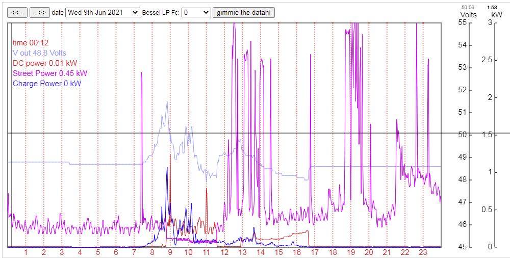

Wednesday brought a sh!t-load of rain and the battery/charge situation is below:
Brown is inverter power
Dark Blue is solar charge power
Light Blue is battery voltage
Purple is street power.
We can see that my wife was hammering things from 12pm onwards.
Total charge for Wednesday was 1.18kW.hr and probably the lowest on record for me.
Inverter energy was 1.53 kW.hr
Battery at 12am was 48.6V
But we had street power..
