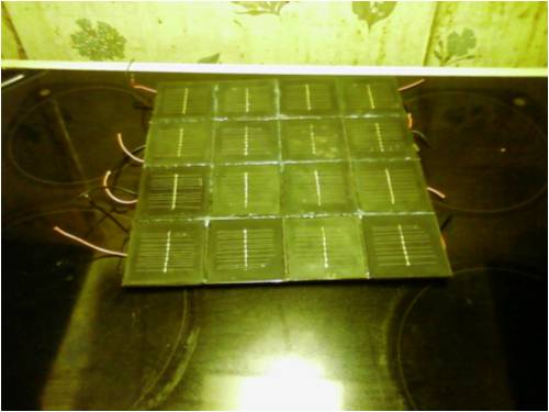

Here are a few of the pics I promised. The first shows the collector part of the cells all glued and stuck together. I am not sure how the hot glue will work, but there are many many options for this iin the future if needed.

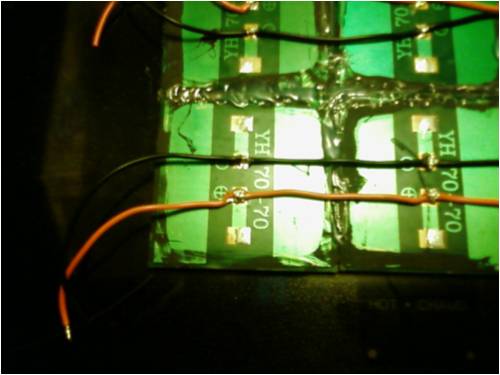

This one is of the back side and you can kind of see how the wiring was done. Looking thru posts it looks as if I am connecting the cells wrong so I will have to try a different arrangement tomorrow. I designed it to be easy to switch if need be. I am running 4 cells in parrallel and connecting each of those groups in series. Looks as if I should do it the other way around from what I have been reading on the forums.

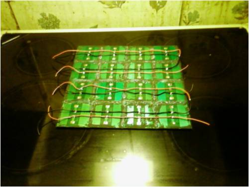

The last one is just a close-up of one of the cells I used in this arrangement. I had 17 of these that were identical and as such this is why this panel is no bigger then this so far.

You should be able to get much more current than 90mA I think. The cell I tested yielded 60mA in a short, so should yield about 50mA in normal operating conditions. Putting four of my cells in parallel should yield about 200mA. Your cells look exactly the same as mine.
You may have a few weak cells in there that lower the performance of your entire panel. Especially in PV panels goes that 'a chain is only as strong as its weakest link'. You should test the cells individually for output and select the best ones. That is what Gordon was trying to tell you.

well, I will have to check each cell individually then. when I check them I am using a dmm I can just place the meter in the mA scale and check pos to neg right? no load needed? Should I wire the cells in series then join the groups parallel? I guess that I could just have it wired wrong.

  Quote  when I check them I am using a dmm I can just place the meter in the mA scale and check pos to neg right?
Correct.
  Quote  no load needed?
In this case your DMM is the load. You don't need any other load for this test.
  Quote   Should I wire the cells in series then join the groups parallel?
You should number all cells from 1-16. Then, for each cell individually(!) (this means you'll have to remove your current wiring), measure short-circuit current. Write it down for each cell.
Let's assume this is the result: 70-65-60-55-50-45-40-35-30-25-etc. mA
Then, start grouping cells in batches based on quality ('selecting'): the 4 cells with the highest current will have to become one series string. In the above example, wire the 70mA cell, the 65, 60 and 55 mA ones in series. This will become one chain. Current in this chain will be limited to 55mA by the lowest-grade cell.
Do the same again with the left-over cells: again select the 4 that have the highest current, in this case, the 50-45-40-35 mA cells. This will be your next chain, limited to a current of 35mA. (in this example).
Etc.etc., till you don't have any cells left.
By then you have 4 chains (each chain consisting of 4 cells); parallel those chains.
Following this procedure will yield the maximum possible output of your cells.
However, if it turns out that there's very little variation in your cells (unlike the example above) and all yield about the same current, then I'd simply rewire it back into its present configuration. No need to go through all the special wiring for just a few mA gain, in that case.
