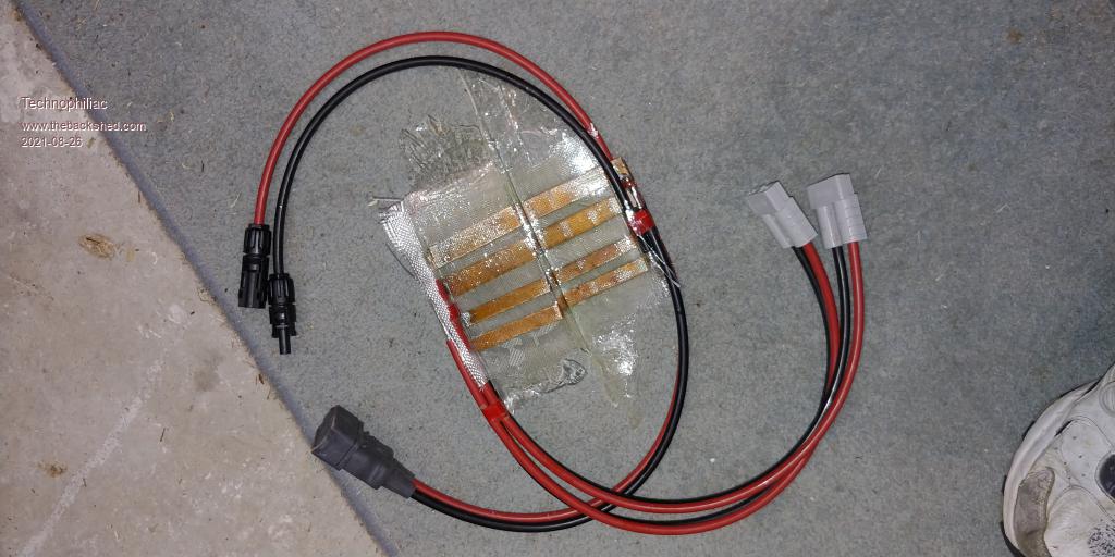

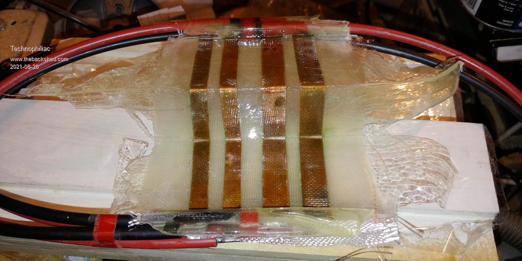

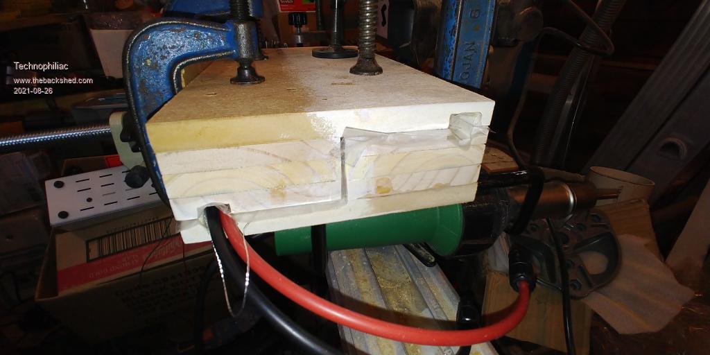

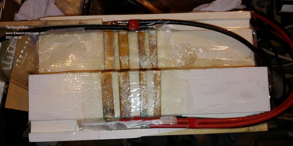

In appreciation of the contributions to this I put up some work in progress images as proof of concept. Need to / yet to do a finishing layer of glass and cloth to encapsulate the copper - cable joins and seal them up.

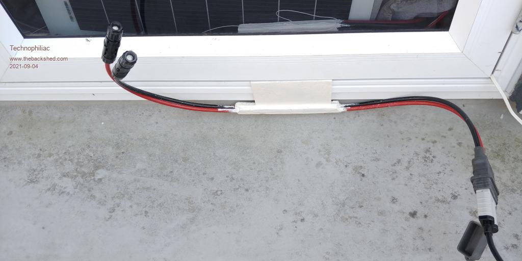

Posted: 09:19am 04 Sep 2021
Painted as suggested and installed into a low traffic area on a private balcony:
