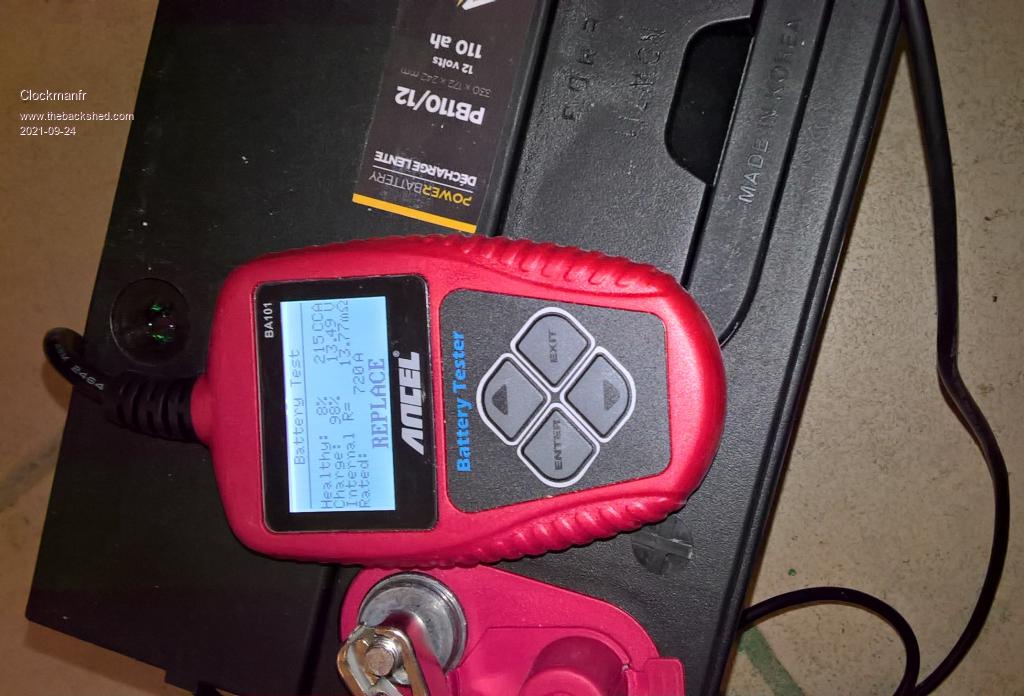

Had some new batteries arrive from a retailer here in France, never used this firm before, but a charge and a test revealed a bad ah rate, and not as per specs.  Sent it back with pics of my meter readings and got my money back. Wont use them again and warned others around me.

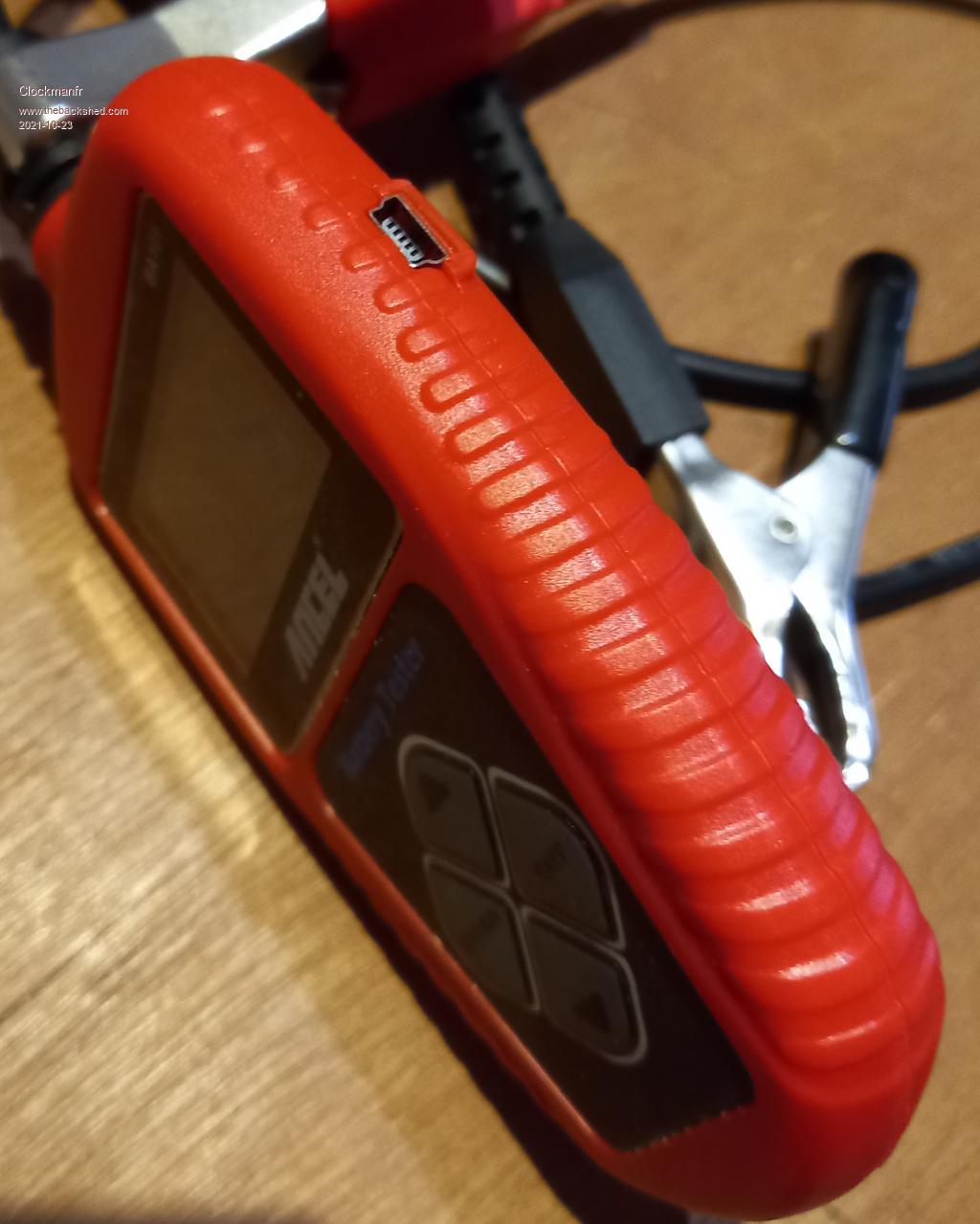

Photos show faulty New battery and the meter at work, it also has a data output link, but i have enough paper work as it is.

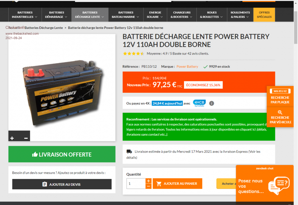

And this was what i paid for, i know these, but the battery in the above photo that i received was an India recycled sort of copy.

I have not deeply examined the ANCEL, but it is data linked and if i recall 'Frackers' connects his to a PC/laptop, so maybe its in there. Sorry never really got that deep.

the "ancel bst200 car battery load tester" i have doe NOT have any usb jacks on it
I have not opened it to look inside if it can be "modded" but im not interested in modding it. i only want it to measure internal resistance of batts

rgormely.
Heres a pic of mine with the jack and it came with a cable to USB end.

OOPS...
my bad mine is a BST100  (i said it was a BST200 in the above thread)
sorry
yes the BST200 has a usb
the BST100 does not
