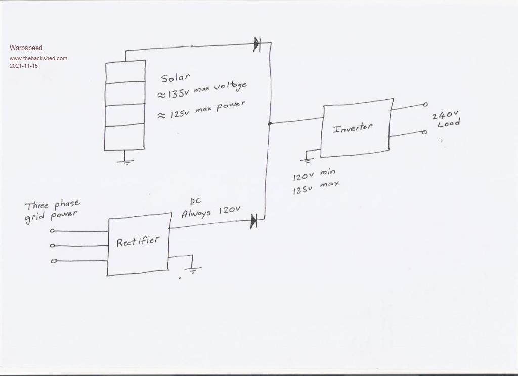

Posted: 09:49am 14 Nov 2021
What I ran successfully for a very long time was a three phase dc rectifier that powered my inverter directly, along with some solar panels.
Any surge currents always came from the rectifier, for example starting up my refrigerator. At night the rectifier provided all of the power.
During daylight hours there was almost always enough solar to carry all of the load, but on dismal days, any shortfall came from the grid.
No battery is required, and that is a major cost saving. In mid summer solar provided about 80% of the power, effectively dawn to dusk, extra panels would not have improved that.
In winter solar provided about 55% which helped a lot with my electricity bills. More panels probably would not have helped all that much. When there is effectively zero solar, if I doubled up on panels, twice nothing is still nothing.
The system slips smoothly from grid to solar and back again at dusk/dawn, and its all done with just a couple of diodes.
No power can ever get back onto the grid, so even with a smart meter you are set to go.
The inverter just draws power from the highest source voltage, its as simple as that.
No solar controller required.  The inverter has to be able to operate from a very wide input voltage range though, and that might be a problem with many common commercial inverters.
But if you can match solar panel voltages to inverter input voltage, and find a big battery charger, that would be the way to do it.
I believe you have three phase, so a suitably sized three phase fork lift battery charger would be the thing to look for.  Provided all your voltages are compatible its the simplest and most economical way to stealthily reduce grid power, without going full blown grid tie.
