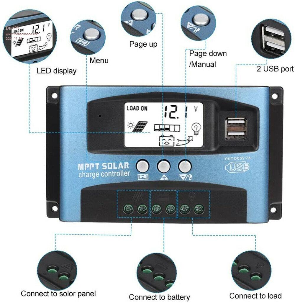

My other thread on cheap controllers progressed into much more interesting and beneficial information so I thought I'd start again with what I have learned, or think I have, with the original question as a guide that may help others.
I have a cheap PWM controller I bought some years back that had the advantage over many others I have bought since of having the voltage parameters USER settable and adjustable. Many do not and have settings that IMHO are too high for float voltage which boiled the batteries and too low in the bottom end cut off which is also not good. For my use the High flat voltages which do literaly boil the things with enough panel on them is the worst problem. They are crappy things to use though and the readouts are garbage.
After much time on the net, I think I have figured the difference between the better adjustable controllers and the ones that are basically battery destroyers.
This is the controller I have and love.  Works perfect, easy and logical to use, been 120% Happy with it.

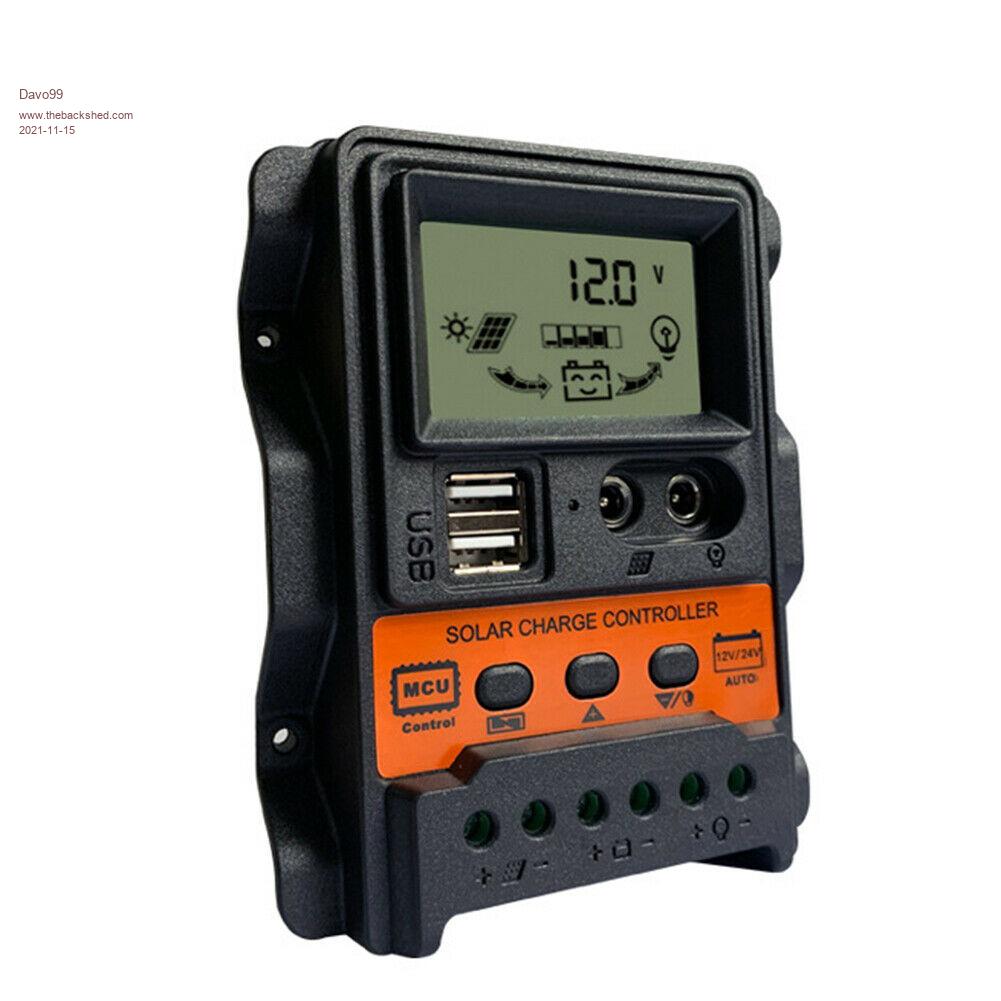

Here is the "run for your life" type.

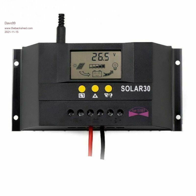

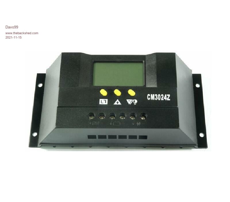

Here is a similar but what I believe good and decent type:
Now if you go back to the first pic of the good one I have and this one, You'll notice something... what I call the battery happy face on the LCD Display.

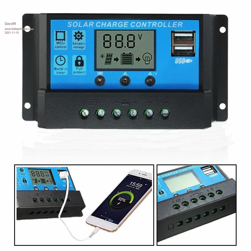

The other one with the battery that doesn't smile ( How Rudeness!) is the "Boil or starve your battery to death" type and the one with the smiling battery seems to indicate the look on your own dial when you have one of these worthwhile types.
Would be hard to come up with a graphic to illustrate the Look of frustration and annoyance I have had trying to do any settings with these other POS types that flat our more times than not just don't work properly at all.
In all of the smily face types I looked at, and there were other designs of casing, They all if one delves into the Chinglish destructions, reference to the voltages for float and cut-off being " User adjustable" which is exactly what is needed.

The advantage of the "Blue" appearance models seems to be they are being sold cheaper, sometimes substantially, than the black cased models.... for whatever reason but again I am pretty sure they are all the same controller being the happy or not so happy face Type just thrown into different casings. The other thing is I found sellers with much better feedback flogging the blue ones than some of the others but do your homework before you click the Buy button.

The issue is that I have been using the type shown in the 3rd image at the top of the thread for 2-3 years and wondered why they never seemed to come off 14.4V for sealed lead-acid.
I think that explains why a fairly new deep-cycle battery in the caravan went "south" ;(
