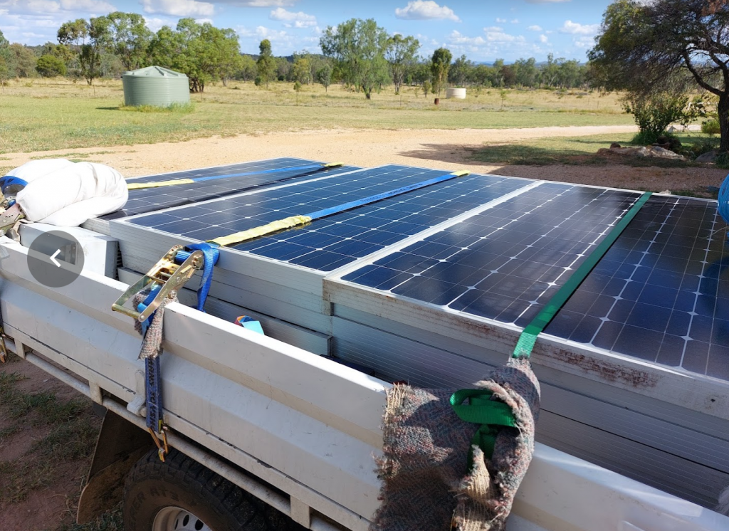

Some cabbage was too lazy to take these to the tip. Wouldn't even take money for them. What a steal.
I'm told the GTI works so I'll give the homemade inverter a go so I can backfeed and avoid buying a charger.
I was pretty gung-ho about the MPP unit, but when I read the manual I don't really like how the powe path topology is set up. From my understanding it powers the inverter directly off the solar and if the solar does not meet the load it will transfer to battery or grid. Some of my gear is sensitive to small power losses, even from an interactive UPS transfer.
Also doesn't seem like you can use the inverter and charger at the same time. At night I would like to run off the inverter with the grid keeping my batteries from being too deeply discharged.

  ryanm said  Some cabbage was too lazy to take these to the tip. Wouldn't even take money for them. What a steal.
Yes .They can't be legally used on GRID systems any more . Its Off grid use only so if and when buying its good to know . Same with the inverter

Yeah, from the little I know about it in Australia the CEC or who ever makes the solar regs is pretty much government sponsored organised crime.

  ryanm said  Yeah, from the little I know about it in Australia the CEC or who ever makes the solar regs is pretty much government sponsored organized crime.
I gotta get a ute like that I can put panels 3 along in! Mine I can only get a single stack in but I do pile them 35 High!   :0)
