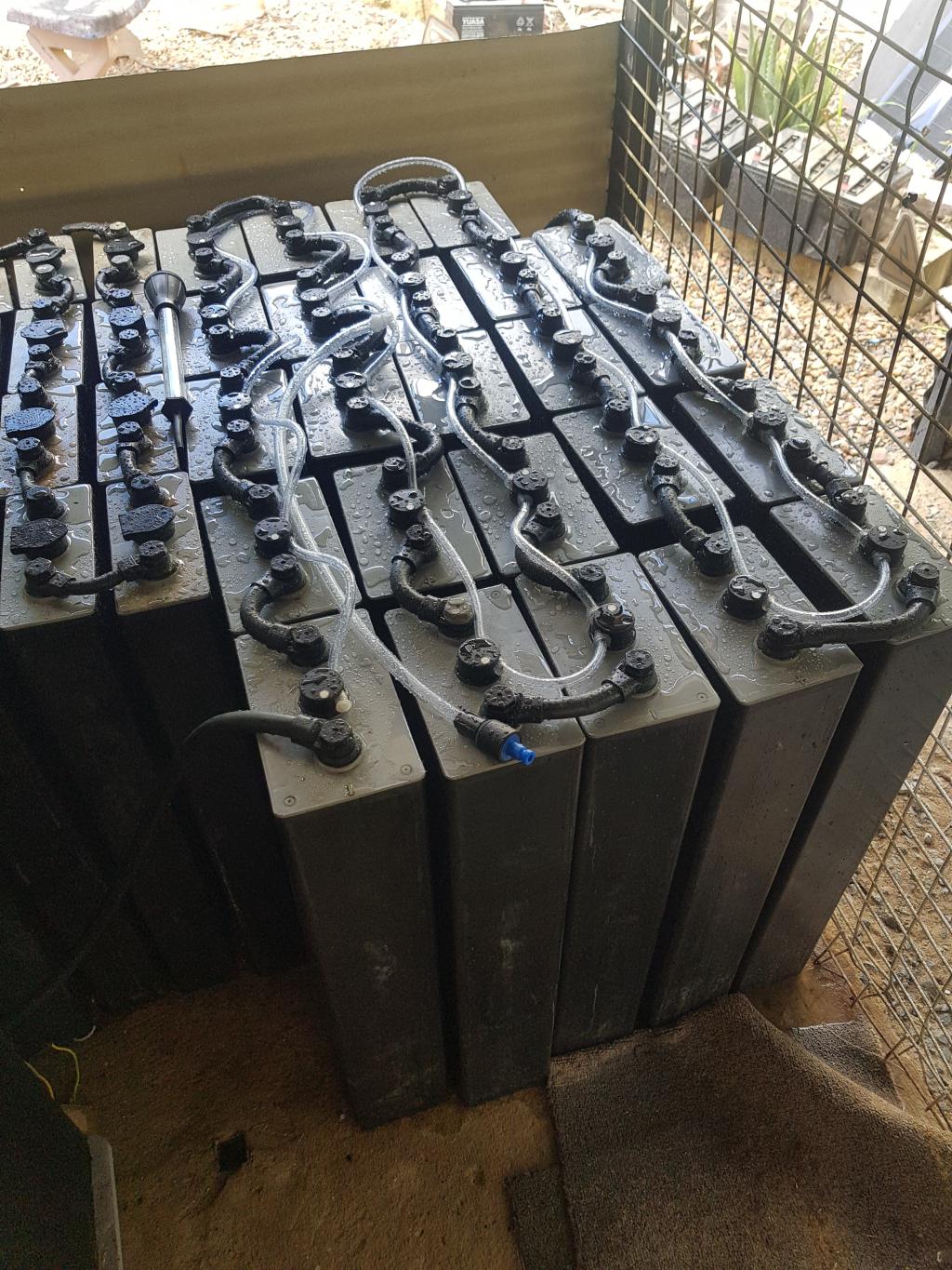

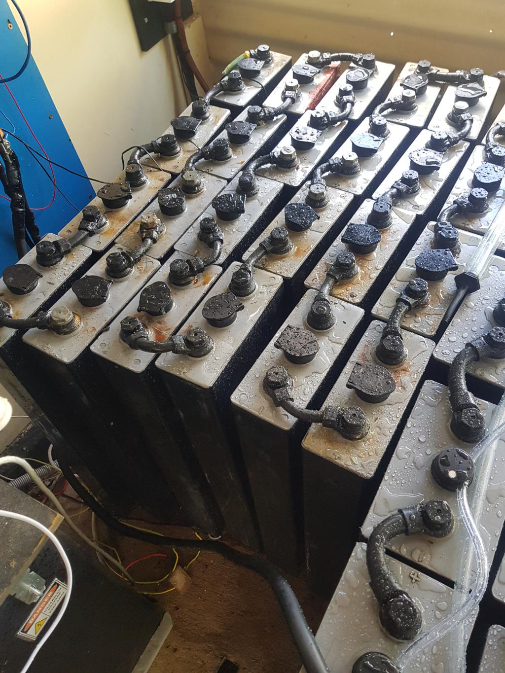

purchased them through CEIL in Sydney, the first bank was about 3.5 years ( 680ah) ago( closest to wall, smaller one) and the second a few weeks ago ( 900ah ) total 1580ah.. I use MINIMUM 30% out of them every night ( obviously not that much now as I have 2nd battery) and have been extremely happy with them. As we have family coming to live with us soon on our property, I figured I'll get ready for that by increasing my storage. I used to have 550ah of agm's in series with the first one for some time but have now retired them as I was never happy with em, they were ex railway of unknown age or usage that I got for scrape price, and quite a few were sad to start with... but they still did there job...
these are rated at the 5hr rate at 80% discharge, when new are warrantied for 5 years, being 2nd hand they only came with a year warranty. being 5hr rated, solar is incredibly easy on them, so taking peukert's law into consideration I would have AT LEAST their rated capacity. Total price including shipping to my door for both was 10 grand.

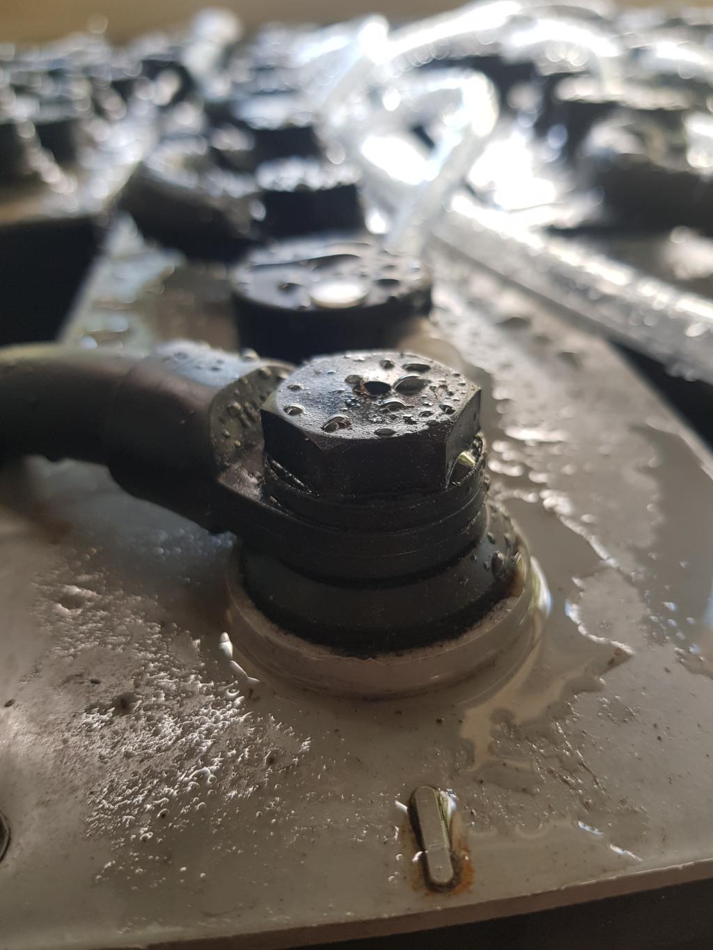

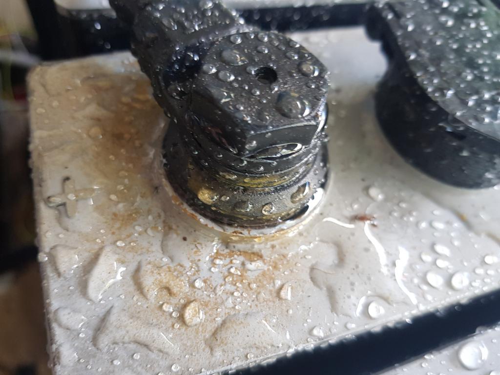

once a year I use a battery terminal protector spray on each terminal, I used to use the proper " battery terminal protector " from CRC, but since I've found silicone spray to be effective, I disconnect that bank from the system via individual breaker, the systematically remove each hold down bolt with rattle gun, check / clean if needed / spray.. usually taking about an hour to complete. as you can see in the pics these have a " seal " around each terminal which dramatically reduces corrosion and is very effective.. to date I've had NO issues with corrosion, and found minimal when servicing..

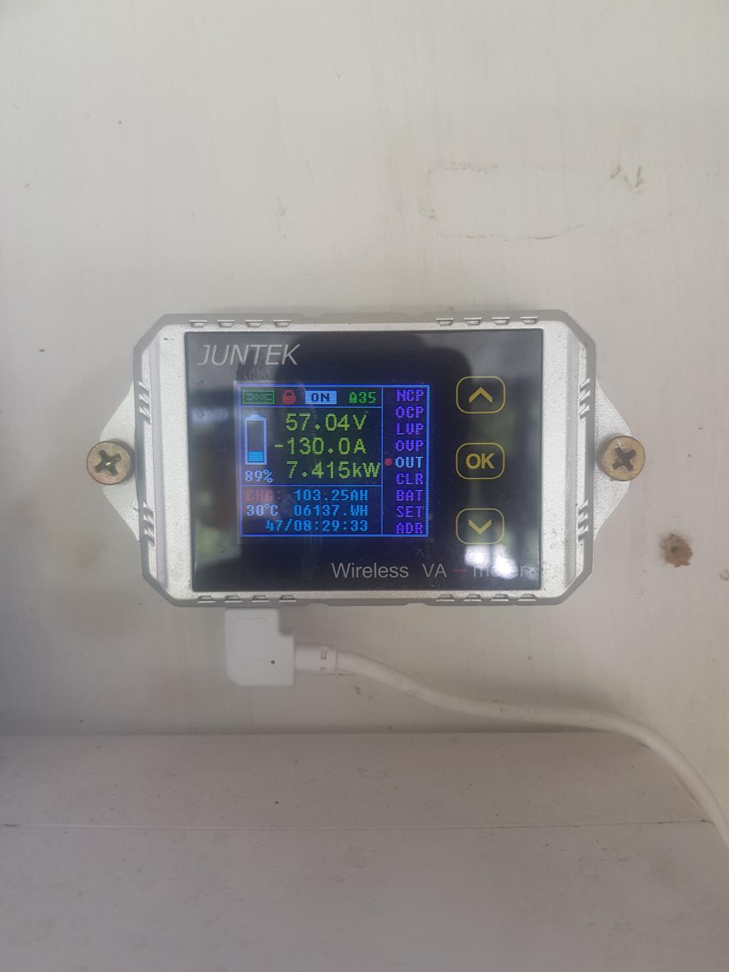

Regularly cycling the way I do seems to improve both under heavy load voltage and " in the morning " voltage.. but obviously this plateaus and will eventually drop off as the battery ages.. here is the monitor I use, its a " juntek " cheapy from aliexpress but its very handy, seems reasonably accurate and  also has a wireless connection that uses the nrf24l01 board, so I replaced one, with one that has the on board amplifier to dramatically increase its wireless range ..

Is that an Auto watering system on them?
If so, could you explain a bit how that is setup and operates Please?

to be truly honest,  i haven't used it yet dave... but by what i can tell, there is a 1 way valve on the end (the blue thing) and a float valve under each cap so its a matter of forcing some water in and once full it shuts the water off... seen my bother in law do it on his system.. he used a 2 litre bottle and a standard hose fitting.. when I can Ill use it and let you know asap...

If they are just float valves on the watering system that sounds very simple and straightforward. I am told they are expensive to buy though.

the 2nd battery came with it... but a quick search on fleabay turns up about 300 bucks for em.. if you really want em, talk to your battery supplier if they come with it...

oh and honestly,  its a pretty small job, so even my first bank that doesn't have it, its not that big a deal... but each to their own..
