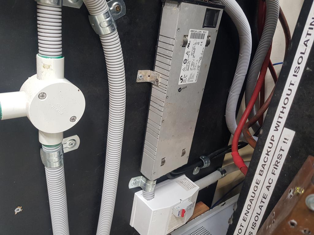

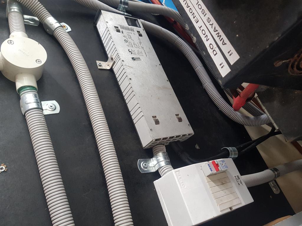

connect up a 230v alternator to your diesel
have a look at eltec flatpack2 2kw 48v power supplies
hear are sum that are on flebay at the moment
https://www.ebay.com.au/itm/334310254250?hash=item4dd671a6aa:g:ouYAAOSwq1xh9jaX&frcectupt=true
Im offgrid , 48v battery bank and solar panels for primary power and 230v diesel generator for backup
I have a flatpack2 to yous as part of my black start emergency kit
1 get the diesel generator running , house now has power
2 connect up flatpack to battery and 230v
3 charg up battery to the point that i can start up the soler inverter
4 system back to normal

dave, i have several of those 48v flatpacks mentioned earlier... if you want 1 or 2 just give me a heads up and I'll send em to you.. I already set them up to put out 57v etc, they rated at 2kw each and I can confirm that .. they 98% efficient.. Ill pm you with a pic of my setup, they do need some simple mounting...
also, a cheap dc welder works too, not as efficient as the flatpacks but very effective ... you just need to add a turn or 2 to the main transformer and you have a current controlled battery charger... have one of them too...

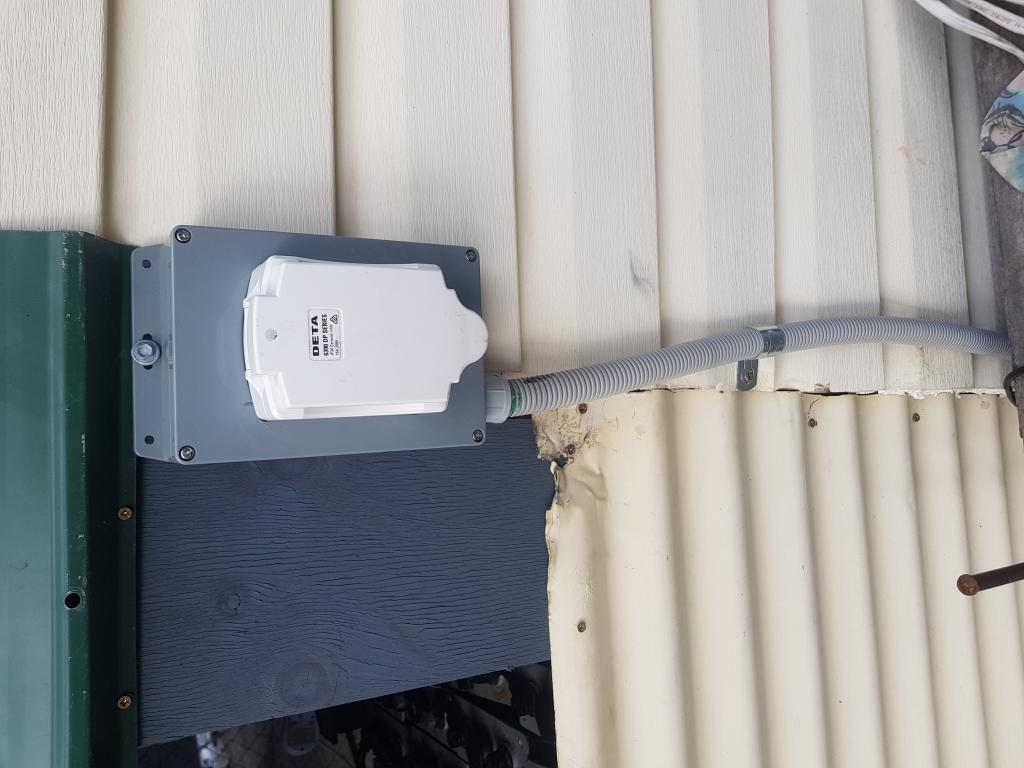

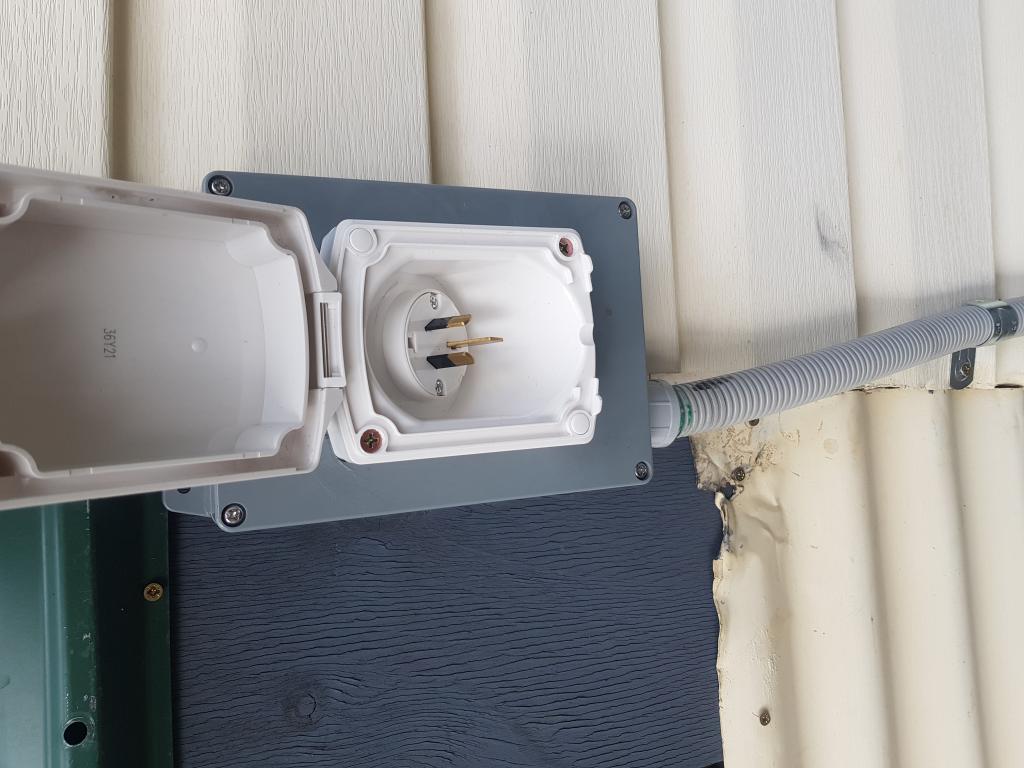

Posted: 10:27pm 17 Feb 2022
this is the setup I use, got a standard " caravan " input plug from bunnings, and mounted it to wall with a breaker etc... works great...
this is one of the welders I was talking about, just replace the electrode clamps with heavy alligator clips..and add the extra turns on main transformer if needed...
https://www.ebay.com.au/itm/ARC-220Amp-Stick-Welder-DC-Inverter-MMA-Welding-Machine-IGBT-Portable-10A-Plug-/272834881672?mkcid=16&mkevt=1&_trksid=p2349624.m46890.l49286&mkrid=705-154756-20017-0
I think it works !!
