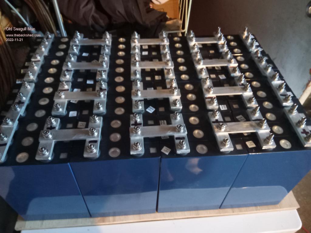

Posted: 03:11pm 20 Nov 2022
I got a bit more done, both battery's are now assembled and in the testing phase.
So I now have two 210Ah 48v batterys, and will be removing the forklift batterys.
thanks to all for the help.
Revlac
Joined: 31/12/2016
Posts: 1310
Posted: 02:04am 21 Nov 2022
Terminals look good and tidy
What do you have in mind for a BMS and active balancer?
Cheers Aaron

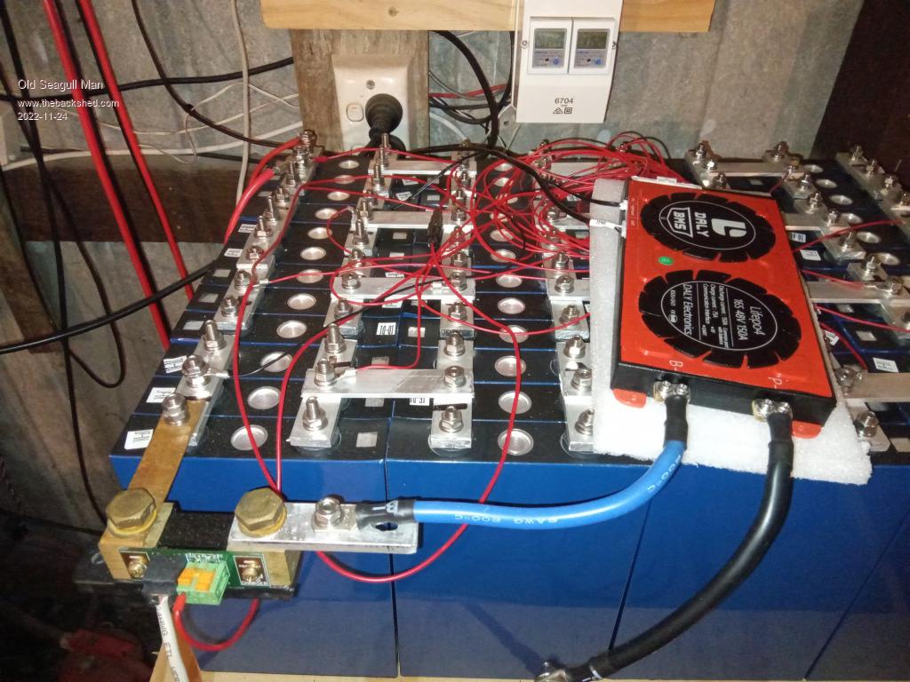

Off The Grid
Old Seagull Man
Joined: 21/12/2019
Posts: 55
Posted: 01:39pm 24 Nov 2022
A bit later on in the process, Battery one is being tested.
Daly 150 Amp BMS. just sitting on some foam, from the battery boxes.
with a Victron BMV 702 in circuit, to monitor the charge and discharges.
I also have a self build monitoring system, that read data from  the VE Direct port on the 702  meter that plotts results.
At he moment this battery and its brother or sister, are still testing, so they will not remain like this when they are put into service. I want to run at least 100 cycles on them before they go in the electrical cabinet. The proper looms, are almost complete
as the two BMSs will be mounter on a frame away from the batteries.
Im not runing active balancing at the moment, im finding the cells are within 10mv when charged most days, so the passive balance in the Daly has not turned on yet.
Revlac
Joined: 31/12/2016
Posts: 1310
Posted: 10:31pm 24 Nov 2022
Setup should work well, I had wires everywhere looked like spaghetti, eventually I had some of them running under the bus bars and bundled some wires with zip ties, some balance wire had to be extended.
Thats the same (150Amp Daly) BMS that I have in the shed, see if it gets back to 100%SOC, I may have different setting.
Cheers Aaron
