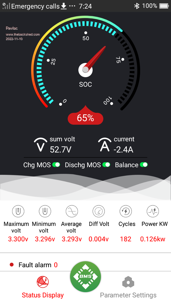

I have had this battery setup (48v 200AH Lifpeo4 battery) running for a while now and is running ok, This is a Daly BMS and the cycles read 182 This screenshot was taken a few weeks back a so the cycle count should be more, also the BMS often only shows/updates the count after it has gone into sleep mode after not being in use, one of the quirks of this brand of BMS.
It has been running for roughly 600 days give or take a few (whatever the start date was might have stuffed that up) the average overnight battery consumption is 35 percent.
BMS is most likely at 190 or more cycle counts by now.
Question is, Do any other BMS calculate every cycle as 1 cycle or do the calculate all small cycles until it counts 100 percent and then calls it 1 cycle?

Posted: 10:25pm 10 Nov 2022
The ones i have played with just have a empty soc and full soc cycle threshold.
so a cycle is only counted if you exceed both thresholds.
Battery age can be better estimated by counting total battery what hours
