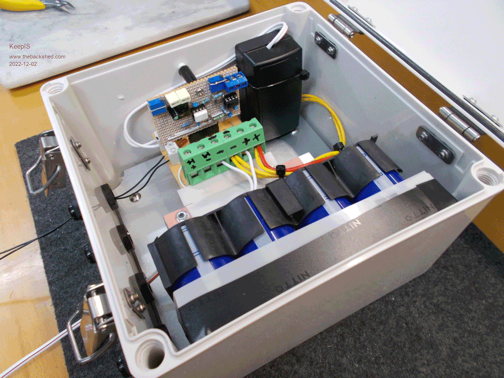

A bit of background: I have been building an emergency solar backup system after someone gifted me two old Solar systems. Both about 1.5kw each and around 10 years old. That led me down another rabbit hole and finally I have a system running better than I had initially thought possible, especially for the price.
Mostly I used the lowest cost Solar regulators (3 X 60A) and  5kw 10kw peak inverter (which really does 10kw) in a 24v system. However I didn’t make the mistake of skimping on the Battery quality and I added another 3kw of quality new 400w panels along the way, prices were really low when I got those. The 12 year 2.8kw old grid feed system is left as is as the feed in tariff is still high, when they pull that, I have a new combined inverter / battery charger and battery to run that separately plus a few panels to add to it.
FYI I can instantly start a huge very old 2.5 HP compressor that draws 455 Amperes on initial start up, a heavy duty Bandsaw @ 374A surge and that’s with everything else running, big fridge freezer, Aircon, lights, washing machine, computers, big ventilation fans etc, like I said, exceeded my expectations. I coded and built a solar data unit giving full real time graphing with history, it has a 9” touch screen so easy to read, running an ARM H7 Micro, complete system has not skipped a beat while running for the past 10 months.
Now onto the Hotwater system.
This was built into a nice Weather proof housing,and designed to be easy to service and experiment/modify, to this end I made a base board (mother board) that holds the SSR IGBT's and the high voltage parts and connections, a daughter board simply plugs in and can be removed with just one screw. The neat thing about this is that it can be run on the test bench and adjusted without disturbing the controller installation.

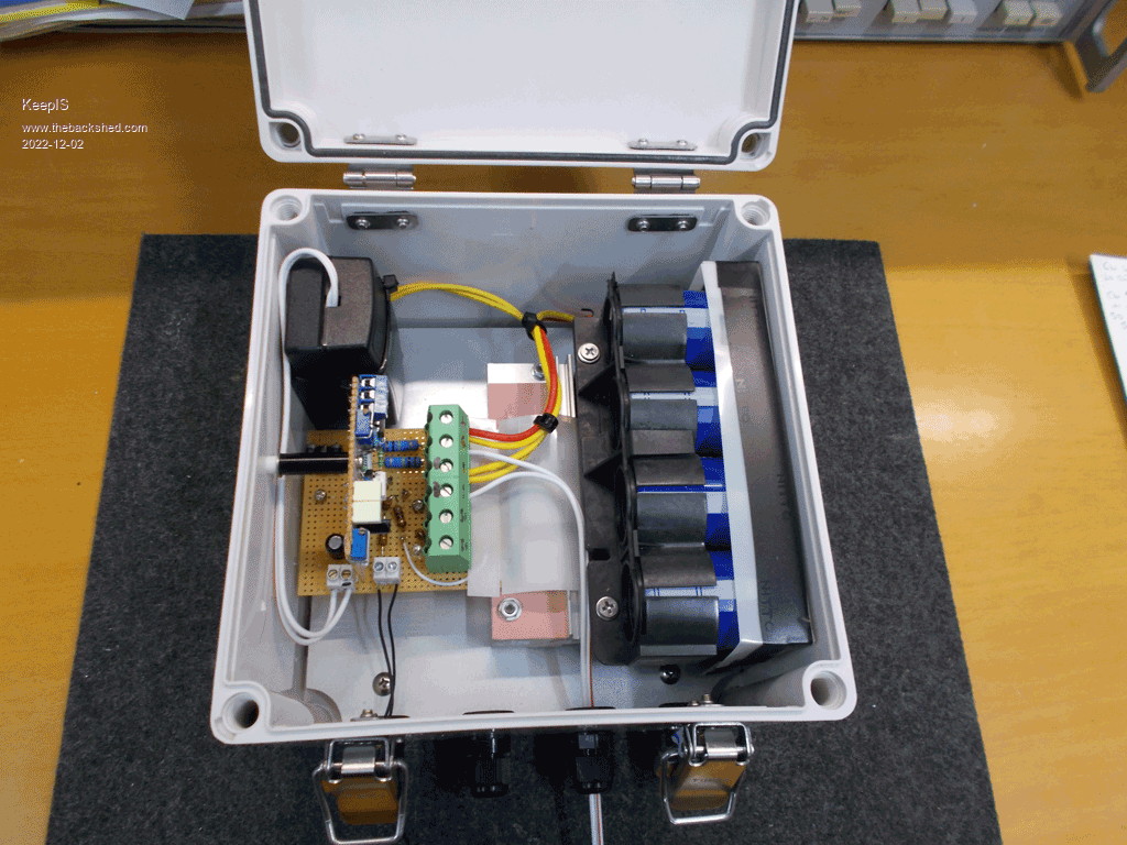

Some info on the solar and HWS.
I have a small 50Ltr 2.4kw HWS as an emergency backup. Now I know that’s a small unit, but I hooked it up direct to solar 4 days ago and it ran for almost those 4 days as the only source of hot water until the 24 hours of drizzle and total cloud cover hit. Only two of us, hot showers and dish washing no problem and then ready for the next night. Just the thing I need to do real world tests.
I can easily heat that from cold to thermostat switch off on my (240vac) Solar backup system in a around 2 hour or less, same as if it was on mains. However I have 6 old panels left and decided to see what it would take to heat that small HWS up to full temperature. The 6 panels should have a VOC of 267v but I can only get to around 235 (they are yellowing). The power rating new was 185w x 6, or around 1kw, Vload new was 37.0v @ 5.1A.
So I direct fed the HWS with the panels, on a good day I could heat the system to thermostat off in around 4 hours from cold, I really did not think that would be possible. On a bad day – gets hot, but not quite thermostat switch off, on a bad day not good obviously.  Over the past week, the most I’ve seen was 125v @ 5.4A = 675 Watts (fleetingly) into (27 ohm DC resistance) 2400 watt Heater element, most of the time in good sun it sits around 100v to 120v @ 3.5A to 5A.
I found the great work by Warpspeed when I remembered the Solar forum here. I just finished building a HWS controller based on his design.
The Capacitors run slightly warm, so they are working, the SSR I made with 3 x IGBTs salvaged, like almost everything else, from a few 10 year old inverters, the IGBTs are rated at 600v @ 30A at 150 deg, and very low On resistance with 3 in parallel of  0.002 ohms, so 600v @ 90A for 3, needless to say it runs almost cold, no fan, and it’s inside a sealed box, it’s just a solid lump of square aluminum heat sink about 50 x 50 x 150mm long.

I came up with a simple low cost way to get voltages from 60 to 300 volts DC on the work bench in a relatively safe isolated mode for initially setting up the switch points and fault finding. So having just finished getting this going and installed, I thought I would share my results and a few things to watch out for with setting up and building this type of HWS controller.
I added a Thermostat connection and have used the existing thermostat successfully, well, once I solved a strange issue that could have overheated the IGBT or MOSFET solid state relay (SSR)
Today has been overcast with a few brief patches of sun, the NEON was pulsing at around once a second for most of the day, with the glimpse of sun it flashed at around 4 times a second. I had it installed and switched it on at around 9.30, by 4pm it was too hot to hold onto the water outlet or pressure release.
No the thermostat did not reach turn off temp but you could not stand under the shower without cold water mixing, and I also have a mixing valve installed on the HWS. So not bad for such a lousy day and a small old solar panel setup. The Neon never stayed on – nor could it – I have the low cut-off set at 130v  and the High cut-off at 210V, this small solar feed can NOT supply 210v with the HWS load.
The point is,  the DC current clamp meter was showing almost 7A at times, but of course at a low duty cycle (switching time) Tomorrow I will put the Digital scope on it and see what the real power is compared to direct feed, should be interesting.

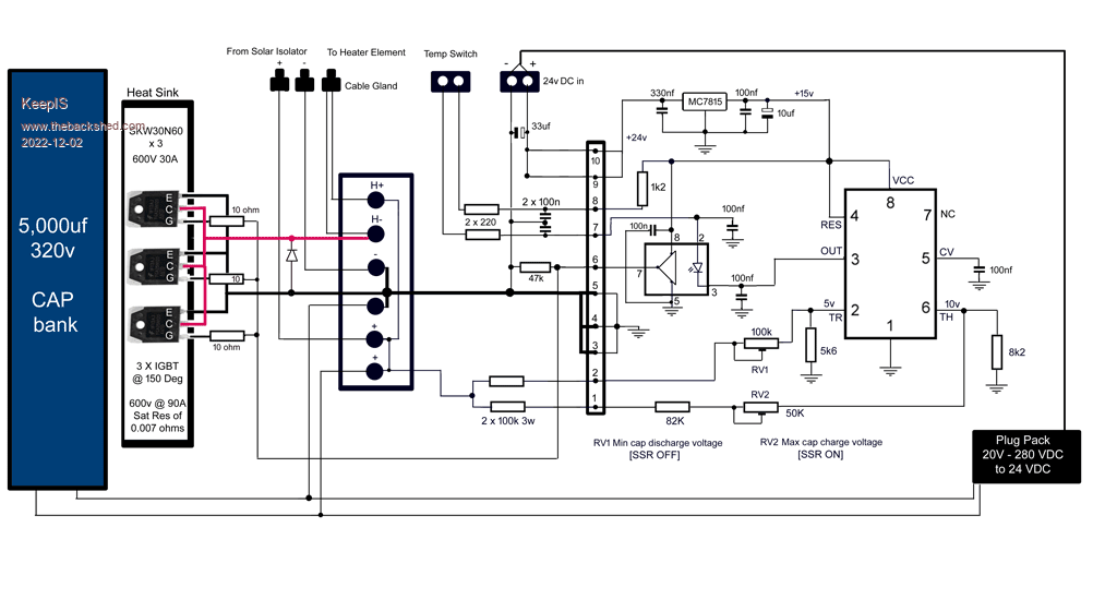

This is the circuit, the left side of the 10 pin connector is the base board, the right side is the daughter board. Note that I used a standard 240vac plug pack as I wanted 15v for the control voltage. Most device are rated at 15v gate voltage when the quoted on resistance and current limits are specified, I wanted to eliminate anything that could cause the SSR to run hot like, slow switching transition, noise or slightly low saturation voltage could cause some of these problems.
I found a condition where the 555 would oscillate and could possibly cause an overheat condition for the SSR. More on this later and a noise problem when using the HWS Thermostat, both simple fixes with a few bypass caps / filtering.

The Thermostat connection.
I made sure that the thermostat switch could be, and was, completely isolated from Hot water system earth Heating element and supply.
The controller was built before any decision had been made for the Thermostat connection into the circuit, I did however include a connector for the thermostat and two 220 ohm resistors in series with each lead from the thermostat connector and 2 allocated pins on the base board 10 pin socket.
Once I confirmed that my controller actually worked, I decided to try a quick mod to make the thermostat switch simply interrupt the 15v DC connection via the 1.2k resistor feeding the Optocoupler Diode.
When I tested it, the SSR Heatsink now started to get quite warm and the 15v regulator was getting hot, I also noticed the NEON was dimly glowing instead of turning completely off, this could only happen if the 3 IGBT devices that make up the SSR were in partial conduction.
I guessed that the on/off pulses from the heater element were inducing noise spikes into the Thermostat wiring. I added a 100nf cap to each 220 ohm resistors to ground to act as a simple RC filter and placed a 100nf from pin 2 of the Optocoupler to ground. Problem solved and it now works perfectly.
BTW. The Application data for the Optocoupler FOD3182 states that a 100nf capacitor MUST be connected between pins 5 and 8, these are the DC supply pins and normally the cap should be as close to the pins as you can get.
Note: I had already included this for pins 1 and 8 of the 555, although not shown in my circuit, I solder these tiny bypass caps directly across the pins of the IC on the bottom of the board, it's just a habit I have from chasing so many instability issues in integrated circuits over the years. Kind of like giving the finger to Murphy

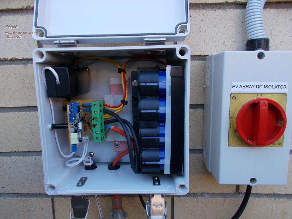

Today is a good day to do some testing, cloudy to dark with short periods of clear bright sun. The water in the HWS was slightly warm after overnight use when I checked the outlet and release valve water at 6am as when I switched over to the big HWS.
I started my test at 9.00am and on this cloudy overcast morning which at first looked like no sun was going to show, the controller still got the outlet of the small HWS hot. Now obviously starting off warm helps, but it shows that this controller, even pulsing at around once or twice a second is working really well.
I had a Digital CRO looking at the Gate Drive waveform for any sign of noise and there is nothing but a perfect Square wave drive swinging from zero to 15v at the IGBT gates, in all conditions from off no pulse to full on.
I had a DC clamp on the Solar input and at 125v I was getting 5A (625w) direct connected to the Heater element, from there the current dropped off very quickly.
Having the trim pots is great, I reconnected the Controller and simply adjusted the SSR (IGBT) low cutoff to trim pot until the NEON stayed ON while monitoring voltage on the CRO. The input from the solar panels is now swinging from 125v to 220v, and for quite a bit of time I have the NEON hard ON (no pulse).
I may have been a bit harsh about those old solar panels, today I'm seeing voltages around 161v @ 6.7A. I remeasured the heater element with a known calibrated DVM and it's 23.9 ohms (24 ohms), I confirmed the current reported by the clamp meter was correct, the power is 1.07kw. When new, these 6 panels in series were rated at a V-load of 229v @ 5.1A, so theoretically in ideal conditions they might have made 1.4kw? so 1.07kw 10 years later is not bad??.
The discharge time is, as expected, very fast, so when you look at the NEON, it is displaying the charge time, the NEON off time is the actual power delivery time. However that short pulse is around 2kw in this small system.
To recap: Old Solar panels mounted FLAT on the west side pergola, shaded in early morning, still raised the temperature from luke warm to hot in 3 hours (pressure release valve dripping, HWS is only 6 month old) between 6am to 9am on an overcast morning.
No it's not scientific, just an observation, and all on Low duty cycle slow pulsing. This tells me there is real potential for this controller.
The only real way to see a difference between direct and the controller is to fit a 2.4kw jug (I have one) with a minimum volume of water and measure the temperature change over a short period of time, around 20 seconds or less if possible. Going to try that after lunch. Very interested to see what it does in both low solar and pulsed verses direct at higher power.

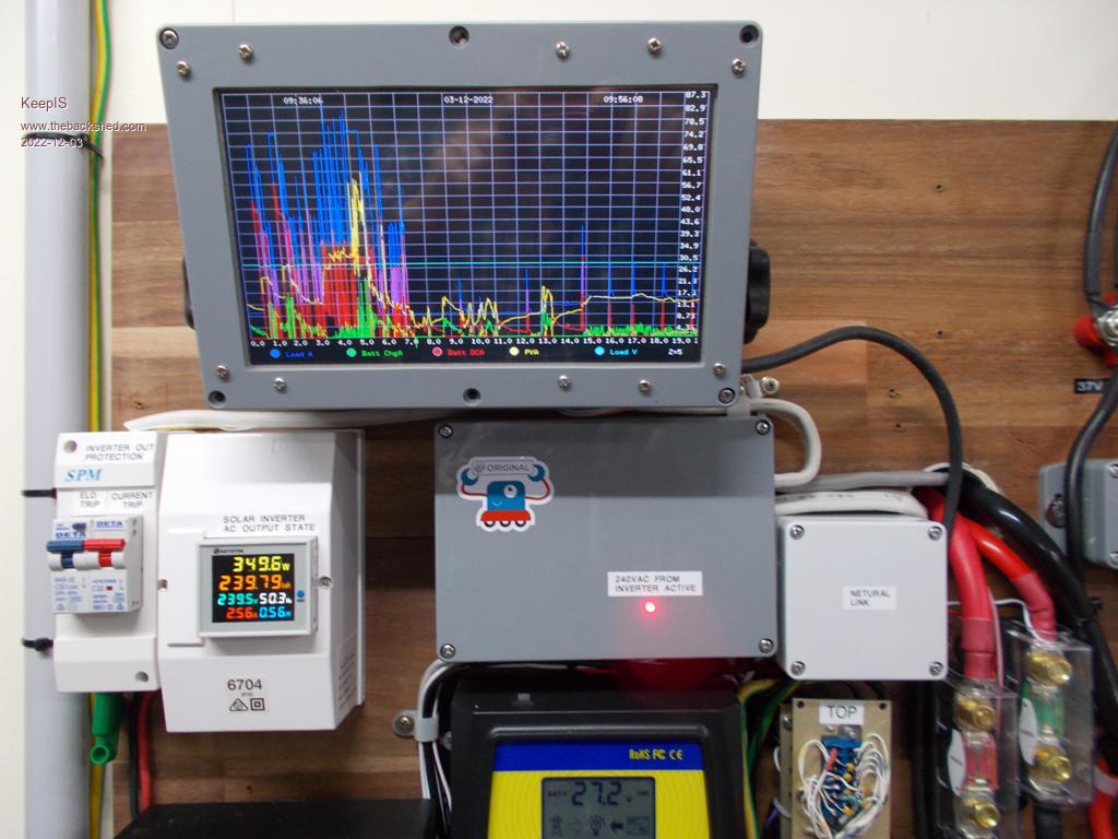

Off topic but here is a picture of the one of the many screens on my solar information display. This is showing a history graph from mid morning, I was making a coffee on the Espresso machine and using a small milk heater/frothier.
The unit has around 10 different screens including accumulated data KWh & running hours. Battery sets and each Solar array voltage, current & power. Load voltage, current & power, battery bank charge AND discharge, current, voltage & power and of course everything is graphed, including instantaneous peak values for all of the above.

I’m still doing my testing, then everything appears dead. No, not dead, the HWS is at full temperature, thermostat on highest reading turned off – feels like I would burn my hand if I tried to hold the Hot outlet or Pressure / Release valve. The advantage of starting out with some warm water left. If I double the panels (parallel) it just might be good enough even in winter when the Public power goes south the way a lot of us expect.
Got a lot of Stored Waveform to go over but everything looks good except for some instability issues with the 555 that I managed to catch on the Dig-Scope.
A few problems with the 555 in a box in direct sun, it’s low trip point appears to shift up a bit. Starts pulsing when it should just be on.  The 555 is also is very sensitive to any noise or coupling on Pin 2, even on the test bench, just putting a very HI-impedance DVM on pin 2 can cause it to switch off if it’s close to the trigger voltage, maybe the 280 to 24v SMPS I used is dirty, (RF noise on the input/output)
Pin 2 is also where I was seeing massive instability and RF like waveform, it causes the 555 to suddenly draw more current and run hot, also causes the Opto Driver IC to get hot, luckily I saw it on the scope during testing. I fitted a 0.1uf to ground from pin 2, it does not affect the trip point or transition in any way, and it absolutely stopped the instability.
I’m going to wire up a new daughter board with the new mods and revised layout to see if that helps, and put up a small sun awning for the outdoor box. Simple job.

  Quote  A few problems with the 555 in a box in direct sun, it’s low trip point appears to shift up a bit. Starts pulsing when it should just be on.  The 555 is also is very sensitive to any noise or coupling on Pin 2, even on the test bench, just putting a very HI-impedance DVM on pin 2 can cause it to switch off if it’s close to the trigger voltage, maybe the 280 to 24v SMPS I used is dirty, (RF noise on the input/output)
Interesting, I think someone else may have had this instability as well but never got to the bottom of it yet.
Before I make any more assumptions I will have to get back to this and have another go.

  Quote  Interesting, I think someone else may have had this instability as well but never got to the bottom of it yet.
I didn't realize that the 555 can get quite warm? If it becomes unstable it runs hot. It also Makes the FOD3182 run hot. Interestingly the FOD3182 does not drive the IGBT SSR gates with that garbage waveform - Output just sits low (which is nice).

The Heat today made me realize that I need to move the Controller and Solar Disconnect switch out of the sun and under the pergola, doing that first thing in the morning.
FYI: I rebuilt the daughter board today (basically the 555 timer, Opto driver chip, trim pots and regulator. The new layout with various mods from testing has solved all the issues I was having. Just need some freezing rainy weather to test properly.
