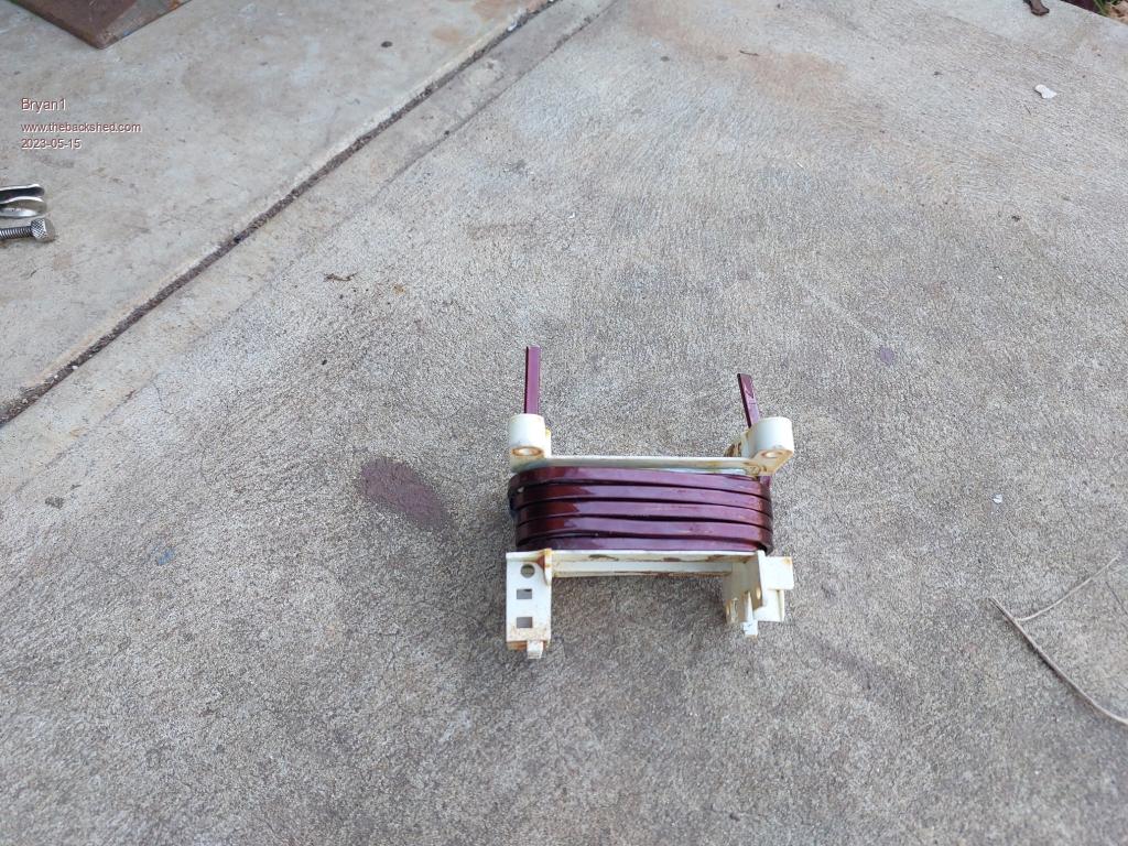

G'Day Guy's,
           Well had a bit of fun pulling this grid tie inverter apart and the big chokes were a huge surprise as instead of wire it used a a copper film sheet only 0.3mm thick. 3 off E-core sets held together with that yellow tape I have here and a spacer for the e-core gap.
Pic's to come later and I do think winding some of that heavy gauge wire on the former may be the go. It will be next weekend when my LCR meter arrives that PD gave the link to and I'll have to build that board then the real fun can start.
Cheers Bryan

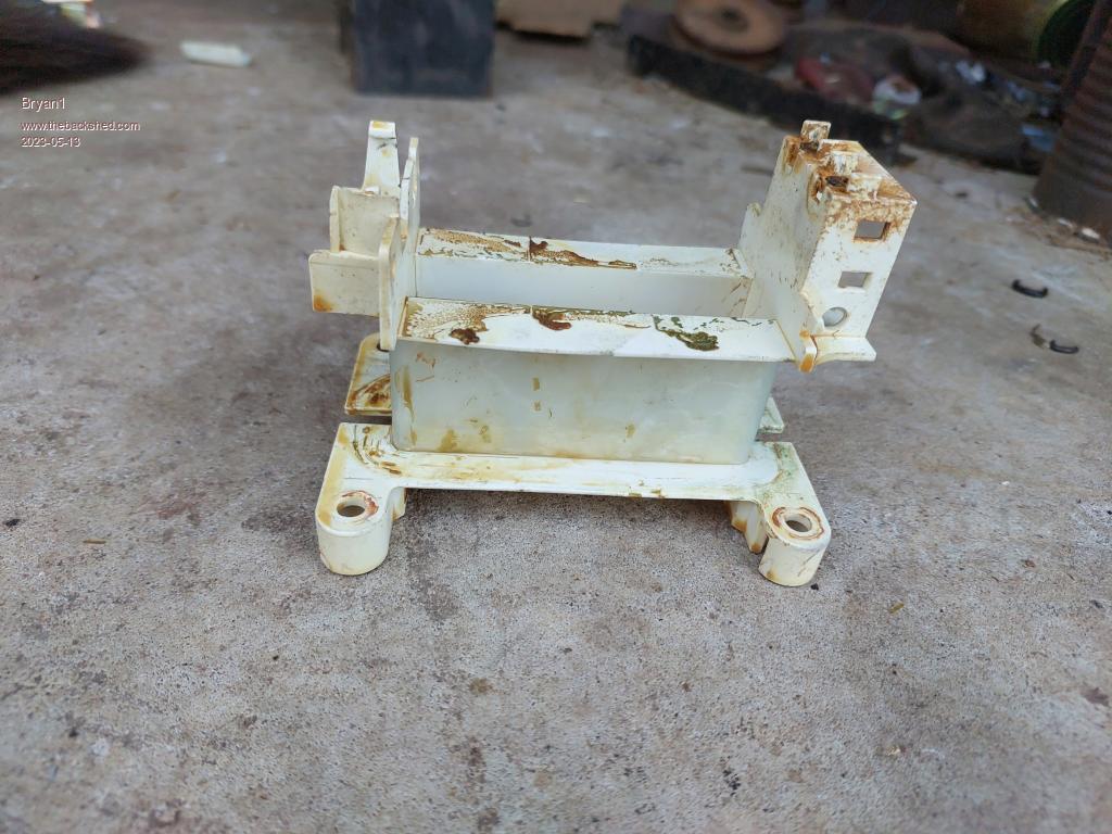

G'Day Guy's,
           Well stripped out that choke and found it had 9.725 metres length, 30 x 0.3mm in width. So with the former being 85 long x 25mm thick and 36mm in height gets us 220mm a turn. With the thickness of the former being 11mm I can easily get 2 and possibly 3 layers in for a rough total of 18 turns.
Here is a pic of the E-cores and the transformer and it does have spacers for separating the E-Cores.
Here is a pic of the former
Cheers Bryan

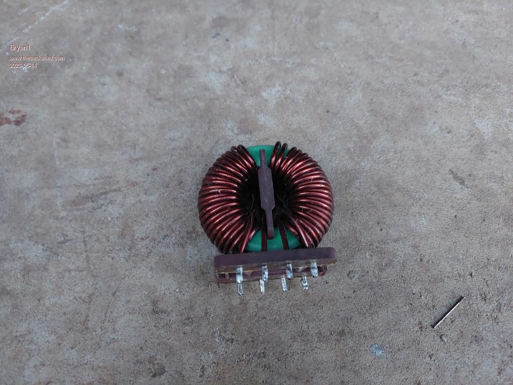

G'day Guy's,
           Finally got that frontuis inverter all stripped and found this
Each side has 12 turns 2 in hand on and all the connections out at the base so it may just be the first choke I try.
Cheers Bryan
Revlac
Joined: 31/12/2016
Posts: 1310
Posted: 08:07am 14 May 2023
That green one is a common mode choke, ok for the AC output, not good for a transformer primary choke.
What else you have there?

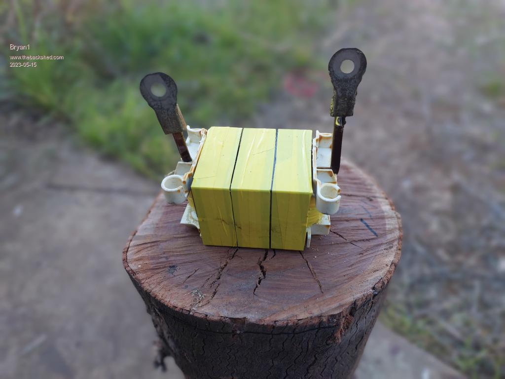

G'Day Guy's,
            Well that choke I showed above just had to rewound with 10 turns of my 6.5x3mm wire I had here, did have to make a join so just filed down the end 20mm long to 1/2 the thickness and after soldering put some heatshrink over.
and a pick of it finished
As I do intend to get a mppt finished first this choke will go on that and with only 1.1Kw of panels it won't be run that hard.
Also hopefully anyday now that kit for the LCR meter should turn up as it will be interesting to see what value this choke is.
Cheers Bryan
