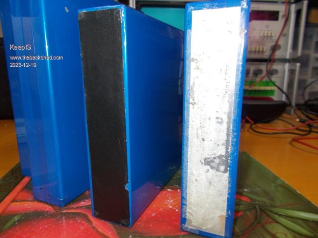

After Removing the Cells from the battery case, I found them in perfect physical condition, completely flat with no swelling, obviously I can’t tell the quality of  the cells, and the bar code does not indicate the maker.
The cells were held in place with a poured rubber molding, not a good idea as the batteries were on their sides and the lower terminals were covered by the liquid molding before it hardened. There were no insulating sheets between the battery casings, just relying on the thin plastic covering, not good in a battery aimed at off road and caravan solar.
When dismantled, I found the rubber molding material was still liquid around some terminals. I think capillary action and heat cold cycles due to the poor workmanship in terminal assembly and the terminal thread tapping, the result was over 250mv voltage drop @ 40A between some terminal studs and the plated solid copper links. Most were at least 25mv @ 40A.

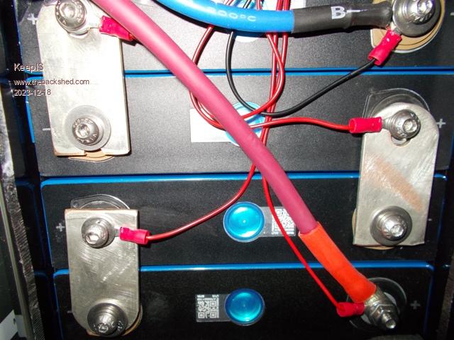

One set of batteries had longer link bars cut down “roughly” with a hacksaw and a hole drilled through and bolted on without de-burring. To compound this, the drop across the common line connected BMS was 17mv and the drop across the battery plus lead from the Cell to the external battery plus Terminal was 15mv @ 40A.
Add all that up and you wonder how it even worked a all. Obviously over time the spring washer tensions reduced and the heat cold cycle through what started out as a smallish voltage drop due to poor connections just grew and then snowballed as the terminals got really hot on occasions of sustained current and the resistance from corrosion, melted rubber compound and heat increased.
FYI the BMS was a Daly 100A.
The picture is after I cleaned and de-burred the copper links and slightly rounder off the hacksaw cuts, again, a 40A load was connected across the battery, this time the voltage stayed at 13.2V a big difference to 12.4v. The heat previously generated by the 250ma loss was enough to almost burn my fingers when I touched the Link Bar. The resulting heat is the likely cause of the liquefied rubber compound.
Just the thing you want for long life with a LiFePO4 cell.

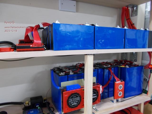

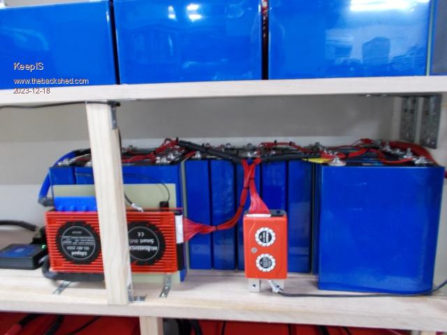

I grabbed a 16S 200A BMS and an Active equalizer, I took 16 cells from one bank (4) batteries and managed to get all cell sense and balance leads correct first go for 54V out. I have not top balanced each cell yet. I decided to charge the 54v battery at 25A and slow the rate of charge if the Delta was more than 300mv, and just let the active balancer do its thing for now.
Every cell appears to be fine, I will do a discharge / charge cycle and plot the real capacity when I get a chance – I have a tester for that.
At the moment the 16 cell battery is running the home and workshop with the cell voltage variation across 16 two year old cells at 42mV.
The second bank was in almost the same sorry state, they used the correct size Copper links this time, but again, some terminal holes were not deep enough with screws bottoming out without fully clamping the links. Lot of loss in the Link to terminal connections. I think I caught these just in time.
BTW I did get a free replacement for the faulty dead unit. Apparently one cell had failed?

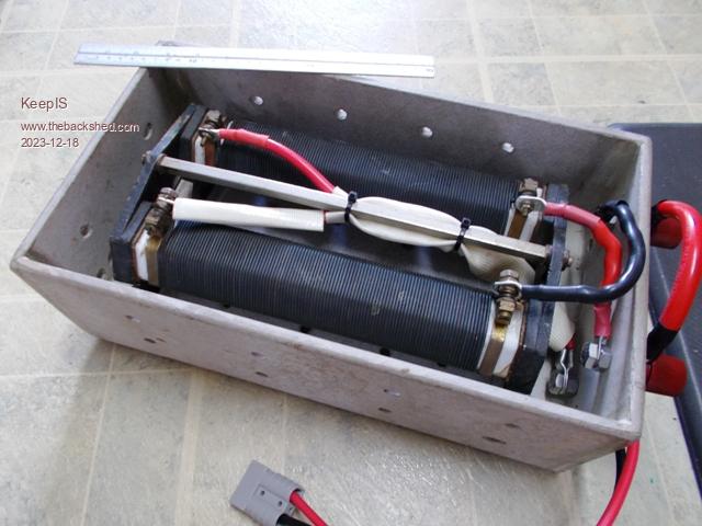

This is the load, 43A @ 53v and 42A  @ 12V using a combination of series or parallel or single  connection. That’s a couple of KW at 50 volts.

Looking at your first picture, I would not be happy with those cell links.
Mine have a hump (like a speed hump) in the middle, presumably to compensate for any temperature related dimensional changes between the firmly clamped terminal bolts.

Hi Klaus, they looked even worse when I first extracted the cells from of the case. I will be making my own to replace all of these. The two Links I made and tested the other day work beautifully.
All four batteries were assembled the same, it looks like a supply shortage for that batch of batteries back then.
The other sets were bought about 2 months later and use the same thick high current solid links, but correctly sized. I think the hump in the links are also there for the expected dimensional changes in the Prismatic cell Posts and case swelling, more or less over their life time, I think most of the initial swelling happens at the factory from the initial charge discharge cycles for grading etc, if not abused they appear to have little change after that.
I guess it also depend on the quality of the cells and other environmental / load  / charge conditions.
None of these cells were clamped and I'm not doing that now in light of the way I use them, I leave about 4mm space between all cells when I assemble the cells into the desired configuration.
I also have a 48V 16 cell EVE bank which uses the copper links you describe, these are two layer links with some flex, very nice units and the cells have solid meaty quality terminals.
EDIT: Also looking at the picture notice the mismatch of washers and spring washers, along with only partial contact with the full cell terminal surface due to the hacking of the links.

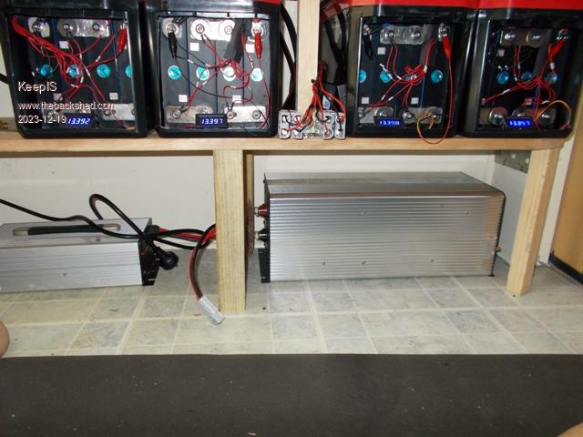

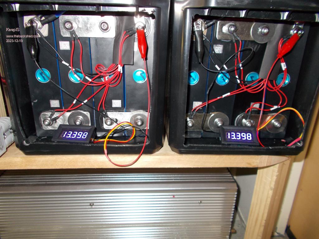

About a week ago after I found the construction problem in the 12V batteries, I cutout the end of each battery to access the Cell terminals and attempt to band-aid the problems to see if the cells were damaged.
You can see some big washers and even stacked washers to get the tension onto the Link bars which were unable to be clamped correctly due to insufficient screw hole depth, they were drilled incorrectly and there is no way I'm going to attempt to drill the posts. There is enough thread to get good tension if you stop the screw from bottoming out.
This is the second 4 x 12v bank I'm about pull down for another 16 EVE cells.
The Anderson connectors are where I plug in the Active Equalizer and also where individual 12v batteries could be adjusted to keep the bank in balance if needed.
The Meters quickly added to keep an eye in each bank as I load tested and High current charged them during the tests, also monitored each cell during the process looking for any obviously bad cells.
Edited 2023-12-19 10:14 by KeepIS

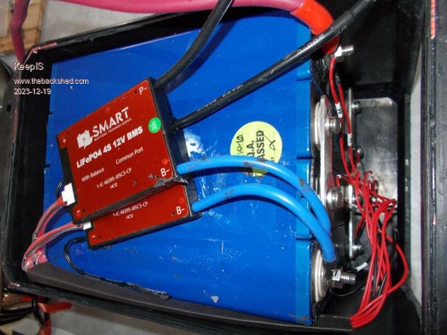

Says Dual BMS - not expecting to find two really small units, sigh!

It's not the brand you mentioned, but as these batteries are a few years old, I don't want to cause any harm to small businesses that would have been doing it tough back then, and are likely having more trouble now with the way they are being secretly backhanded by various groups of clowns.
But even after getting the connection links in a low loss working state, this bank did not have a hope of starting the big BandSaw, just trips with low voltage.
The 48V pack built from the same cells now has no trouble. I would likely put that down to the extra voltage drop across Four BMS, 4 sets of positive battery terminal to cell connections, and the smaller gauge cables used.
They simply cannot handle 300ms 400A DC inrush current peaks from the AC load on the inverter. They would definitely drop below the LV cutout, I'm assuming that the BMS is not spitting the dummy, but who knows, and frankly I could care less as they will no longer exist after I rip their guts out
Edited 2023-12-19 13:08 by KeepIS

You may be thinking this already, but perhaps get rid of the cases and BMS units. Link all the cells in one chain with thick links and cables. If they survive the Bandsaw test then it may be worth adding your own proper BMS and getting some more mileage from them.
KeepIS
Joined: 13/10/2014
Posts: 2289
Posted: 03:58am 19 Dec 2023
Hi Phil, if you look at the photos in post three you will see this is exactly what I have done, 3rd post shows 16 of these pulled cells in series and a 200A 16S BMS with 1A Active balancer. Working perfectly.
These last photos are from the next set that I'm converting into another 48V battery.

Found one with the bottom protection cover partly unglued, that exposes the metal case which is also the Positive terminal of the battery. The active metal case of this style of LiFePO4 is why I questioned the decision to just lay 4 of these cells together and wrap them in tape, that blue metal cover is pretty thin, if a pair of cases punctured through for any reason that's two batteries shorted.
These 12v batteries were also targeted at off road vans and 4WD solar.
Maybe I'm just been paranoid
KeepIS
Joined: 13/10/2014
Posts: 2289
Posted: 05:25am 19 Dec 2023
The cells shown above appear to be fake, the barcode is almost a faded pretend bar code square, there are only 12 digits and the reader does not identify them either by scan or code input, merely giving a suggestion of fake from two possible sources that I have never heard of.
Still, they appear to work, I will put one cell on the tester overnight and see what it comes out at.  What fun!
