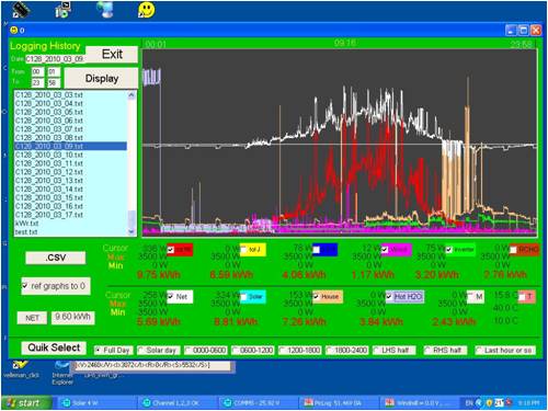

BjBlaster
Joined: 04/04/2008
Posts: 55
Posted: 03:21pm 25 Mar 2010
There is nothing quite like a graph.
Here is mine. I don't use any of the inverter info (because it doesn't have any on a PVE1200) so I built my own using PICAXE's and a PC.
see it live here logger if you *need* to :)Edited by BjBlaster 2010-03-27
