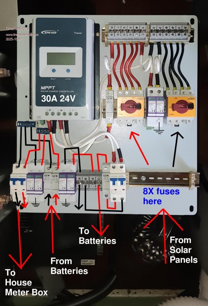

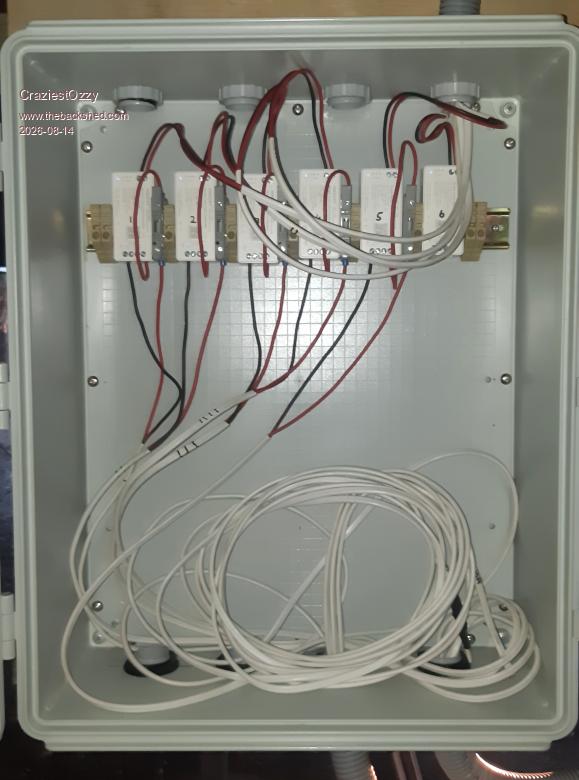

The purpose of this post, is to get outside opinions on my current project of installing DC lighting in the ceiling. I may also be able to help future blokes who stumble upon this  post long after I am a flatulent motion in the wind.
Scroll here to start

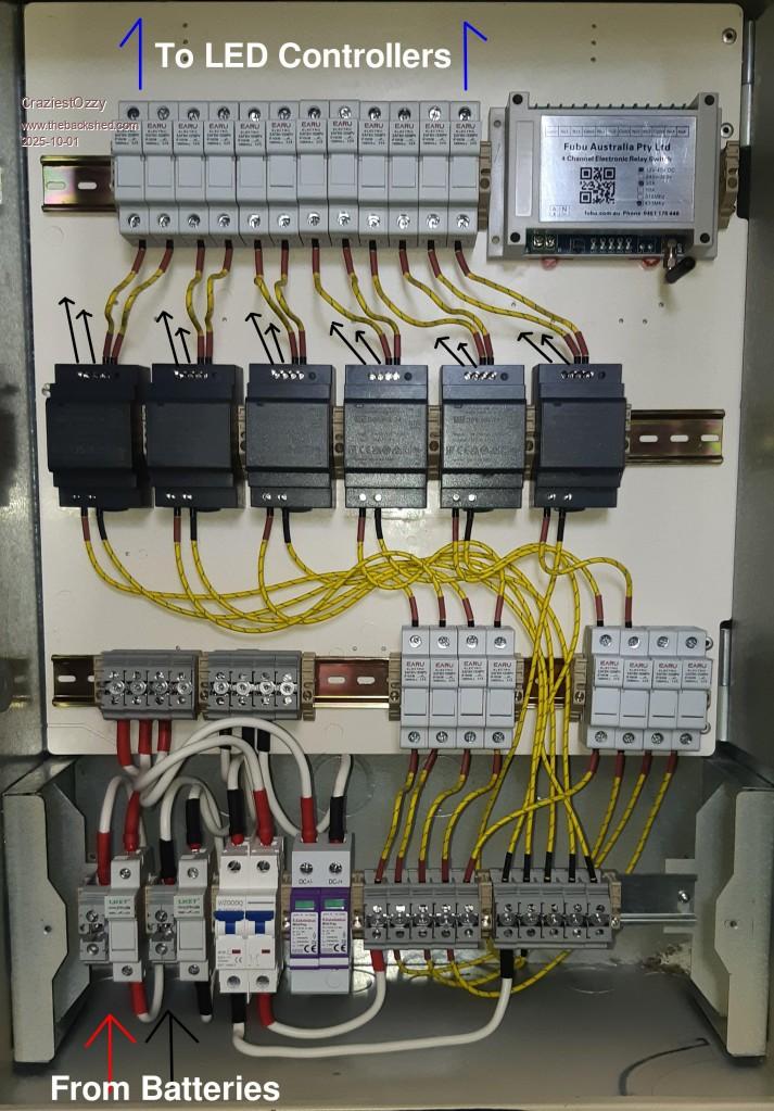

A)   24vDC will power the light system.
B)   920W will be the maximum solar panel output
C)   400a/hr will be the maximum battery storeage using 12vDC flooded lead acid batteries wired in a 2P2S.
D)   30A is the maximum circuit current draw and circuit designed to meet that amperage- when adding total maximum rated input current for 7 DC-DC converter units.
E)   7A is the actual current draw of circuit. when adding a total of 14 individual LED lights. Led lights have a current rating of 0.5A each
As far as the Australian Standards are concerned, I have to the best of my knowledge, avoided the requirement to have a sparkie install my spaghetti wiring. My haz-mat suit for the lead acid batteries, is a blue singlet, stubbie shorts and a terry towel hat. Foot protection is a pair of thongs.
Overview of the circuit and devices:
Where I live, we get heaps of lightning ground strikes. Just last week, we had our first storm of the season and one strike hit the breaker on the power transformer a few yards from house and another hit the roof and did some funky stuff to the roof and freaked out my dog and missus has some extra grey hairs.
The electrical system, I have designed to minimise damage from an indirect strike.
Some protections are in place within the circuit, to reduce the impact of a direct strike.
A)  Din rails, meter boxes, MPPT and solar panels will all be earthed with 16mm2 cable.
B)  SPD Nominal Voltage designed and rated especially for 24vDC system with T2 lightning protection. I am still sourcing T1 device that won't cost an arm and a leg.
C)   10mmx38mm Ceramic fusing (fast blow) for all positive and negative circuits. While a lightning strike will pass through a fuse before it blows, their presence makes me feel good.
The ceramic fuses have legit infill powder to immediately extinguish overcurrent events.
I have just received a set of 1500vDC 14mmx85mm fuse holders that will protect the in/out cable to both meter boxes.

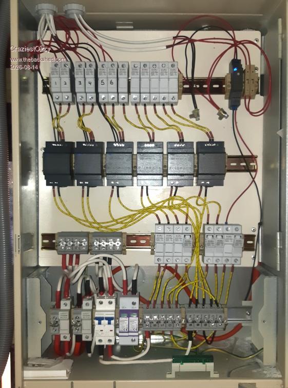

The row of black boxes, are the DC-DC isolated converters.
DDR-60L-24 INPUT: 18~75VDC 4.5A OUTPUT: 24V 2.5A
I chose isolation devices as I did not want a direct link from battery to the interior roof of my house.

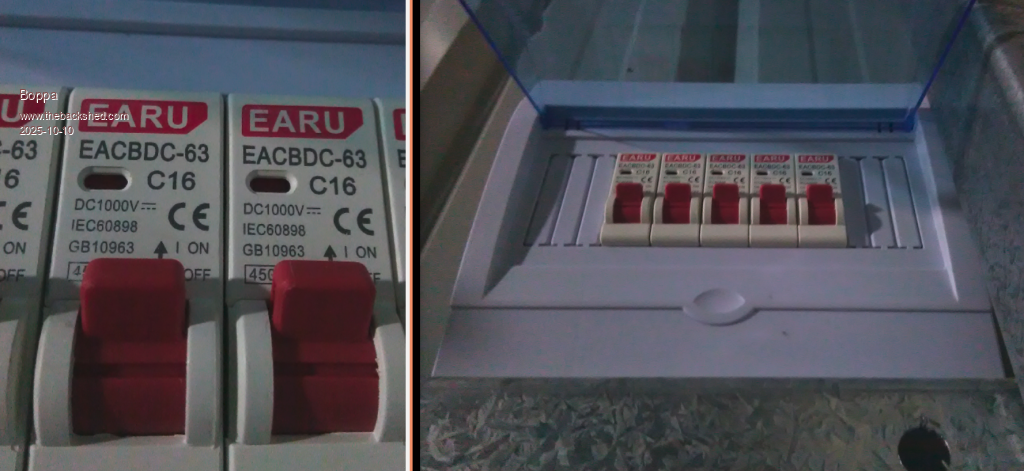

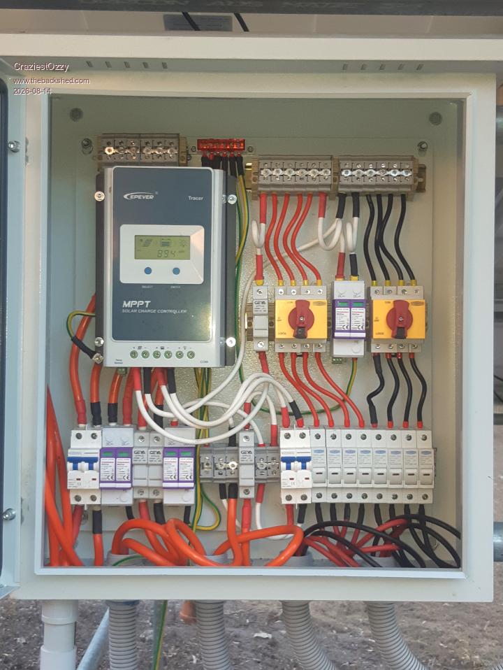

I have chosen to have my solar isolation switches inside a weather protected meter box, knowing some nob head in Canberra once said they should go on the roof.
Recently said nob changed their mind and said we can now have them where a human can reach them...not realising that over time these switches ingress water so same nob said that we now have to put on an umbrella for these switches. Mine goes in a meter box.
MCB's are non-polar and act only as a switch to disconnect battery sources.
...waiting on a bunch of fuses and ferrules as run out, so not wired yet :P

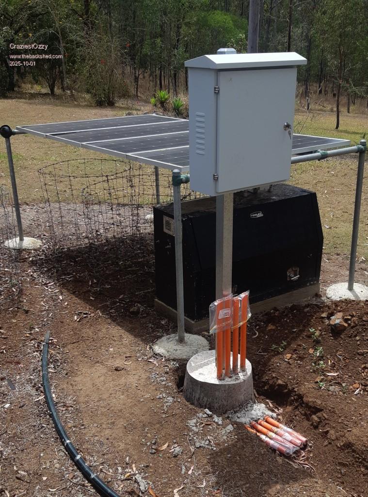

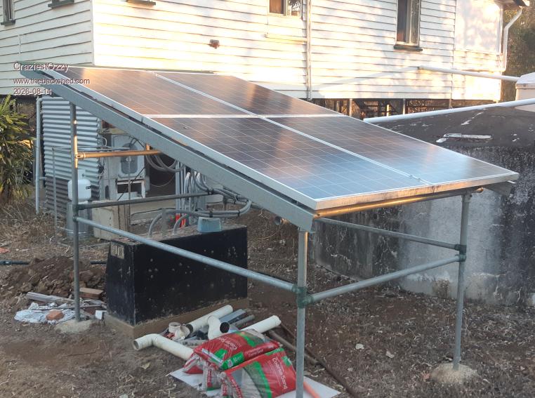

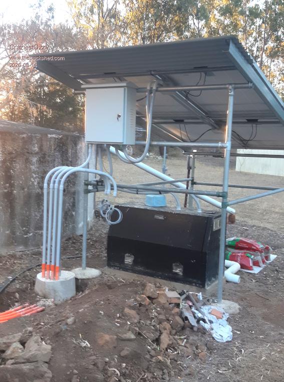

My ground solar system, soon to be updated.
I never did get to wire this into the house, as I relaised the expense of running 12v cable at less than 3% voltage drop was gonna cost me an eye tooth or two.
So been sitting there doing nothing.
Not cyclone rated or approved by a government sponsored company, but way stronger than any of the government approved crud out there.
Posts go 70cm into the ground.
I will be raising an end so the panels face north at 20degree angle.
I live at 25degrees.
Enough of an angle to reduce hail damage (lol) and enought to catch a good average of  Winter rays while still performing in Summer.
Going to have to widen it, as the panels I have just bought are 60 cells
Will have to cap the dug channel ready for conduit with 10cm thick slabs of concrete as can't dig through solid basalt with a pick-axe.
Edited 2025-10-01 15:31 by CraziestOzzy

Hi Mr Ozzy, that system looks excessive for just a few lights.
First normal circuit breakers used for 240 volt wiring  work fine for 24 volt circuits.
Lightning is very difficult to protect against, I had an inverter blow up ( fortunately repairable) from a lightning strike on an off grid house. Just the induced voltage in the house wiring was enough to kill some components.
Without any overhead cables to the house you most likely wont' have much problems with lightning strikes. As Phil suggested some spare lights in a box will do the job.
I have lived off grid now for 50 years and never had a light damaged by lightning. Only one inverter damaged once.
If you are running 24 volt lighting then there is no need for DC to Dc converters.
If you plan to drop the Dc voltage from 24 to 12 volt there are plenty of really cheap converters around.
For you solar panels you are allowed to wire stuff up to 120 volts Dc without needing a sparky.
So connect your panels in series parallel, I would suggest 2 in series and parallel the groups, that way you can send the panel voltage to the house at 60 to 70 volts and use an MPPT controller at the house to charge the batteries. There will be a lot less voltage drop problems.
6mm solar cable is pretty cheap if you can find it on Gumtree or ebay. You can parallel some up for your underground run from the panels if required.
Multi led panel lights give a much better light than the old MR16 downlights,
Anyway have fun and good luck.

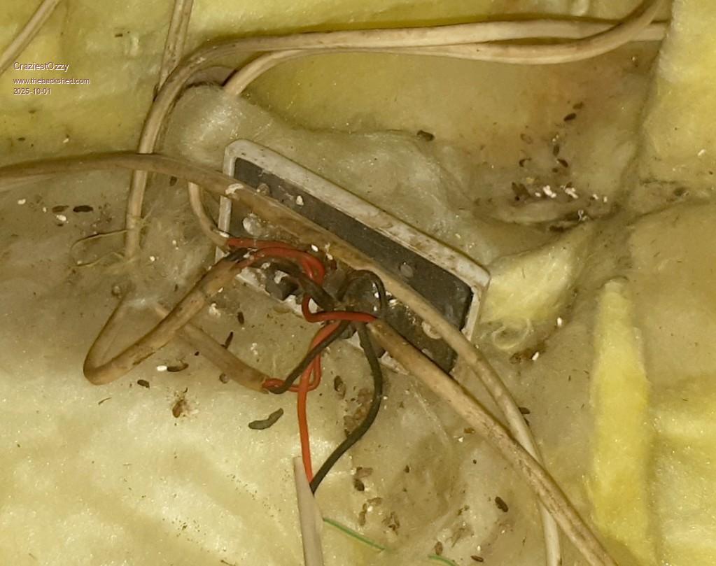

Day one in my house, self inspect the ceiling and lift up a slab of insulation.
Bloke who wired this up, too may beers mate.
What is with rats and electrical wiring.

I did my trade as a sparkie. I did domestic wiring stuff for a few years. Many times I came across wiring where the sheathing and insulation was chewed off the cables in roof spaces. Sometimes there were up to 2 metres of bare wires still clipped to the rafters and still live.
I fixed one light in a lounge room once, where the rats had actually eaten the insulation and also eaten through the copper neutral wire.
It was a clip lock roof, so I had to pull sheets of roofing off, rewire the light and put the roof back on.
A week later I was called back because the light stopped working.
Same thing the rats ate the neutral and the insulation again.
This time I used conduit to enclose the cable and ran it in a different route.
The rats seemed to have decide that the eaves were their own space and any cables in that space were to be got rid of.
That was many years ago now, so moving the wiring to a different route worked.

CraziestOzzy
Joined: 11/07/2008
Posts: 156
Posted: 07:06am 01 Oct 2025
Yeah, will agree with you there.
A dozen LED lights with room for additional lighting outside and downstairs.
I did fail to plan for a Tsunami though.
I see your point and agree too. The only reason I have these units, is that their circuit has reinforced in/out isolation. No direct link from battery to light.
They also have additional inbuilt protections and ontop of those protections, they have an input undervoltage protection.
Bonus also in that I can compensate for voltage drop by 10% as they can be adjusted to act as a boost converter.

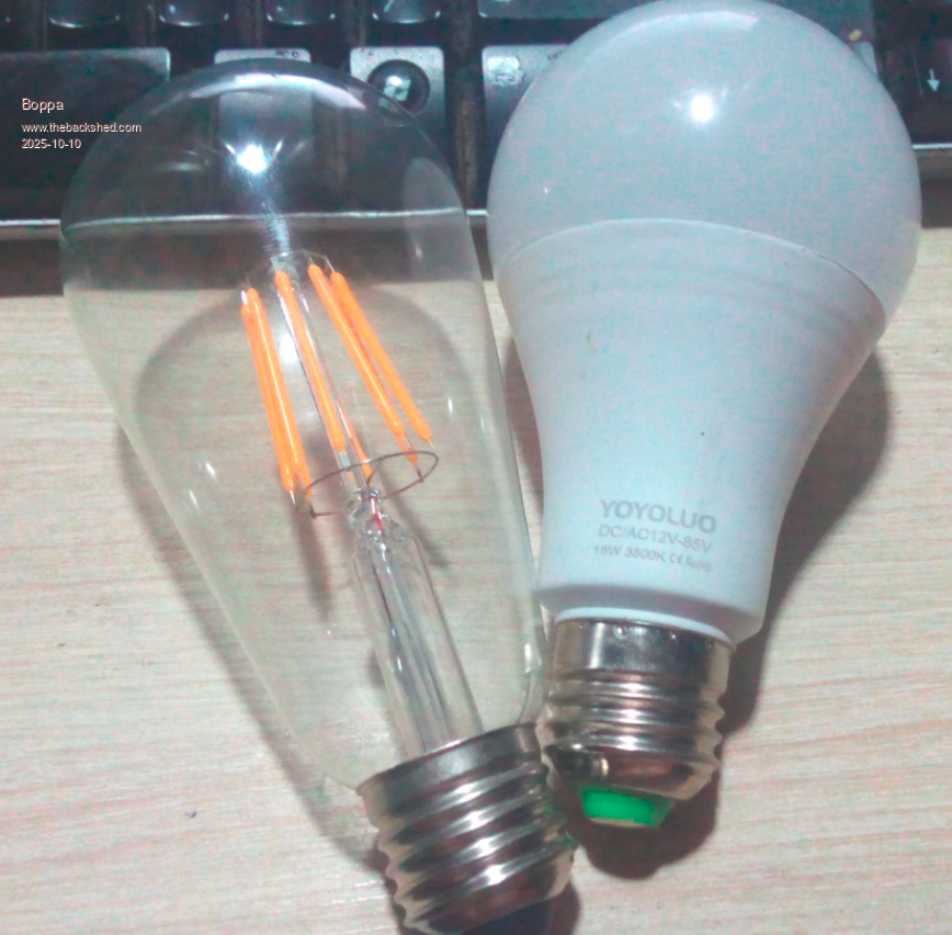

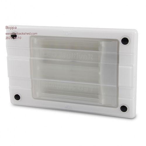

Absolutely and did think of that.

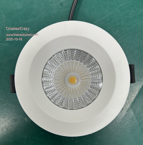

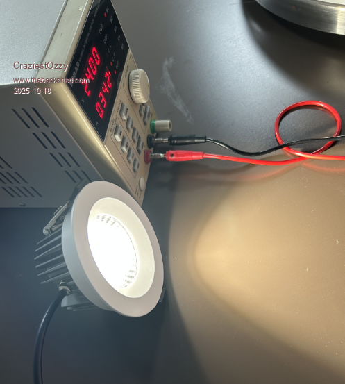

Took me awhile to find some, but have two flat panels ready to place in the pantry. Sourcing genuine 24vdc panels with a white ballance of around 4500K was fun.
Main lighting for home is traditional downlight design, with a Cree COB LED.
Also have a few long filament ST64 globes for hanging penadants.

Godoh
Joined: 26/09/2020
Posts: 721
Posted: 08:43am 01 Oct 2025
You can use ducting to hide cable if necessary. Rectangular PVC ducting has removable lids for easy installation.
Going from candles to smart lights seems a big jump. having to have the house connected to the internet for the lights to work seems pretty out there.
I don't know why you want isolation between the batteries and the lights.
A fuse at the batteries to cover any cable damage or major shorts, then circuit breakers for the lighting circuit would be sufficient
I haven't seen any new regulations but any search i have done, the wiring rules still list Extra Low voltage as 120 volts ripple free DC and 50 volts AC.
As far a voltage drop goes it depend on the current draw of each light.
It is best on low voltage to keep the number of lights per circuit to a minimum, but on 24 volts generally you should not have any problem putting 3 or 4 on the same breaker.
Are you planning on using an inverter to run 240 volt stuff? like kitchen appliances etc.

Yeah its a bit like that here too, we got our share of blown up stuff when we were in the process of getting rid of the grid connection, (Started a thread on it somewhere) since then the neighbour on the south side has had the house hit twice, second time it took out all the appliances, the neighbour on the right, had the underground cable hit (300m along from the box) and shorted, burnt out the 3 phase cable, each conductor was bigger than most welding cable.
Don't expect underground cable to be safe from a strike.
Your ground mount panel setup looks good, I did one a little stronger bigger pipe and its 12m long with 21 panels, The main cable from each set of solar arrays has an Anderson connector, so Easy to just pull them if we think some lightning is on the way, still have one set of panels that need an Anderson plug (instead of a disconnect switch) before the storms get going.

With the PVC ducting, chose to not go that way as I like the look of a wall without them. Plus a lot easier for me, as I just have to program the switch and mount it anywhere I like.
Smart lights without internet access requirement, is a challenge I took up. I'm into the tech stuff as a hobby. If the proverbial hits the fan and I run out of my supply of coin batteries...will have to go old school with a hard wired wall switch for sure.
The isolation thingy...I have the Heebie Jeebies with anything directly connected to a battery containing a lot of juice. The isolated output on these controllers is 2.5A max. Still that's enough to heat a wire should a fuse not do its job.
I may have gone overkill again for the circuit from LED controller to LED light, using 1.5mm2 silicone/fiberglass-sheathed high temperature cable for a 0.5A/24vDC draw.
I like it as cable is stiff and holds in place and won't deteriorate in a hurry.
PLus I got a few hundred meters cheap from manufacturer in China.
Nod my head and agree with you on the 120vDC ripple free...stuffed if I know where I read it. Just found it. Link I include isHERE

I actually am limiting each circuit to two LED lights per controller. I have enough room for an additional third, should the need arise in future.
....plan in the long term, to use an inverter. Will wire it up and get a sparkie from out of town to certify it over a few beers.
...to overcome the 1 kilowatt-hour battery store limit, I plan on having several individual solar setups with their own circuit etc.. One for the lights (this post here), one for the household water pump, one for the fridge.

I have done away with Anderson plugs and feed each panel directly into the meter box.

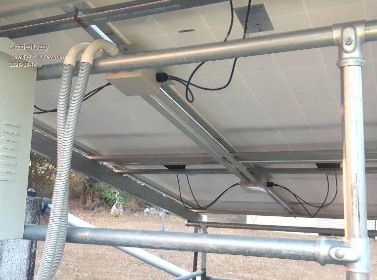

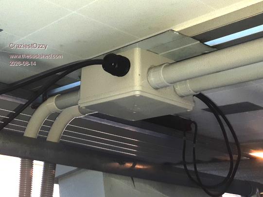

The short cables from the solar panel are cut to remove plugs and go inside into a junction box, wired to connect with a long run of cable that will be fed through conduit. and out the other end to meter box.
All wired in Parallel inside the box, but each cable has to pass through the disconnect switches before joining onto the terminal block bus I have setup.
I have elected to use 10cm thick concrete slabs to cover the underground conduit. Easier to get to the underground conduit should a bolt from the blue hit it.
...had a huge python in the shed last year, made a home in the roller door to the shed. Couldn't get me car out or the snake out. Took two blokes to get him out.
So I don't want rats in the celing :)
...possums either

I have also cut off got rid of most of those little MC4 connectors and run the wires (had to extend a few) to the junction box, my panels in series are about 90v, The standards don't go well for those that want to use a GTI in conjunction with the off grid inverter, though the average late model sparky probably wouldn't know about them being used this way.
If you have easy digging ground that should work great, The ground here requires a digger.

  Revlac said  The standards don't go well for those that want to use a GTI in conjunction with the off grid inverter...
Yeah, with GTI's ...I don't see the point seeing that companies in bed with the government are leaning towards charging the consumer to offload into the grid. GTI is great if you signed up years ago and had a binding contract with great monetary returns- but not today.
I accepted the challenge with respect to what I believe the new Standards are saying and moving to in the near future....their making it impossible to have the average bloke DIY his own solar off grid power supply lawfully and forcing them to stay on grid.
Of course, you can say "stuff you" I am going to do what I want on my land...but when it comes to selling your home, their may be some issues there...which again is why I am keeping inline as best I can with the Standards.
Instead of the one solar system, I will have several as mentioned earlier feeding certain sets of appliances.
If an essential appliance like a fridge stuffs up, simply sacrifice one system and connect to fridge while repairing the buggered system.
This way I remove total reliance on the one system should it fail and now have several backups to essential appliances.
Costly way to go, but I'm happy with that route as it gives me power to stick my middle finger up to the government and their "sponsored" list of "approved" companies.

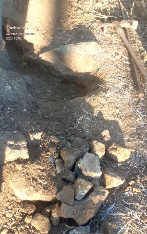

My soil (or lack of) near the house is stuffed.
Gave up on the deep trench and going shallow with a cap of cement slabs.
Edited 2025-10-02 11:40 by CraziestOzzy

With your underground cable run, theoretically if your trench is not 500 mm deep then you need a continuous concrete pour over the conduit. It would probably be fine to put your concrete slabs down and fill in the gaps with concrete, just make sure to put underground tape over the slabs.
The tape is just a thin orange plastic on a roll that has Danger electric cable written on it. It is pretty cheap.
I usually put a layer of tape a bit above the orange conduit, then another layer not far below the top fo the trench. That way anyone digging it up will find the tape fast
