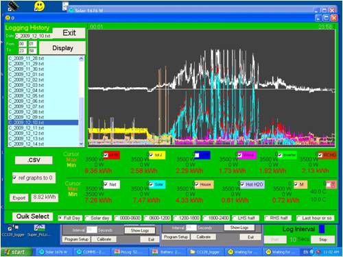

Hi Bree,
For the cost of the COMM board for the Fronius, you could get a 3 channel Current Cost meter under $200.
You would then be able to compare the recorded solar day to day and 2 other channels as well.
Here is a graph output from a 6channel unit. I have made a VB6 app.
Logging the Fronius for only power does not give much info. Comparing house consumption to solar and OFF peak hot water etc is more informative
Gordon.

Hi Bree
I am a friend of Gordon and see him many times a week, as we live close to each other. He may not be able to answer you for a few weeks, as he is having a holiday.
I have a Current Cost Classic, exactly the same as Jaycar sells. It monitors 3 channels whereas the the one you referred to (in your link above) monitors 10 channels, although you do need to buy extra clamps. The originals only come with one clamp.
The original Current Cost devices do not do a very good job of providing valuable information due to (in my opinion) quite poor software! Gordon has done a magnificent job of writing his own VB software to address that issue. After completing the software for the Classic, he has been recently working on the newer model (which requires a lot more programming due to the different data streams and the extra channels) He received a pre-release version of the 128 from the importer to allow this development. In summary I find Gordon's achievments to be amazing!
As you can see from Gordon's screen dump, the graph displays information that would otherwise be un-available. In my case I use it to monitor three channels. They are Solar1 array output, Solar2 array plus wind output, and Total household consumption. By regularly checking the graphs, I have made very significant changes to my system to allow better energy efficiency. I believe that this has allowed me to pay for the cost of the Current Cost in about 6 months due to energy cost reductions.
Some of the changes made as a result of the monitoring are:
- a faulty capacitor in a rain water pump was causing the pump to intermittently not start. Instead it sat in a stalled state until the thermal cut-out activated. This caused massive power consumption that was seen by huge peaks in the household graph. I would not have detected this without the CC.
- my solar grid connect inverter consumes excessive power during start-up. This is seen clearly on the graph but would not be detected by any other normal means.
- a faulty electronic battery charger was consuming large amounts of power.
- my home network of computers often wake up during the middle of the night without apparent reason. The consumption graph clearly shows at what time this happened, and allows for fault finding.
- my media centre computer consumes excessive power. This can be seen by the jump in consumption when it turns on. I was previously totally unaware how much power this was consuming. Now I am replacing the mobo with a low power Atom board.
- the CC clearly demonstrated that I had a very high background power consumption around 350 watts (this was the base 24/7) I have now reduced this by buying some cheap electronic power time clocks to inactivate un-necessary devices for part of the day
- I am able to relate wind generated power to wind speeds and use this information to increase turbine efficiency by experimenting with blades, controller etc.
- etc etc etc. It is amazing what can be interpreted from the graphs
