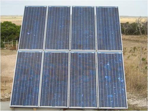

I think it will depend rather a lot on how many panels you have, what your site is like etc.
My original array (4 x 80W) was on a fixed frame.
I moved it to a sun-tracking (single axis, but with manual adjustment for season) and picked up about 35% more watt-hours per day.
I built a traxle with another 4 x 80W panels, but never got around to making the sun-tracking work on it. I did, however adjust it for season.
With two identical arrays, cabled to the same battery bank via two identical meters, it was easy (and interesting) to compare outputs of each at different times of day. Tracking certainly makes a difference.
Finally, I bought 1200 watts (12 x 100) new monocrystalline earlier this year and built a frame for them. It was completely impractical to put them on any tracking frame I had or could reasonably build myself. The cost of panels by now was so low, I simply added a third to what I'd originally planned (so 800W became 1200W - because I was running them in a 48V configuration, it had to be multiples of 4 panels)

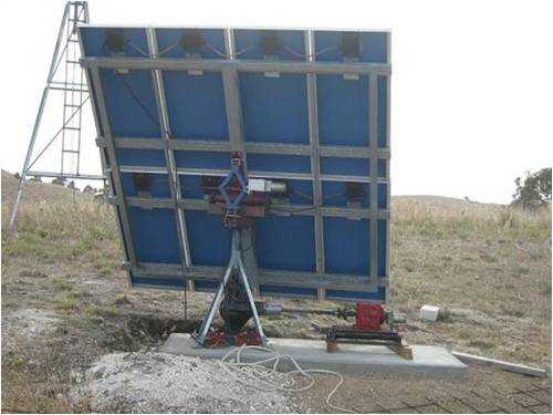

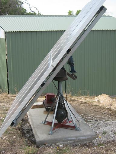

If you have to pay someone to build you a tracker than may as do what Karl said and buy extra panels.
2 years ago i built a tracker for a friend who is totally off grid.
The increase in power was at least 30% and the power needed to drive it was almost nothing. It travels a 120+/- deg arc and back in the course of the day.
The motor was an 24volt dc from an old photo coppier (small) feeding through around a 400:1 gearbox reduction (just happen to be a bit of junk hiding under the bench) The high reduction prevents it being rotated by the wind.
This is then coupled to the input of a car diff stood on its end with 1 axle removed and the spider gears welded to make a locker diff.
The diff adds another 3.5:1 ratio.
The rotation is controlled by time and is moved in steps throughout the day and reversed back to the start each morning at a preset time.
We used two time cycles one for winter and one for summer. There was little to gain with fancy time periods throughout the year.
We also found that the tilt on the panels made bugger all differance throughout the year and is not adjusted now days (it did have a second motor on it)
We considered the use of light sensors tracking the sun but is of little advantage as the sun moves at a constant rate of travel and sensor systems only cause the tracker to hunt on dark days using more power.
The more crap you can keep out of the system the more reliable it will be.
It is not the prettiest thing i have built but it is robust and has handled some good wind forces without a problem.
The only problem has been caused by the owner not fitting the limit switches for an emergency position stop as it had worked so well.
A timing glitch soon showed the need for the limit switches. (about a year later)

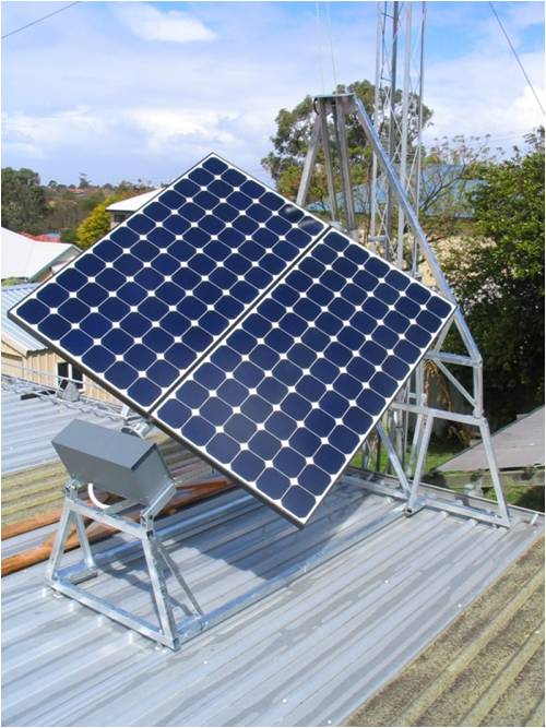

Posted: 01:09pm 31 Dec 2009
Pete, a question on your ingenious diff based tracker.
It appears to track the sun with the inclined panels rotating on a vertical axis.
I am wondering if this way is more or less efficient than having the panels rotate on an inclined axis (N,S orientated)?
The picture shows my tracker which is two axis tracking. The second axis is not really difficult to incorporate, I think it does make a difference for those living further N or S of the tropics.

There is a car jack stuck up the rear of the mount that had a geared motor on it for tilt. The whole lot pivots off the main centre beam and can be tilted forwards and backwards as well as rotated.
The owner choose not to use the tilt from trials done made little difference to their requirements and just another thing to cause a problem.
I do agree with your method and its well engineered.
The one i built was thrown together in a week over the Xmas break a few years back in pieces, so it could be easily transported 400km and errected.
It was to be strong and be better than what was in use at the time. (panels on a fixed frame in padock)
One of the best ways to get some idea is to play with a mirror at various times of the day, with the objective to direct the light straight back to its source and note the mirror angles required to do it.
One soon gets a mental image that any tracking is better than none.

Posted: 02:30pm 01 Jan 2010
  Downwind said
I did read your thread some time back but how are you controlling your system.? (could be a good picaxe project )
Pete.
Pete.
Pete, the control for this tracker could not be simpler, its all electro mechanical.
The heart is a domestic digital plug in timer (7 day/ 14 event) which I modified to run of the 24V battery since it then uses about 50 times less running power.
This timer sends 1min long 12V power pulses at preset times up to the motor controller. Once the motor starts turning a cam operated microswitch determines for how long it rotates (15 degrees) and then stops.
The panel starts facing 45 deg east from 6AM and advances by 15 deg at 9:30, 10:30, 11:30, 12:30, 13:30 & 14:30.
At 6PM it returns to horizontal in 1 min intervals and stays that way until 6AM.
Each time the solar panels move the elevating all-thread turns 90 degrees. This adds to 3 full revolutions (12X 90 deg) per 24 hours, which corresponds to the angle of daily change of the sun's elevation on this tracker frame.
The beauty of this system is that there is NO tracker power drawn until the 12V motors actually move - which is only for seconds.
I calculated the yearly drive power consumption at about 1Ah from a 12V battery.
So, no, I won't be converting it to picaxe programmed tracking but I would like to log the output over a full day from time to time.

On the tracking accuracy, it made no difference if it was 5 or so degrees of true so high tech trackers where not nessesary. The array was set half way between summer and winter settings with no real difference on overall output, still returned 30+% increase.
The unit was fitted with gas shocks from a 4WD to damp out vibration from the wind and aid returm to morning position. Limit stops where just solid rubber blocks to absorb stoping bumps being transferred to the panels.
Ram was made from Alm irrigation pipe but could be thick poly pipe 6" dia with a teflon piston anf a SS rod very simple construction, water pump about 35 psi from memory, did work one from overhead tank at about 20 psi. Water returns to tank if required or waters garden. I found that smaller trackers not cost effective on a 30% return on extra power as it cost nearly6 the same to make a small one as a bigger one.
Moral of the story if you have got 6/8 panels buy two more its easier unless you can do all the work yourself. This array was used with 20+ panels then the effort is worth it.
All the best
Bob
All the best
Bob
Yes Bob, but does one include cost in the process of enjoying tinkering out a working tracker for the first time?
In my case it was well worth the challenge and it turned out not expensive either, using mostly scrounged parts that were stored in the shed for years ..
Bigger trackers require more solar panels and that is where the real expense is, IMO anyway.
