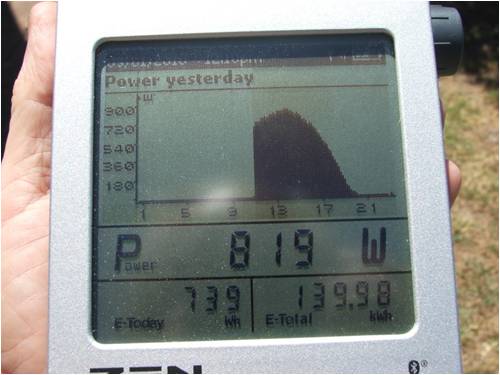

I had a grid tied solar system installed some 2-3 weeks ago.
It is a nominal 1Kw system employing an SMA SB1700 inverter, 6 X 175w monocrystalline panels and a Sunny Beam Bluetooth display.
My concern is with the functioning with the Sunny Beam display which does not seem to show any 'Energy' produced, either on the chart view or the energy display, between the hours of 7am and 11 am on a daily basis.
The display on the SB1700 seems to be functioning correctly at this time with the current instantaneous power, daily energy and total enery being shown.
Only the instantaneous power displays at this time on the Sunny Beam.
When the chart view starts operating at 11am it does not include the power produced from 7am. The total power is not updated until the 'Power Yesterday' display on the following day, although the chart view remains the same.
I have thoroughly re-checked all of the System Settings which appear correct (including Time, Date, TZ etc)
Eventually I resorted to a full reset but this only produced a full display for the first day, after which it reverted to the missing data display.
Maybe I am missing something obvious but I can't find any solution. I have emailed SMA Australia and ZEN but have received no reply to date -anyone experienced similar problems or got any advice?

Today I finally got to speak to someone from the installing company and he admitted that they were aware of a problem with the SMA equipment and that they had been communicating with SMA to get it sorted - so I wait with baited breath!!
My guess is that the new Sunny Beam has a nightime shutdown time in which it processes the days data and that this time period of 4 hrs has not been tied to the timezone and local time data in the firmware program.
Hopefully they will come out with a new firmware update which should cure the problem.

Yesterday I downloaded & installed firmware update V 01.07.06 from the SMA website.
This seems to have rectified the power graph problems although I have not had time to check all of the other functions on the Sunny Beam with Bluetooth unit.
The firmware update was performed via USB transfer of the update file from the computer running Ubuntu Linux with no problems, even though the instruction manual says to use Windows - I thought it was worth a try!!
I'm not sure how long this update has been available as I had almost given up looking since first trying in January.
