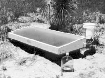

Out of curiosity mostly, I was wondering if 4m members thought it worthwhile spending time and cash on constructing an efficient solar desalination system.
The on-going problem with this sort of thing is most folks merely cover a black tray of water with plastic film, weighted at its center and as saturated water vapor evaporates from the tray, it condenses on the film and droplets of water roll back into a receiver.
Unfortunately, these systems by their design allow the sunlight to pass through the translucent film before landing in the black, water-filled tray, which raises the interior surface temperature of the film and thus, thwarts the process.
This tray/film arrangement is okay if you're dying of thirst in the desert, but for on-going production, it just won't cut it.

[quote]Unfortunately, these systems by their design allow the sunlight to pass through the translucent film before landing in the black, water-filled tray, which raises the interior surface temperature of the film and thus, thwarts the process.[/quote]
Not sure what the absorption coefficent is of water & translucent plastics, but I doubt the sunlight passing through clear plastic and water would heat it up a lot. Of course there will be losses, but whether they justify building a complicated contraption when something as simple as shown below will suffice? I doubt it.

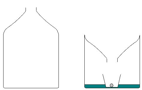

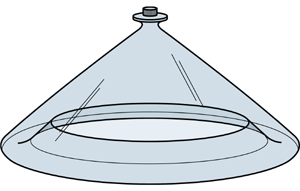

[quote]A better way is to collect and concentrate solar energy, then apply it to a closed system where the evaporator (remember that plastic film?) is replaced by a mechanically-chilled region.[/quote]
Not sure I agree with the better. But it would sure be a lot more complicated than this:
http://www.watercone.com/product.html
Still haven't figured out a decent way to make my own water cone (and buying is cheating), I very much like the elegance of that design. Simple and functional. Any fool can complicate matters....

[quote]This tray/film arrangement is okay if you're dying of thirst in the desert, but for on-going production, it just won't cut it. [/quote]
Refrigeration cycles are fun and everything.... but sometimes the simple solutions may be better - just scale it up a factor n if you want n times more output....

[Quote=Dinges]Refrigeration cycles are fun and everything.... but sometimes the simple solutions may be better - just scale it up a factor n if you want n times more output....
Well, here's the thing: If we "scale up" either of your two scenarios, can you imagine the size of either if we want to say take a 20-minute shower?
I don't know about your lifestyle, but here in the US we waste EVERYTHING including water.
Like I said, if you were dying of thirst, a small contraption like either of those you mention will suffice, but I'm talking about being able to supply gobs of water for an entire family or maybe even a small community.

I came across your discussion while looking for ideas on how to produce irrigation water for my fruit trees from brackish well water. Very interesting indeed. 2 questions that I would like to pose:
1. In East Africa we pretty much have to use readily available materials and adapt them. We have large 5000 litre black plastic tanks that could act as heat absorbers and might serve as the 'dome' for a system such as you describe but without the pressures described.
2. Another resource we have are the large clear plastic 9 litre water containers - seeing the watercone idea, I wondered whether it might not be possible to adapt these 9 litre containers - particularly in multiple banks of them - to act as a kind of watercone factory to provide drinking water for our coastal dwellers. At present the locals have to travel by foot or bike very long distances to collect potable water in gallon containers and anything like a watercone, even if not so efficient, might do the trick. Any ideas?
East African coastal farmer
