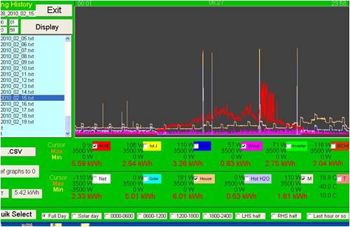

I have a graph, of a low solar day, last week.
We used only 6kWhr in the house, and we only had to buy 1.6kWh.
Even with a few hours cooking with electricity, we only add a few extra kWh. I have a significant credit with my power utility that I have to request a cheque to get reimbursement for.
I have to agree partly with Bruce, in that it was difficult to get the power down below 10kWh/day. If you are not at home, it should not be difficult, but when retired and at home, then it is harder without losing creature comforts.
Gordon.
