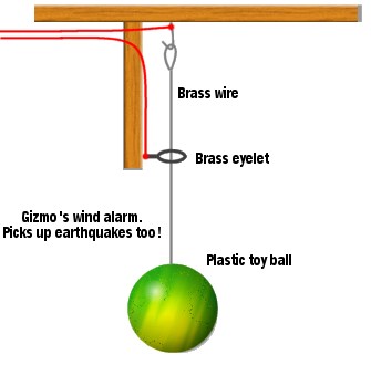

Oh and lastly Gizmo -beauty a simple solution that i think would work but to do what?
Park it in what orientation?
Park it in what orientation? Karl
The desired 'Parking position' is horizontal, 'it' being a solar array on a tracker.
