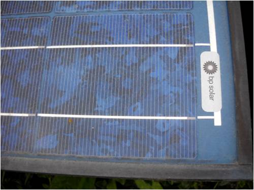

I went to a friend's house today in a neighboring town, Vista, California. Turns out my friend (much older than myself) is in God's waiting room; very ill, etc.
I snapped a few shots of his solar application. This thing is as big as a backyard swimming pool! It sits at the south side of his house (mansion!) at a tilt of our latitude (38.5 degrees I think) and makes electricity whenever the sun's not blocked by clouds.
There are 9 columns of 8 panels each, making 72 panels, which are
each about 3 feet x 4 feet!
Here's just one of the panels in the lower left-hand corner of the array.
That little tag says BP Solar. I'm guessing that stands for British Petroleum,
but it's just a guess.
My friend's days of explaining anything have likely drawn to a close, so I'm not able to ask or get answers to any specific questions about this installation. I do know that it is grid-tied and he gets a "credit" each month instead of an electric bill. The house is on the order of 10,000 square feet, by the way and I'm sure the only reason he's getting that monthly credit is because he's spending his time 24/7 in a nursing home wondering who he is (memory problems!) and not using any electricity.
In California (USA) when this puppy was installed, the state was giving away a state income tax credit, which would after 15 years or so make the thing FREE (or so the story goes--there's always a 'catch' it seems).
That's about all I know. I posted it merely for general interest; hope everyone enjoys the look-see.
. . . . . Mac

Hi Mack
Thanks for the photos and sorry to hear about you friend, I look after Mother with the same problem although I have been able to stabilize her and she is maintaining a reasonable cognitive state without further deterioration for the last two years since I put her on rocket fuel.
Those panels look like BP Solar 80 watt units and with 72 of them that's a serious solar array
Should do around 25kw a day average if its on a mppt grid connect system. He should be getting a good credit on that though if its tax credits and he isn't paying any tax then it may be nothing.
With our system here you get paid 44 cents KWH feed in rate, there are a few companies putting 10 to 30 KW Solar units up now and these give a return on investment of 26 percent better than the bank. $27 a day on a 10 kw system. That,s $8000 a year with a fifteen year government guarantee on the contract $126,000 at today's feed in rate and the way the price of energy is going it could double in that time.
