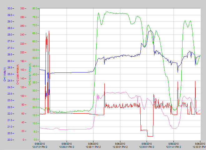

I'm off-grid, and am using a Graphtec data logger to keep track of my 2 PV arrays output, load current and voltage at the moment. You can save the output to csv files to import into Open Office/Excell etc to produce more than the Graphtec software does. It only measures DC, so you need to rectify any AC signals before feeding them to the data logger.
The GL-200 that I use has 10 inputs. I run a 35m multi-core cable from power shed to the data logger in the house, where its connected to a laptop which I also use for my weather station. I have tried using a USB extender, but I had to frequently unplug and replug the USB plug into the computer, to get the connection back, a real PITA.
An image to show what the graph looks like. I'm sampling once per second, but you can go to 100ms if needed.
I have a 7100pixel wide (X 460 high) graph of the whole day I was going to post, but it seems they get scaled to 1000 pixels wide when displayed in here, which makes it a bit hard to see properlyEdited by Loomberah 2010-07-09
