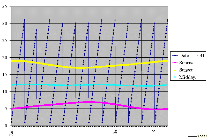

For the solar purists (and the pedantics?) 'Noon' and 'Midday' "ain't necessarily the same thing".
Noon occurs at 12 P.M. Midday is halfway between sunrise and sunset - and can vary by as much as six and a bit minutes - the blue line).
If you promise to meet someone at midday and they arrive a minute or two either side of noon and then leave promptly, they may be there before (or after) you, and neither will see the other.
OK. So it's one of those useless facts you come across when doing research.
(BTW, the chart is for Gunnedah NSW at 30 deg. 50 minutes South.) And the blue dots are so you don't have to remember how ays there are in the 12 months of the year.Edited by neil0mac 2010-06-29

In this case Mac, it's more than six and less than seven. But if you're on the equator it's exactly 6 and 'nothing' as well as at the poles where 'midday last all day for weeks ats a time - and then you don't have one at all ('winter time'!)
Alternatively it's a fair amount less than 'a lot'.
In between those extremes it varies. See http://www.usno.navy.mil/USNO/astronomical-applications/data -services/rs-one-year-us for both US(A) and international data to make your own 'bits' if applicable.Edited by neil0mac 2010-06-30

Don't you mean 'shortest'? E.g. on the equator there is no shadow at all at 'mid-day'.
Just for record, the data I based the graph on is from the 150th meridian, used for setting the EST time zone down under, which isn't out by 'much' - which in this case, is probably less than 'bit'.Edited by neil0mac 2010-06-30

Actually, its over 15 minutes, and is known as the Equation of Time. It's the difference between midday 12pm and solar noon (ignoring daylight savings), and varies over the year due to the Earth's elliptical orbit and the obliquity of the ecliptic.
At this time of year, the difference is relatively small. There are also offsets to apply for people who dont live on a standard time zone meridian... although Neil is quite close to one
Read all about it here: Wikipedia page

I have to ask Neil0mac, which calendar was used to prepare the first graph. My calendar has May with 31 days, but your graph shows only 30. Is this an Excel thing?
Maybe Gunnedah has a different calendar.

Posted: 12:47am 09 Jul 2010
Gordon 1, 'May'be that was an 'august' occasion?
Gordon2, I did notice a 364 day 'year' but wasn't fussed enough to chase the discrepency! The info came from ...
http://www.usno.navy.mil/USNO/astronomical-applications/data -services/rs-one-year-world ...
... imported into Excel and 'massaged'.
Anyone seriously chasing an extra watt or two would probably only make some gain by adjusting their system for the times the year where midday varies by more than 6 minutes (first and third quarters of the year), as 10 degs. off perpendicular has no appreciable loss of irradiation collection.Edited by neil0mac 2010-07-11
In a fixed system pointing North there is no gain to be made by making any adjustments, the sun still follows the same path across the sky and is highest when due North, the time on your clock makes no difference whatsoever!
With a brightest part of the sky tracker, the local clock is also irrelevant.
