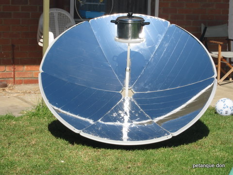

It came on Wednesday (18 days from China) I assembled it this morning it took about 90 minutes and about 50 to 60 bolts.
It seems to work well as long as you have a shadow.
You do need dark glasses or welding goggles to use it but arc welding helmet is too dark

cooked some soup this today started as 10 am frying the onions you really needed to watch the pot closely or you could get a brown spot on the bottom (almost burning)
easily boiled about 6l of soup if it had been on a conventional cook-top I would have turned it down.
cooker need to be re-aimed about every 20 to 25 minutes.
initial impressions are it had similar heat to a 60 mm across gas burner that is about on 3/4 it was a clear sunny day today in Adelaide (26/4/2011)
the pot holder was beginning to sag with a 30cm stock pot about 3/4 full on it.

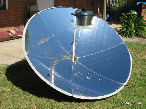

Posted: 02:12am 26 Apr 2011
the cosmetic damage from the freight can be seen on the panel below the cookerEdited by petanque don 2011-04-27

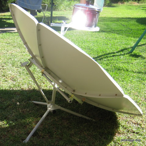

Posted: 02:23am 26 Apr 2011
Another photo

checking the size of the pot it was 250 mm in diameter and 160 mm deep it had about 100 mm of liquid in the bottom.
so my calculations suggest there was about 5 liters probably around 6 Kg with the pot

petanque don
Very Star Warsie; I like it. How much did it cost?
I've tried making reflecting cookers like this and I always spill something on the mirror and botch up it's shine. I remember the first one I made, which cooked hot dogs in less than a minute. I dropped a greasy dog on it right away and it was downhill from there.
