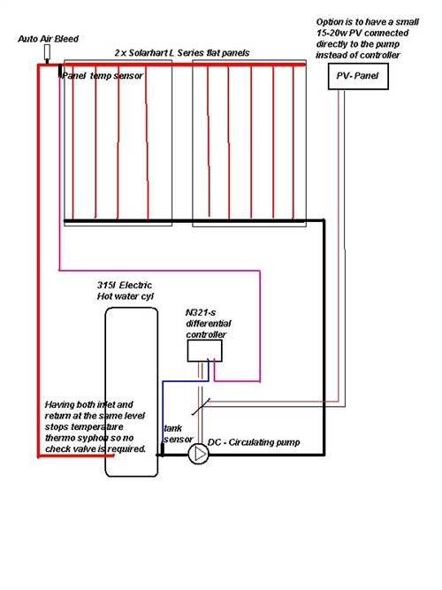

I have been contemplating this for quite a while , in Australia there are thousands of solarhart hot water systems that get replaced each year, of which a lot can be easily recycled with a bit of work and with a bit of hunting you could easily pick a couple up for, at the best FREE or I paid $60 for the 2 from the scrap yard. And with a few other components one can have a very affordable solar water conversion to an existing Electric system and shouldn't take long to pay back as my Electric hot water uses 7~9kW a day.
I have set myself a budget of $400 and I am more down the line of buying components, even with the items I am buying to get the system up and running it will easily come in under that and could easily be done a lot cheaper for the savy out there.
The Solarhart L-Series panel is the one to keep a eye out for as it is constructed with 6 copper tube risers encapulated in an aluminium collecter plate, it is very common and is quite noticable to see the 6 riser tubes through the glass.
The other flat panel K-Series is a pressed steel collecter and is used with a heat exchanger Glycol fluid that has a jacket around the inner water tank, this type is not suited to high pressure 80-100psi that a house/town water system is connected to.

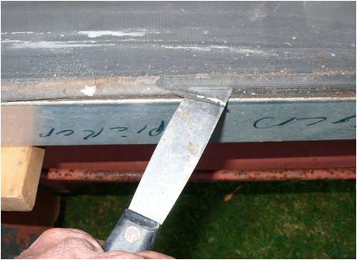

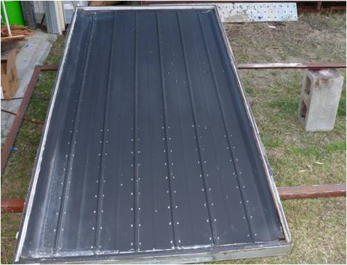

Below are some Pics of the Solarhart L-Series panels that I bought for $60, you would not be able to build them for that, and with the good quality low iorn glass and aluminium enclosure.
Removing the Glass with a scraper as it is assembled with double sided tape. There is an alu angle edge that is easily removed by drilling out the rivits to get to the glass.

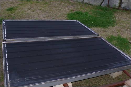

This shows the collecter with the glass removed , this panel is why they were removed as it has a small pin hole in the top tube which can easily be soldered .
Shows both panels , they are easy to remove by removing the corner rivits from one side and bending the side out to slip the panel up and out.
Below is a basic scematic of how I am going to connect them to my existing Hot Water Cylinder

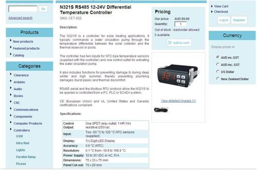

This controller can be powered by 12-24vdc/ac and costs $89 and comes with the sensors
The circulation pump is a 15w model $87, there is also a 10w or 5w model on ebay.
This is a pic of a type of auto air bleed valve which is fitted into the top of the collecter where the hot water comes out at the higest point , angleing the collectors up to that point slightly will help keep air locks out. $30
There are a few other options I could be going with that could be cheaper , like a 10w pump connected directly to a small 15w solar panel that circulates when the sun shines ,it would work just as well , it is best if doing it that way to have the inlet to the pump and the return from the collecters at the same level in the hot water cyl as it stops thermo syphoning, so there is no need to use check valves, but I like the fancy digitial read out flash controller and will be using a 2A/12vdc power supply to power the pump and controller.
As it is a work in progress I will post more pics and info as it comes together, and hopfully some of the sundry items like pipe insulation and a couple of fittings dont blow the budget.

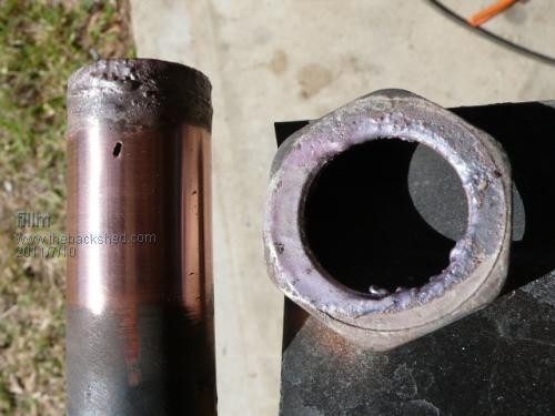

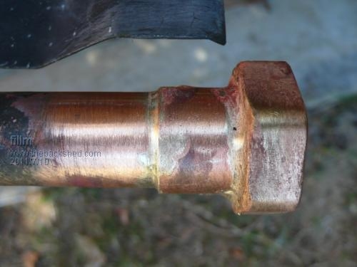

Anyway some progress on the rebuild , the pics below are of the repair job I did on the pin hole . I could have just soldered over the hole but opted to sweat the end off and use 1/2 a 25mm joiner to sleeve the suspect section .
Shows the hole with the coupling sweated off
Repaired , pressure tested and ready to go.

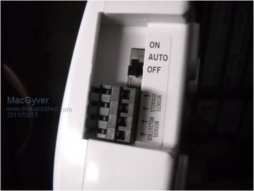

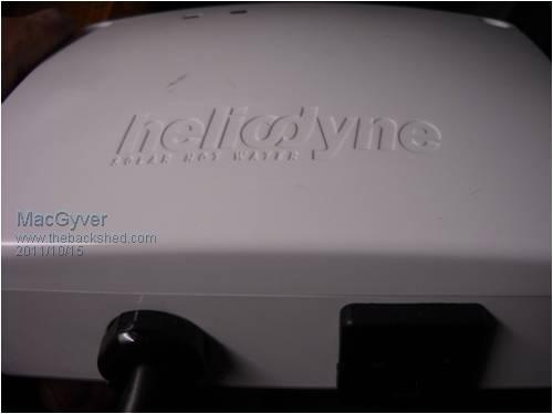

I took your advice and purchased a delta T controller online from altE It was a little pricey, but it's my kids' inheritence, so I won't tell if you won't. Seems to me from memory at least, it was around $125.
I haven't installed it yet. It's a plug and play and the only wires I have to run are the two to each of the temperature sensors. One goes on the solar panel and the other goes on the receiver tank. There's also a feature that runs water through the panels should the air temperature fall below 42*F.
Here are some pics of the contraption:
This is it just out of the box.
The leads were a separate purchase at around $7 each.
"Heliodyne Solar Hot Water"is what it says.
Maybe this will help someone else trying to do the same thing as we.

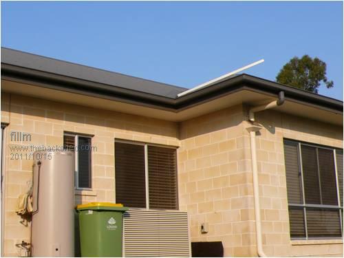

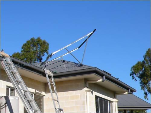

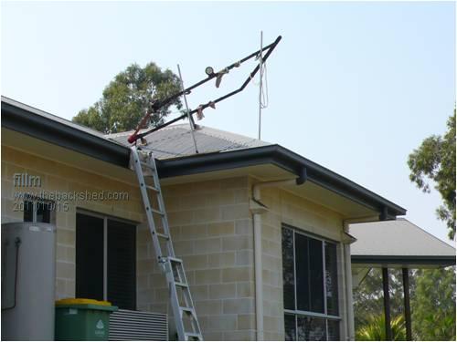

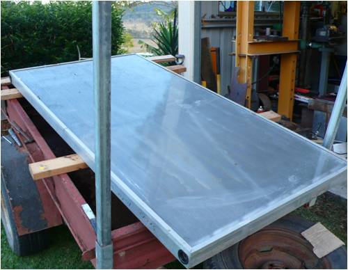

This is where I complicated things , because the roof directly above the hot water system is 45deg east of Nth I decided to face it true north to get the best efficeincy, this brain wave turned out to be bigger than Ben Hur .
Setting up all the angles meant countless trips up and down the ladder which gave the old legs a work out.
The frame up and painted ready for the panels , the second ladder was used to slide each panel up on . Working on a 25deg pitch needs good grip and the old dunlop volleys are like suction pads on your feet .

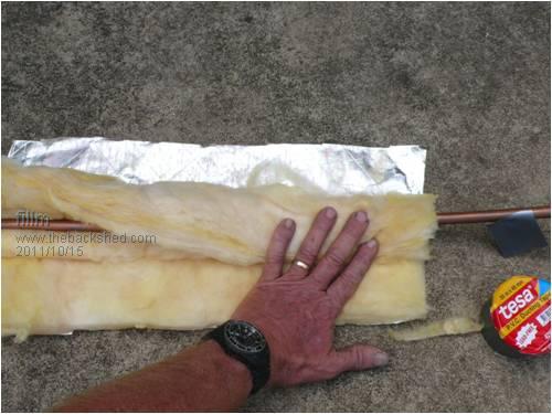

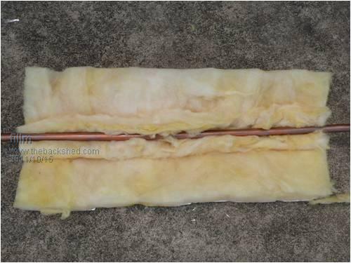

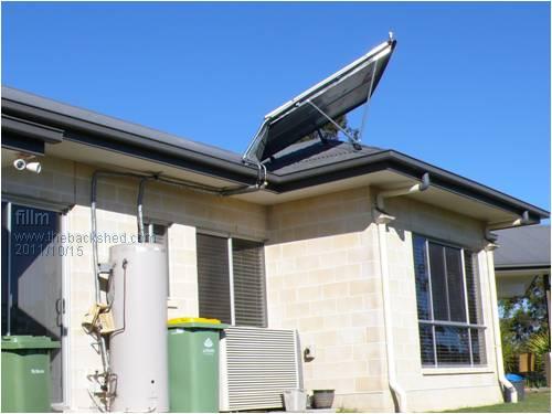

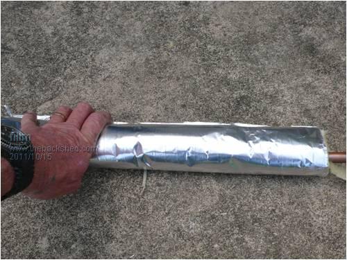

I priced enough of that black foam pipe insulation and it was going to add $120 to do all the copper tube, I scored some left over roof insulation wool from a house being built accross the road which I also used to put a new layer of insulation under the flat panels before putting them back together . I decided to use it to do the pipes as well. Cutting the wool into smaller pieces seemed to work the best and it was like rollin a giant smoke for those who used to smoke . Halving some of the wool layer over and then putting it under the pipe first.
Fold the top wool over leaving its foil and then the bottom wool and foil
Then fold the top foil over and have some duct tape tabs ready to hold it , then wrap it with the duct tape, I think I went through 3 rolls of tape and by the end I was getting pretty quick at it , probably took about 3 hrs to do all the pipe work which was a whole lot quicker than fitting all the pipes before the insulation was fitted . The wool and duct tape doesn't look the best but it sure works!

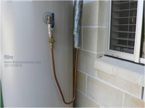

All plumbed up and going , origionally I was told by the experts to plumb the inlet and hot return at the same level at the bottom of the tank ,I tried it but with this tank it could not be done the makers have a tube that seems to join both inlets accross between the two inlets , the hot water coming back from the collecters was being drawn straight back into the pump inlet so I put the return into the spare top hot outlet, this caused a bit of head scraching befor I found that one.
I also fitted a check valve on the hot return to stop thermosyphon at night , I was also told if you put a U in the pipe it would stop this bit it didn't , the check did the job .

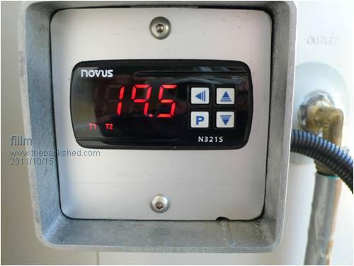

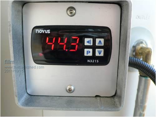

These next three pics are the differential controller taken about 9am and its doing its job
T2 is the inlet temp
T1 is the temp at the top of the collecter
T1-T2 the Differential , when it gets to 20degC the pump turns on and the remains on untill the differential gets to 18deg . I had a lot of problems with temp lag in the sensor at the top at first because of air not transfering the heat to the sensor probe quick enough , it needed heat the transfer gell and then works like a charm .
The controller is fully programable and 20deg is the Max Dif .

Tilting the panel towards the mean pathway of the sun is a good idea. Of course, you know you now have a "kite" on your roof. Please be sure it is anchored as I'm positive its Reynold's number is gigantic!
For a future build, an easy way to keep the water levels at the same height as well as utilize your house's plumbing more efficiently is to bring the hot return to a tee in the cold inlet line, with a check valve in the hot line to discourage back-flow of cold water.
When the system is static and just circulating, the solar-heated water enters at the top of the tank, but flows down through the heater's "dip tube". This is a tube that terminates with an open end about 40% above the bottom of the tank. It's primary function is to deliver cold make-up water to the area of the thermostat, so heat can be switched on. Utilizing the tank's dip tube delivers the scalding hot water from the solar panel to the bottom of the tank and hot water being less dense than cold water will cause it to internally thermosiphon, in turn heating the rest of the stored water more evenly. The cold water supply to the panel should be taken from the storage vessel's drain cock, which is just 5% above the bottom of the tank.
If all you use for heat is solar, it's not enough to "boil out" any minerals, so you don't have to worry about sedimentation clogging up your system, dragging the cooler supply water off the bottom of the storage vessel. The nice feature doing it this way is when the tank finally gives up the ghost and leaks, it can merely be slid out and the new one reattached using flexible threaded connectors instead of hacking apart all the pipes and resoldering them. I always use isolation valves for this purpose, thinking ahead to when I must service stuff.
By the way, leaving just that 3 or 4 feet of bare pipe exposed at the loop shown in your picture is enough to completely screw up your heat gathering efforts. In order for solar water heating to work, all exposed pipes MUST be insulated!
Just a thought for next time.
