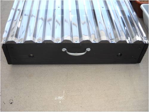

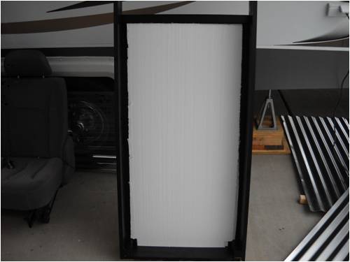

I started out by constructing a long box out of wood. The idea is to cover the box with clear polycarbonate sheeting and use the properties of solar absorption and reflection to manipulate the sun's rays. The goal is to create an internal convection current, which draws in cool air at the bottom and causes it to rise as it gains heat from both direct solar radiation as well as from internally-radiated heat. The heated air passes over the wet articles of clothing, drawing off the moisture and then exits through small holes in the top of the unit. The whole thing operates standing vertically, leaned against the side of my land yacht. Here's a piture of the finished product leaning against my car:
The whole thing measures 6" deep, 25" wide and 96" (8') tall.
Following are the particulars of the build:
The bottom half is backed with luan and painted to retard destruction from moisture. I laid a 1" layer of construction-grade foam wall insulation in first. This will insulate the back of the unit and prevent heat loss from the metal panel in front of it.
Here's the top portion of the unit with nothing but paint thus far. I used flat black latex paint.

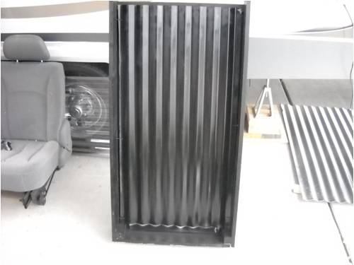

A 4-foot x 23 1/2" panel of corrugated sheet metal (patio covering) is held in place against the insulation sheet using a sheetrock screw driven in from the outside and left overlapping the edge each side; one at the top, one at center and one at the bottom. This shiny surfact will soon be blackened in order that it will absorb heat from the sun's rays.
Here's a shot of the lower metal panel installed in the unit.

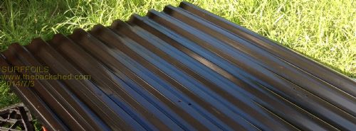

This is that same panel painted flat black. I used spray-on flat black paint.

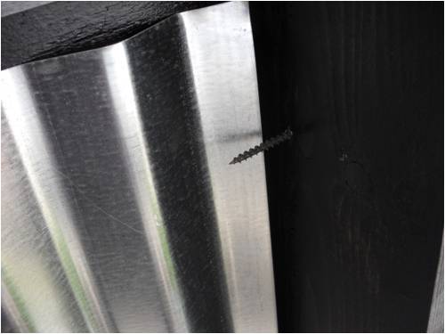

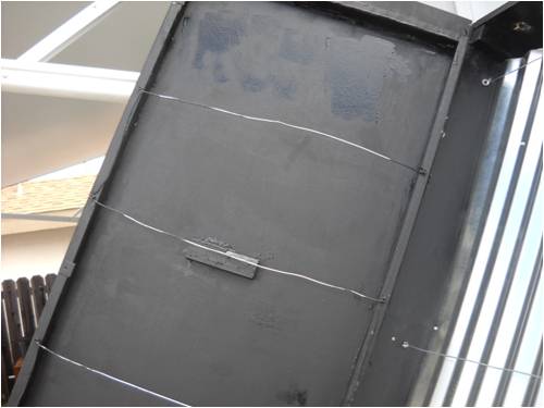

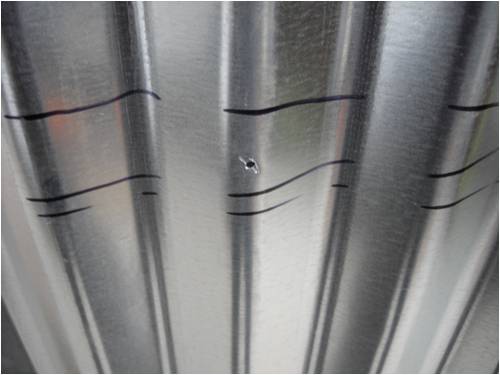

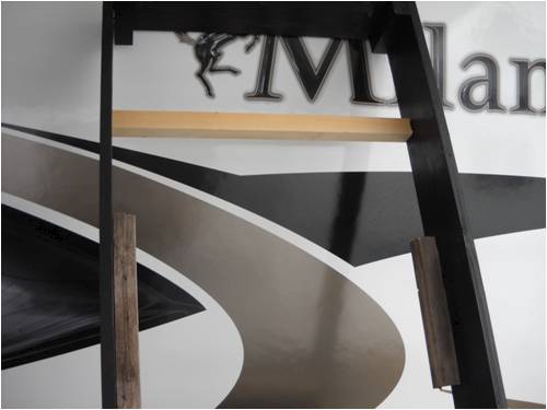

This shows how I marked a line across the upper metal panel after first installing a cross bar (next picture). This is intended to hold the top metal panel off the front of the unit and create a pocket of insulated air. The idea here is to have the bottom panel create a convection current, while the top panel, being locked onto a front insulated air pocket, gets hotter than the hubs of hell and radiates that heat from the still-shiny back side and across the air space behind it. That same air space is also occupied by wet clothing that is suspended on a wire lattice to keep it hanging with a small air space each side. Look at the pictures and it'll all make more sense..
This picture shows that "unpainted" cross member talked about in the previous paragraph. It serves only to hold the metal off the front surface, creating a sealed and therefore insulated air pocket.
This shot shows the top metal panel installed. This side (the inside) will remain shiney so when its other side (painted flat black) is exposed to sunlight, it gets hot and radiates that heat to the wet clothes.

A small metal handle was installed on the top end to facilitate moving the thing around. In a later photo, I'll show you how I've attached two small wheels just a bit above the bottom edge. This lets me rest the unit on its bottom edge while things are drying, but also allows me to wheel the beast around by tilting it back far enough that the wheels contact the cement. Those two small circles each side of the handle are exit holes drilled in the top side. This allows the heated air within to exit to the atmosphere. There are three inlet holes on the bottom side panel that allow cool air in from the bottom thus creating an internal convection current.

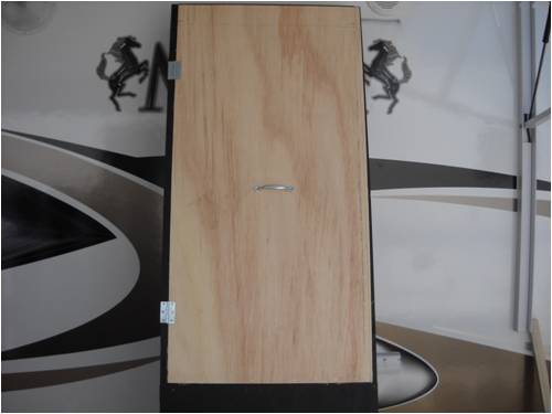

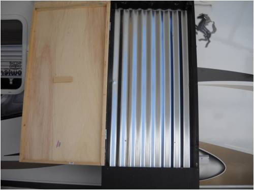

This is the unfinished door to the thing. This is where the wet / dry clothing is placed / retrieved during use. I hinged it top and bottom as well as built an internal perimeter framework to keep it from warping. There is a handy latching mechanism that locks the door closed during use as well as when I move it around; a bent-over nail!
Here's a shot of the unfinished inside door. That block of wood in the center is backing for the screws, which hold another handle to the front of the door's outside. The plywood I used for the door was only about 1/4" thick, so I had to beef it up enough to give the screws a good landing spot.

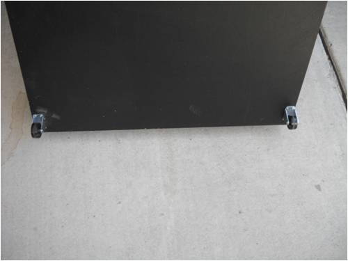

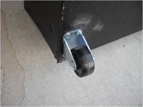

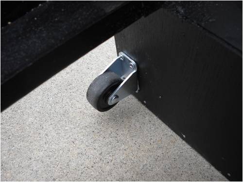

Here are those two little wheels I mentioned earlier on.
This is one up close and personal.
This shows the painted inside of the door. Note the wire latice I installed to keep the moist clothing off the back door. Remember, this thing operates sitting at a slight tilt. I wanted to assure there was an air space front and rear of the hanging clothing to facilitate warm air passage both sides. Also, note the two wires on the right hand side of the picture. These are inside the unit and are there to receive a clothes pin or coat hanger. Hmmm . . . I wonder if a plastic hanger will melt; I'll let you know.

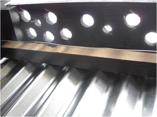

Mac, why not increase the airflow through that contraption? Those tiny air holes look much too small for me.
I also would fit a recycled 12V computer fan at the bottom to push air inside and power that from a small 12V solar panel on the top. Since it only dries clothes when the sun shines on it the fan runs automatically when needed.

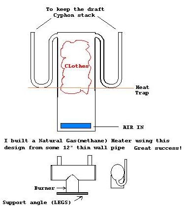

Here's an Idea. Kind of ugly but may work.
-------Cheers, Roe
This was a shop heater in a huge open area, Lots of radiation heat.

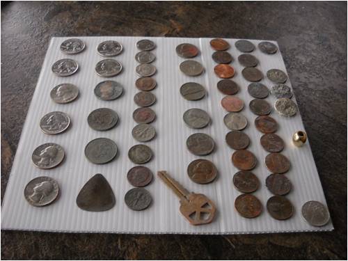

By the way . . . I took Father's Day morning off and went to the beach
with my metal detector. I found a considerable amount of pocket change
and a little clump of gold jewelry!

@ Jarbar: The reason I put the insulation in like that was to create an insulated air pocket. The idea was to make the thing get hot and keep it that way, while the air holes let air flow up the back side. Seems to work pretty well. I was going to "modify" it a bit this morning, but I was forced out of retirement for a friend's plumbing emergency, which took all day! Hey, what are friends for, right?
Anyway, when I get the time, I'm going to make the encapsulated space half the size. That will open up the area behind the hot plate and give more room for more air to circulate. I'm also cutting the thing down to around 5 feet tall. The 8-foot version reminds me too much of the monolith in 2001 - A Space Odesy; it's just too big to work with.

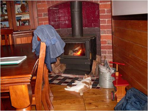

It may not be solar
But at this time of year we dont get a lot of sun.
We have another chimney that runs up beside this one in the next room. I have closed of the tops of the chimneys apart from where the flew goes though and knocked out bricks at the top opening up one chimney to the next. So we get a good draft going up the chimney with the flew then going down the other chimney into the next room. A few cloths horses in front of the fire place in the next room and cloths dry in no time at all.
All the best Dean

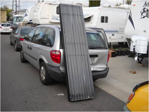

Solar Clothes Dryer Revisited
Thank you all for your comments thus far. I've taken them to heart and made some changes, the most noteworthy being taking Tinker's advice, adding a small 12-volt computer fan driven by a solar panel. Here's what I've come up with:
I've also shortened the thing from 8 feet to 5 feet tall. This enables me to
move it around and store it more easily. Here's a shot of it stored underneath
my land yacht:
Removing just 3 feet of length makes it easier than ever to move and store.

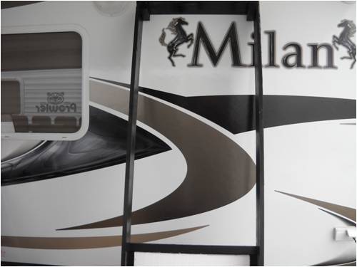

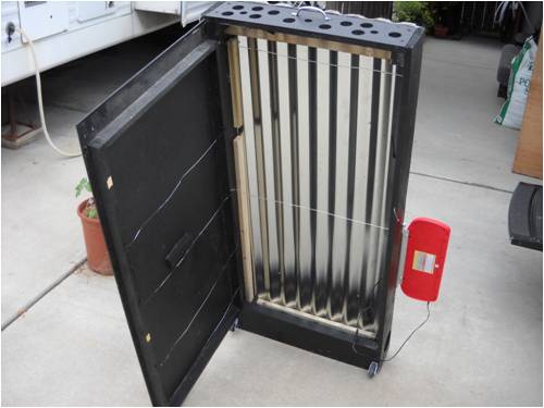

Here's a shot from the back side. The door serves also as a prop and
holds the unit in an upright position for loading and unloading.

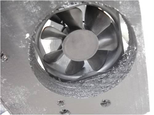

Here's a shot of the little fan, which is mounted on the inside. I took
the picture from outside the box.

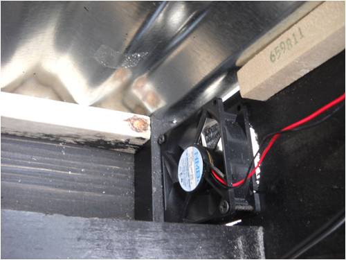

Here it is from the inside. I attached the two wires to a bus plate,
which is mounted above. The wires then run to a quick disconnect
plug that came with the little solar panel ($19 from Harbor Freight).
Here's an inside view looking up through the air-exit holes in the top.
I reattached the little wheels about 3/4" above the bottom. This
position allows me to tilt the unit back to wheel it around yet still
have room to tilt it back onto a wall in a resting position to aim it at
the sunshine while leaving the wheels out of contact with the ground.
The solar panel attaches to the front side with a metal tang that slips
behind a metal bar, which is mounted above the side of the box
forming a little slot. When the unit is stored, the panel lifts off and fits
neatly into the bottom of the whole thing as seen here.

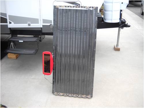

This is a little update based on the fact that I woke up today to almost clear skies and SUNSHINE!
Here, a load of laundry cooks inside the dryer. Running my fingers past
the little holes in the "top" I can feel pretty hot air escaping. That's
what we want, warm air FLOW removing the moisture.

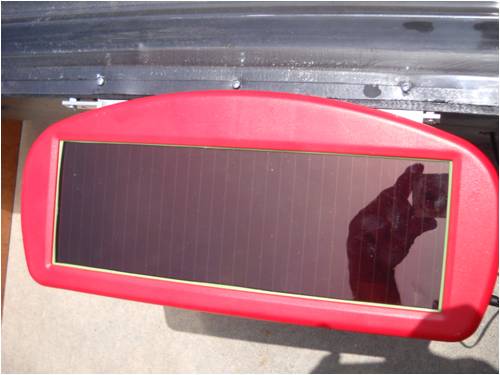

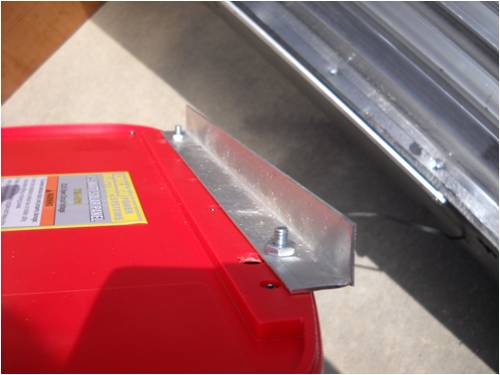

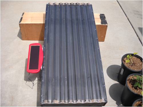

This is a tight shot of the little solar panel I used. I got it at Harbor
Freight on sale.

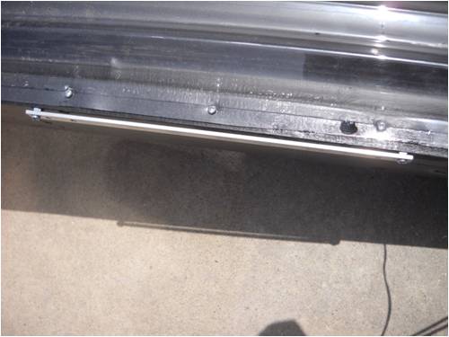

This shows how I drilled holes in a flat aluminum bar, then used a
little nut between it and the dryer housing to create a "stand off" or
slot.
The solar panel came with two slots meant to "hang" the thing on two
screw heads. I merely used those slots and a nut each to "jam" a piece
of angle aluminum stock. This makes the "tab" that fits the "slot" on the
dryer body. It holds it there securely, yet slips out easily when the laundry
is done and it's time to stow it inside. I should mention that I also had
to drill a hole in the case large enough to accommodate the quick-release
plug in order to pass the wire to the inside where the fan is and not
interfere with the door closing; it's a pretty tight fit.

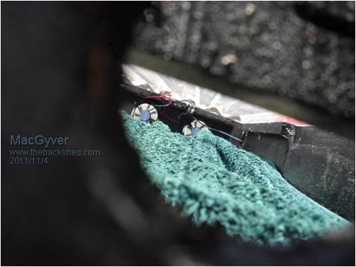

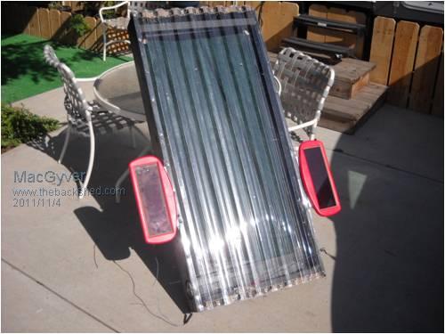

This axial-flux build I'm finishing is beating me up, so I decided to tinker with an old toy. I added another solar panel (12-volt @ 1.5 amp) and wired it in parallel with the existing one. I then removed the single side-mounted pancake fan and added three at the bottom of the dryer. Since the dryer almost always tilts off the vertical, heated air inside the unit rises naturally against gravity and putting the fans in the bottom was to augment that internal flow.
The pictures show my favorite bath towel (green) inside drying. Fresh from the wringer, this towel will be crispy dry in no more than about 3 hours. I have two bath towels, (this is my favorite one cause it's thick and green, my favorite color). It's not like I'm operating a spa and have to hand out towels like business cards.
Anyway, here are a couple pictures so you can see the new fans in action:
This is the original solar clothes dryer with an added solar panel. I
merely prop it against yard furniture to keep it almost perpendicular
to Mr. Sol.
This shot is a peek through one of several exhaust vents cut into the
top of the dryer. My camera's shutter speed was such that it caught
two of the fans' motion and stopped it. These are two of three little
computer fans, each 12-volt. With the addition of the extra solar
panel, these fans run like scalded dogs!
Access to the clothing inside the dryer is through the rear. The entire top 9/10 of the unit is a hinged door. I didn't make it 100% because I needed to leave some stronger structural support on the lower end to hold things together.
As goofy as this project is (at least I'm consistant!) it actually does a very good job of drying clothes. On days when there's not much sun, it still works, but takes a lot longer. There has to be clear sunshine for the little panels to generate enough clean power to run the fans. Once their "threshold" current requirement is made, they jump into action and spin like tops.

Here's the poly sheet painted black. My idea is that if the temperature gets quite high then it should be able to dry a larger volume so I'm making mine about 9 -12 inches deep to hold two layers of clothing.
My cunning plan is to test the system without a fan and see if the heated air will circulate enough on its own to dry the clothes... Hopefully the hot air will rise up inside the front poly wall and then descend down the back so it circulates around the front and back of the box and clothes. I hope to have a system with no moving parts.
Failing that, I will use a very low volume fan to slowly circulate the heated air around inside the box, I'm guessing that there's no benefit in heating the air and then removing it too quickly, so if the heated air goes around a few times it should get hotter and more effective as it goes around.
Failing that, I'll just follow MacGyvers design if that OK with him ?
