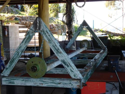

I'm playing again....
Just welding ,grinding,painting and generally keeping busy . I hope it all comes out OK .
Iused to get shading with my old elevation/rotating frame ,so decided to give the u-beaut "follow-the-sun" type a go ..

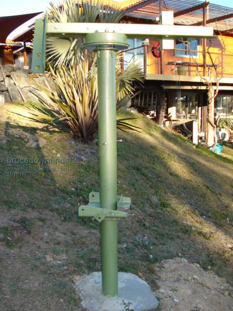

Posted: 09:29pm 28 Jul 2011
Yes, A couple have noticed the lack of side bracing.. I've allways intended to add these, just that I've got to get a "aroundtoit" ...
took the trailer down the hill yesterday and got some concrete blend ,so we're in business again..
I'll have to weld up a split 4inch pipe piece with side clamping flanges .
The ground is fairly rocky , so thats in my favor also.
My windgennie anchors are "deadman" style and backfilled with concrete/rock . They ain't goin anywhere fast.

On the question of mounting the pole in the 'rock'. My structural engineer made be embed the pole 600mm into a 600mm diameter hole 2.2 M deep - but in soil.
The 'lift' from a strong wind is very large and his main concern was 'friction' between the mounting and the soil. (Maybe, you could make your rock hole 'bell shaped' at the bottom? Just a thought.)

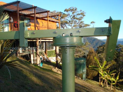

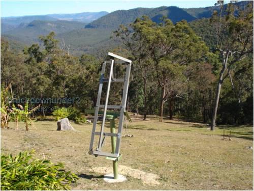

Posted: 04:00am 08 Aug 2011

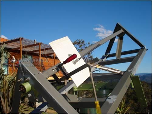

Got around to fitting a bit more steel together - the axle is mounted ready for the solar panels . Then the job of fitting some actuators and cabling ..
Close up of the 3.30pm angle ,,turning out OK , so far ..
Bruce

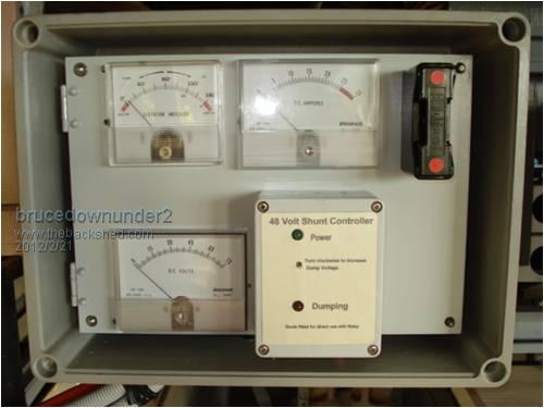

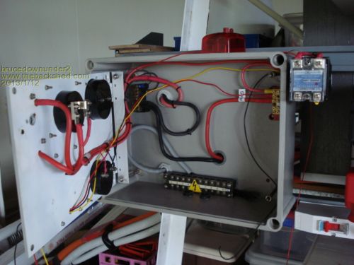

Hi Crew ,, Just an update on the tracker project ...
Have sort of nearly finished the input "look and switch" control panel ..The 48v regulator was designed by Ross W and built by Bryan .Thanks .
The panel frame is progressing ,have added a very strong back brace and am nearly ready to mount the panels --the actuators will come later .
Bruce

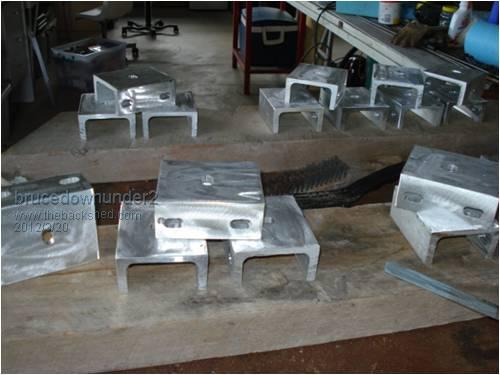

Hi Bill ,, She's coming along pretty well ,been busy doing the other 3765 things that have not been finished around here. But no worries,thats just me..
Cut up some AL channel I had laying around for the last 15 years into 100mm lengths for support pads for the panels .. I decided to mill the 8mm holes out so I would not have to remove them if the holes are slightly out ..
there are 4 panels of 220 watts ,so I had to fabricate 16 of these brackets ..
next is the etch primer and then epoxy painting --want all the structure well painted and no maintanance for many years.
The mounting is next then the actuator arms to control the movement of the frame..
Bruce.

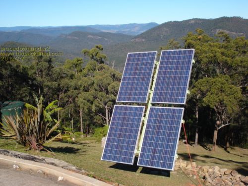

Posted: 11:15pm 21 Jun 2012
Hi Crew ,,

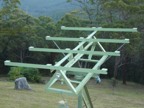

just did a bit more towards the solar panel mounting on the frame --I'm slow at these things , have a hundred jobs being done around here between bouts of very painful gout ... 67 you wait --- don't laugh!!.
OK, painted the Al mounting feet to go no the steel rotating frame -milled out the mounting holes for some "play" in bolting them on . (Bit hard mucking around up there on step ladders with a 3/8 inch drill into 1/4 thick steel)
fitted them after drilling all the required holes in the frame steel ,,in the workshop with my press drill,,.
3 coats of paint and I'm out in the paddock again ready for helpers to man-handle the solar panels into position on rubber insulating washers and stainless steel bolts.
Bruce
Bushboy
Posts: 5203
Posted: 03:01am 22 Jun 2012
Yeah you cant rush these things Bruce
One thing, is there any change the panels will be flexed? I once had a panel that was mounted on a frame that bent in the wind, twisting the panel, and ended up cracking a lot of the cells.

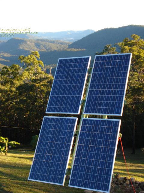

Posted: 12:04pm 07 Jul 2012
Hi Crew,,
Well, finally got the panels mounted with some help from neighbours,the fixing bolts and nuts were difficult to fit-my mistake in the preparation of the mounting blocks.
It's very rigid , and yes Glenn, I will be fixing side braces . There is 900 watts swinging around there , I don't reckon any more panels would be wise..
Working on the inside control bits and pieces now, have to be carefull,50 odd Vdc is a bit dangerous.I just don't turn the breaker off , I disconnect the supply in lead.
Now for the actuators and additional post to support them -more concrete and digging ,will it ever stop..
Bruce
