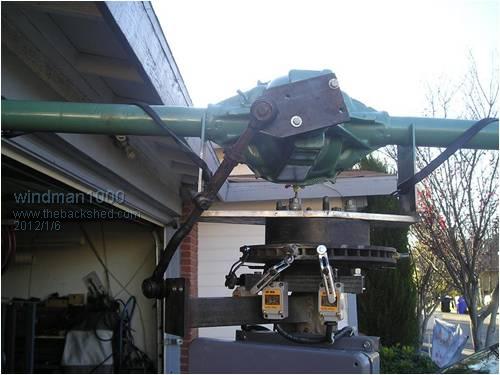

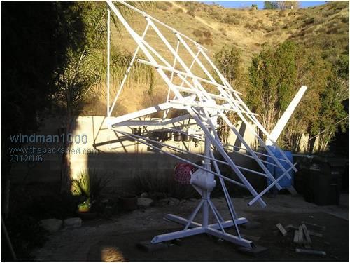

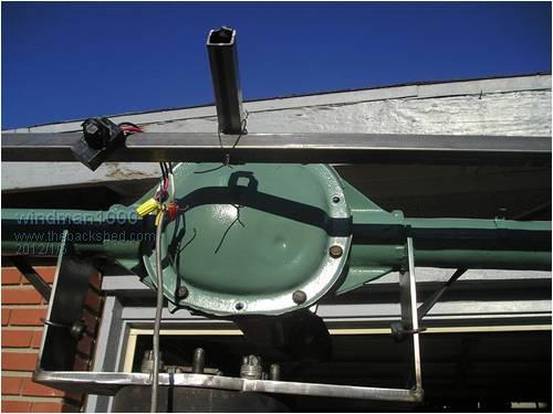

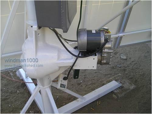

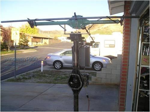

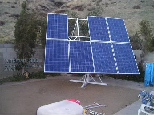

Hi guys, Well my homeowners made me take down my windmill so I decided to go solar but my roof angle is way wrong for my sun direction.
After reading about using car axles for gear box and stand I decided to build One.
and not use DC controller, I put together a AC timing tracker that uses a sunlight eye to start it and turn it off at night, Thinking on adding a sprinkler timmer for the cloady days. This is grid tie only no batteries.
This unit works well it starts up when sun is derect on my eye that is in a 6 Inch long tube, I have a nother 6 Inch tube that I can see the sun light threw it on one of the axles so I know Im pointed right at the sun.
I only have 7 panels at this time but going to get an 8th one soon.

Jarbar
Joined: 03/02/2008
Posts: 225
Posted: 09:32pm 05 Jan 2012
WINDMAN1000,
what a fantastic construction using old car parts.Never have they been put to better use.Looking forward to your results.
Anthony.

Nice work Windman ...

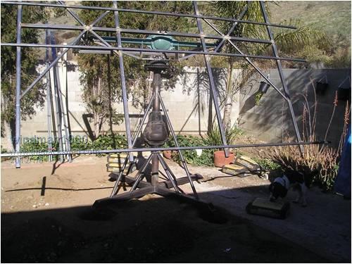

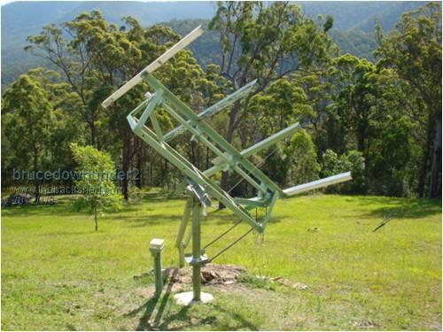

I like your timers and the idea behind it. I'm sort of nearly ready for something like this ,maybe we could work on that..

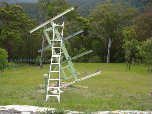

I have underground conduit containing a 12 pair multistrand cable for actuators ,Etc
The steel is 70mm equal angle ,hot dipped gal, very heavy construction with solid backstays and deep foundations.
Best of luck with your project.

Thanks Mac,,
Sort of imagine what you are thinking --like the principal of those parabolic mirrow dishes with the focal point collector heating water to steam ??
I'll keep an eye on this idea..
Bruce

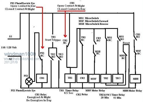

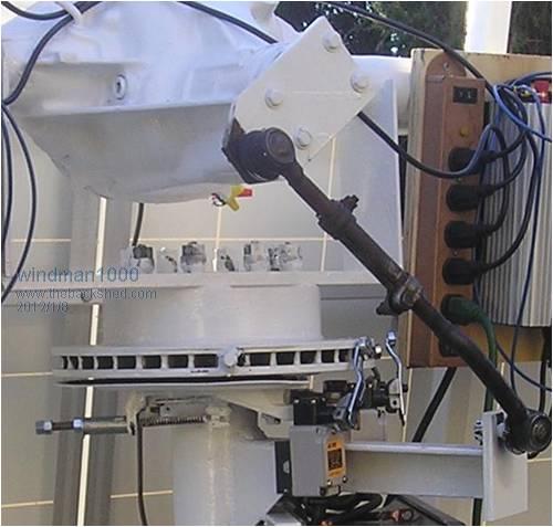

Thanks Anthony And Bruce

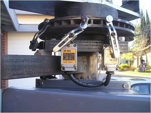

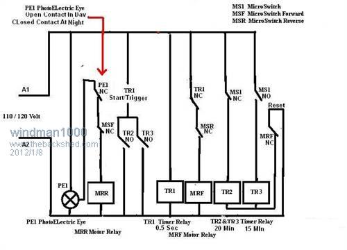

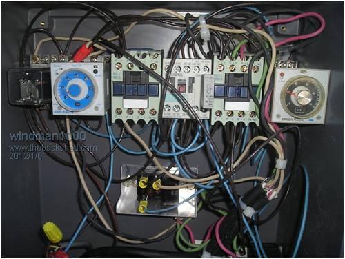

Bruce I dont know if this will help you but heres the electrical, Im only running one motor that turns my panels from left to right 90 degrees and up /down in steps every 20 mins then at noon it switches timers and runs in steps every 15 mins for about and hour then switches back to the 20 min steps.
I raise and lower the panels with the top axle tied to bottom axle with tie rod so as the top axle turns left to right it also pivots it up to noon then back down to night.
Or More Simple

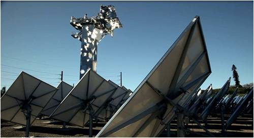

Have a look at "heliostat" on Google or "heliostat diy" or something similar.
The sun wobbles about the sky quite a bit over a yearly cycle, so optical tracking is the easiest option without resorting to precise software algorithms. Although Sooty the cat may start to resemble his name if the mirror has a wander on a cloudy day. It is possible to accurately hit a very small target from quite a distance.
HOT Googling tip! If you are looking for something and having no luck with different combinations of search words, try GOOGLE IMAGE (that's the next option down from EVERYTHING) works a treat, provided you are not easily distracted by pictures of shiny things! Edited by yahoo2 2012-01-15

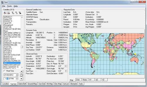

Posted: 03:55am 18 Jan 2012
While making something to directly follow the sun is not all that difficult.
Getting a mirror to reflect the sun to one particular spot is a lot more complex.
And getting a tracking mirror to locate both sun and target way beyond anything I can visualise.
I know that this can be done, but how exactly ?
What is the basic principle?
neil0mac
Joined: 26/12/2009
Posts: 210
Posted: 06:50am 18 Jan 2012
I know that this can be done, but how exactly ? What is the basic principle?
It could be possible IF the mirror anchorage (mounting) point can be moveable (also wobble') in relation to both the collector AND the sun. Very complex mathematics and mechanical set up, I would think.
yahoo2
Joined: 05/04/2011
Posts: 1166
Posted: 01:12pm 18 Jan 2012

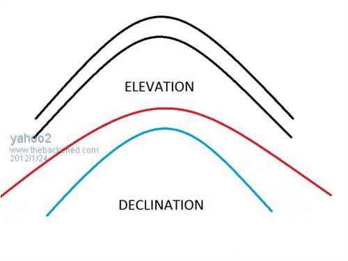

optical heliostat tracking
The most common method that is used today is called "target aligned tracking". Basically the axis that the mirror rotates around is pointed at the target so the mirror is always at the same ascension angle as the sun (rotating around the target).
For the other axis (elevation) the angle between the sun and the target needs to be halved so a cam or gear is used, similar to a reduction drive, on the optical sensor mount, to keep the mirror at half the sensors angle. Aiming and calibration is fairly simple by adjusting the tilt and angle of the sensor.
The big guys are pretty secretive about this stuff and pretend it is rocket science, I have some very detailed photo's but I may get leaned on if I post them.
the best I can do without boring everybody is direct you to Heliotrack.com. This kit shows a sensor drive bisector quite well.
Most other mechanical tracking techniques, like polar mounts, need seasonal declination compensation, it adds to the complexity.
Posted: 10:54pm 20 Jan 2012

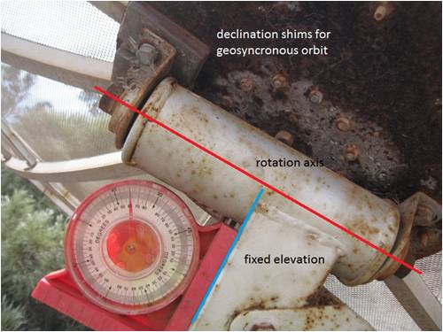

I reached a similar conclusion myself, and am working on a very small scale "toy" working model of a two mirror mechanical sun heliostat.
The basic idea I have come up with, is to construct a mirror rotation axis that runs parallel to the earths rotation, that rotates exactly once every 24 hours.
That in itself would track the suns movement across the sky.
No need to reverse the drive, it always points at the suns position, even when the earth gets in the way at night.
It should follow the sun during the day, and continue to rotate at night, and be in exact position at dawn to anticipate the rising sun.
A mirror is then attached to this rotating axis inclined at a fixed 45 degree angle, so sunlight is always reflected back along the exact axis of rotation.
A a cheap 24 hour mains timer, the type with the rotating dial on top into which you place pins, to switch things on and off will be used as my mirror rotator.
A wooden wedge cut at 45 degrees will be hot glued to the top, and the mirror hot glued to the wooden wedge.
I should be able to direct the suns rays to a fixed point on the ground (due north of the mirror) by simply elevating the mirror axis of rotation to be the same as the earth's axis of rotation (as it is in this particular month) and pointing due north.
Once I have my rotating mirror elevation axis and due north compass bearing sorted out, a second fixed mirror may then be able to direct the sunlight to wherever it needs to go. Edited by Warpspeed 2012-01-22

Posted: 06:32am 21 Jan 2012
Frustratingly it's been overcast/cloudy here in Melbourne nearly all day, so not much chance of really seeing anything happen.
But it is set up, and sitting outside ready waiting for some sunshine.
There will be two initial aiming adjustments to make.
Rotating the compass heading of the whole mechanism for due north, which should have the effect of introducing a horizontal sideways error of where the beam lands throughout the day if there is any departure from true north.
And setting the elevation of the rotational axis. As we have just passed Summer Solstice (Dec 21) the sun will be about 20 degrees higher in the sky than the latitude of Melbourne which is around 38 degrees. So my axis of inclination should be about 18 degrees above horizontal. If there is an error the beam landing point will move higher or lower throughout the day.
I have set the 24 hour timer to read one hour slow, because of daylight saving time.
My mirror should be horizontal facing up at 1pm (solar noon), and horizontal facing down at 1Am. and vertical facing the two horizons at 7Am and 7Pm.
A few days of observation and some minor tweaking should, I hope, get me fairly close to having a stationary beam landing point on my target.
The whole thing is a bit rough and hastily thrown together, but at this stage I just want to prove to myself that the theory is sound, and it is indeed a workable system.
I am not looking for ultra precision in aiming, just something encouraging enough to maybe take it to the next stage.

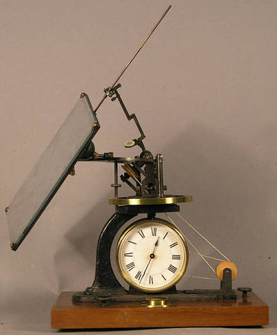

Or you could buy one
Something like this 1860's stoney from Spencer and son would set you back $7000 or more.
but you would have to move your home as the axis angle is fixed for one latitude, sorry.
