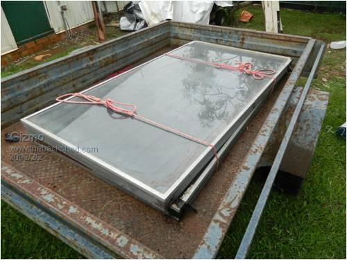

A visit to the local tip shop and I scored a couple of panels for $30 each.

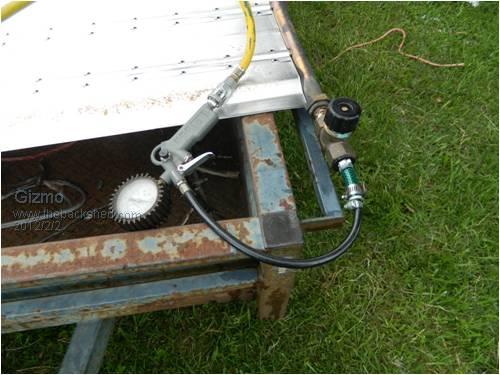

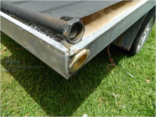

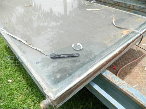

I can see some green copper corrosion around the copper tubes inside, meaning there has been water in there. But I also noticed the last owner had smeared silicon around the bottom edge of the glass panel, as though to stop water getting in. So was the water leak from the copper pipes or rain getting into the panel. Removed the aluminum frame and glass. Tip, if your working outside, even if its overcast, dont put your hand on the black panel after you take off the glass, its bloody hot!
And then drilled out a few pop rivets and lifted the copper array out of the case.
Used a wire brush to clean off the loose paint and green corrosion, the copper seams to be OK, so set it up for a pressure test. First I filled the array with water, making sure there were no air pockets, and checked for leaks at normal water pressure. All good, so I used compressed air and brought the system pressure up to over 100PSI. Again, no leaks
I'll test the other panel tomorrow.

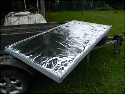

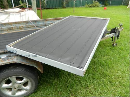

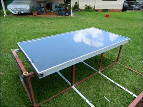

Progress on the panels.
When I removed the core, most of the reflective aluminium under it came apart, so I added some strips of kitchen variety al-foil on top of the fibreglass insulation.
The core back in place and ready for the glass.

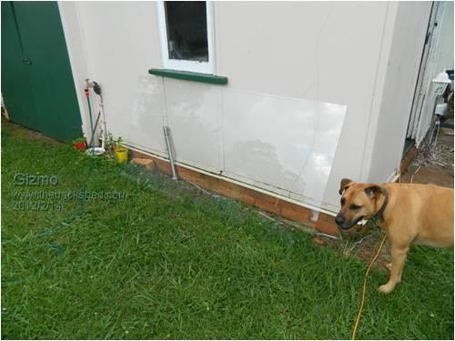

Cleaned up the glass, both sides. Cant see it? Did a good job then didn't I
Finished panel.

Posted: 10:09pm 14 Feb 2012
Hi Glenn
This is recycling at its best from potential scrap or land fill to a fully functional unit again.
All the best
Bob

Posted: 09:42am 23 Feb 2012
Looks great.
What are you going to do to make sure it is water-tight?
Is silicon enough?
I thought about something like that as pre-heater for my gas hot water system.
What stops me is that solar panel can effectively boil the water and I am scared to have hot water at different temperatures depending on time of day/night or season summer/winter.
Is there a thermostat/mixer that I can put in to always have the same (45 deg C) water temperature irrespectively of what water temperature is inside the tank?

Posted: 09:03pm 25 Feb 2012
Georgen just go to a plumbing supply and buy an orange cap mixing valve they are required by law anyway on all new hws in australia

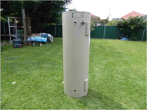

Today I picked up the tank. $220.
Its a DUX 315 litre tank, with 2 inlets, 2 outlets and 2 heater circuits. The elements and thermostats test fine. I removed all fittings, including the sacrificial annode, and hosed the insides with the garden hose. I'll replace the annode as a maintenance measure.
Pretty happy with this, should get a few years out of it and its a good size.

Posted: 11:43pm 13 Mar 2012
  Gizmo said   Today I picked up the tank. $220.
Hi Glenn
Good pick up for that price.
Annode replacement is a must & if you want to keep the system for the rest of your life; it's worth replacing the annode every 2-3 years, I replace mine at around that time mark & my Solar Hart is now 32 years old & narry a problem, the annode not only protects the tank but the pannels & copper pipeing as well.

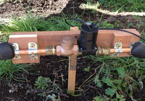

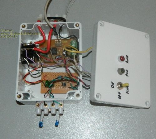

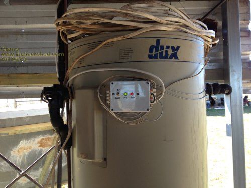

Yesterday I started on the pump controller. I'm modifying a PicAxe based pump controller I build a few years ago http://www.thebackshed.com/Windmill/PumpControler.asp.
To measure temperature I'm using a couple of little NTC thermistors from Jaycar, part number RN3440. These are very cheap, and measure about 10k at 25 degrees C. One will be mounted at the hot water tank and the other at the panels. The software in the PicAxe will compare the two readings and switch on a relay when the panel temperature is a few degrees hotter than the tank temperature. It also monitors the battery ( 12V supply ) voltage and shuts down for 30 minutes if its below about 11 volts.
I'll write it up as a different posts when its all working and tested.

Posted: 03:47pm 17 May 2012
Hi Glenn,
The hystersis value will be dependant on where you put your tank temp sensor.
With a low differential temp of 2~3 deg you will need to be measuring temp at the top of the tank, or you will be cooling the stored hot water at the top . It will also cycle the circulating pump at a higher frequency.
I have my tank sensor on the outlet of the circulating pump which is the lowest tank temp and the diferential temp set to 20deg , this then ensures hot water that is feed into the top of the tank is not to much lower in temperature and does not dilute the stored hot water with luke warm water, and keeping the hot at the top ready for use.
The other problem I found with the temp sensors is the lag time in temp drop and mainly at the top sensor, keeping the pump on and allowing cool water from the collecter again diluting the hot stored water due to the sensor not being in direct contact with the water , after a bit of modification and some heat transfer liquid all around the sensor the problem was fixed .
The modification I did to my existing electric hot water system to solar has reduced the power usage for heating water to almost nothing . Prior to the mod in average I was using 60kW/H a week in off peak power ( 3120kW/H per year ), since doing the mod in Sept last year to now I have ony had to turn the elements on a few times which has used 153kW/H to date ( approx 4.5kW/H a week). This is with using Hot Water for laundry/dishwasher/teenage son who likes 20min hot showers and all the others thrown in .
Posts: 5203
Posted: 03:04pm 19 May 2012
Thanks Phill
To reduce the lag I was going to use a old trick I picked up when fitting electric radiator fans to speedway cars. I'll solder a 30mm long length of 8mm copper pipe to panels 19mm outlet pipe. One end is closed off, I squeese in some heat transfer compound, then slide in the sensor and cable tie in place.
I'm wondering about the air bleed valve, if its really needed. If I pump water into the panels bottom inlet pipe, then its going to completely fill with water, no matter how much air is in the system. The only air that could get stuck is after the top outlet, where the pipe turns down. Thats not going to be a problem, and besides a air pocket will stop syphoning at night. If I have a check valve on the pump, then when the pump is off, the water level in the panel will stay at the top, and not creep back down, exposing the panel core to air. I know a air bleed is only about $40 but the money is tight and if I dont really need it then I wont buy it.
If it was a system that relied on convection instead of a pump, then I could see the need for the air bleed.

Posted: 04:22pm 23 May 2012
Hi Glenn,
I would say that you will need the air bleed valve because over time the water will "gas" out, or inother terms it will expell o2 into the gas state, as well as other gasses if it is contaminated.

Posted: 12:14am 26 May 2012
glenn dont waste your money on a avv for your solar you dont need them on a pumped system sush as yours

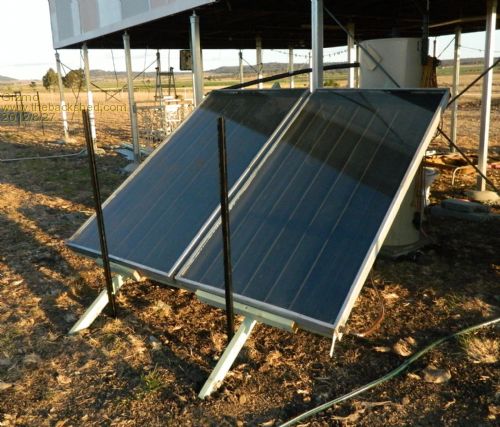

I've moved into the new house and needed some hot water, its cold here! So I connected up the hot water tank and wired up a power lead so I could heat it with my generator. The tank has two 3500w elements, one at the bottom for heating the whole tank using off peak power, and one at the top for heating 50 odd litres as a top up. First day, used the top element, took the generator about 30 minutes before the tanks thermostate switched off. That gave enough hot water to wash some dishes and have one shower, and that went cold before I finished
Next day I connected the generator to the bottom element. 2 hours later it was still running, so shut it down and had a tank full of luke warm water, better than cold water I guess. I worked out I needed to run the generator for 1.5 hours each day to keep this water luke warm Thats a lot of fuel to give me warm water!
I needed to get the solar panels working. Built a basic but secure frame from timber, fencing wire and some star pickets, and mounted the solar panels. It's set up as a syphon system with no air pockets, and I'm using a gate valve to turn it off at night. Its works a treat End of first day I had half a tank of hot water, next day it was full. A full tank will last me a few days if its overcast.
No leaks in the tank or panels. Next step is to mount the panels on the roof of the house, but that will be a few months away, got some other jobs to finish before then.
