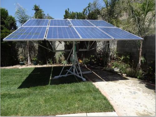

Hi guys
Well Alot has changed sense my last post last post
I was using a timer to control my solar panels.
Now I have made up a sun tracker with a picaxe 20m2 chip , it can be used with glenn's piclog2 piclog2
It works the west to east and the up and down, at night it turns back home (east) and goes up ,just in case of high winds at night'
It also has a wind indicator so if winds get to high it will go where ever you want it to, I have it go up so it flat.
Its easy to build and programmable ,software
here is the code , you can use this as a tracker only or tracker and wind mill logger

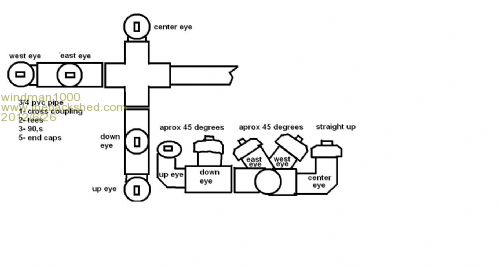

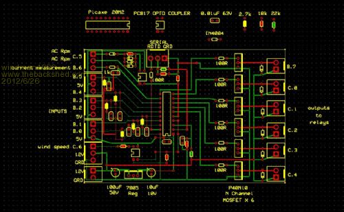

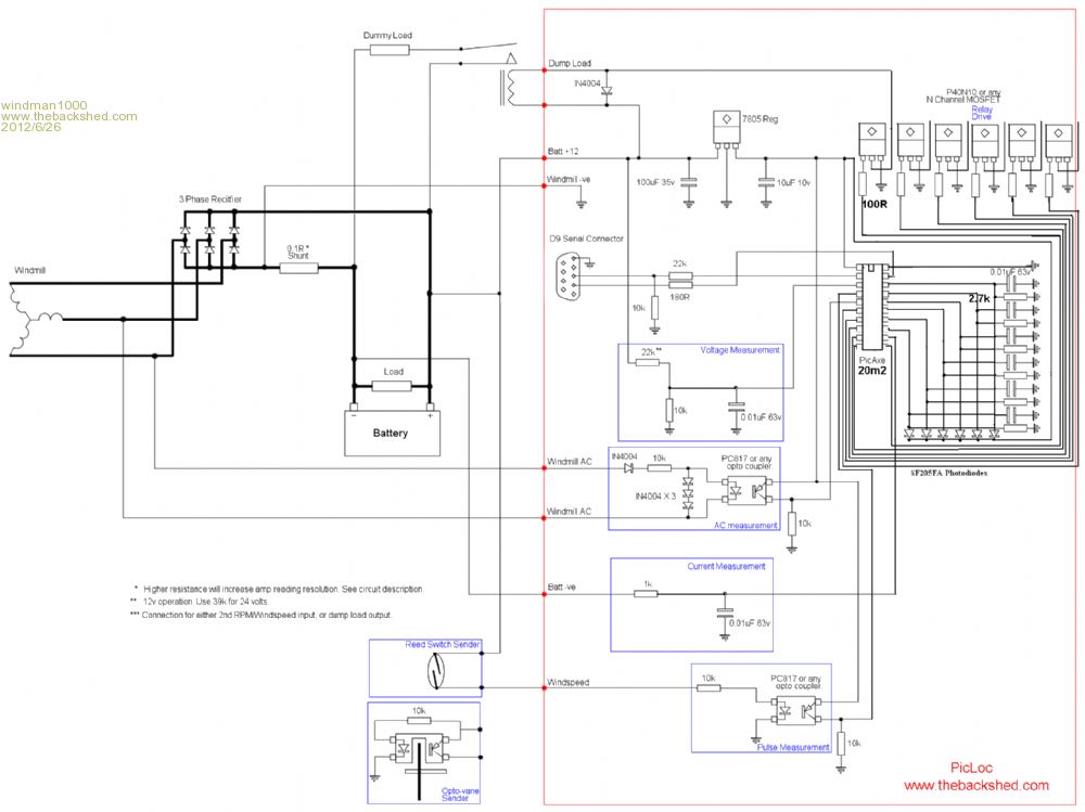

here is the circuit
And here is a modified piclog circuit
And a drawing on the eye setup
hope you guys like it

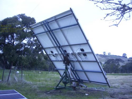

I'm about to fit the actuators soon, the panels are up and all is rock solid -the weather is crook at the moment,so I'm finishing off some hard wiring to the battery banks..

I should mention that the photo diodes (eyes)are SF205FA photo diodes NOT LED's
I have not tested LED's as the eyes so I do not know if they would work as well, IF you try to use any thing different than SF205FA photo diodes the 2.7 resistor at the ADC might need to be changed to a different size resistor, The best way to test is at 12:00 noon in the summer time and no clouds , your com data number on the center eye or a eye that is pointed straight at the sun should not be more the 230, 255 it the max number and you will be out of range.
The reason I use the SF205FA photo diodes is to see threw the clouds ( it kinda works ) to where LED's Wont.

I took my dads concept of a center eye and outer eyes (SF205FA photo diodes)
and look for a picaxe chip that had at least 5 ADC inputs and at least 4 outputs
and found the pic 20m2 to have all that plus.
Then I took Glenn's piclog print and modified it to meet my requirements, then I got some help at picaxe.com on the coding and here we have it.
If you don't do electronic I would build one for you but for testing and everything you should have someone close to you help build it and I would answer any questions that i could.
At this time im testing LED's and it looks like they would work but the 2.7k resistor is way to small.

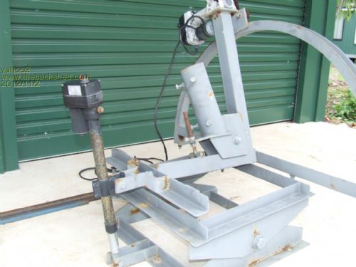

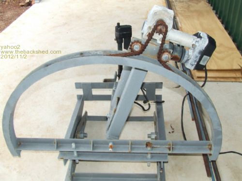

i use one linear actuator for the movement up and down and it is 120v ac , i run it threw 2 relays from my picaxe board.
i bought this from ebay.
west to east i use 2 gear reduction boxes and a 120v ac motor ,i run it threw 2 relays from my picaxe board.

i have added in downwinds CT circuit but i think i did something wrong my amp gain is to much between 0-15 amps , i get 0amps=0 11amps=22 so im still playing around with this thing.

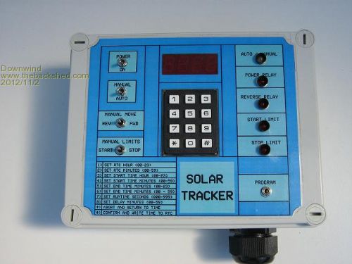

Quite simply the sun travels an arc, so precisely you can set your watch by it, to me it makes perfect sense to use time to rotate the panels by, this is far easier and more reliable that photo sensors.
I have built a few solar trackers now and all use time to adjust the panels by, in most cases a small tracking adjustment every 15 minutes is more than enough.
As for the CT problem, you do realize the CT only works on AC power and not DC that the panels make?
Pete.

There are a few ways to track and all seem to be good in there own way , my started out as a time tracker but i wanted to track the best sun with out making any adjustments to timing at all and this picaxe works great for that with the photo diodes.
plus i have a wind monitor on it and it can move the panels out of the wind and then right back into the sun when the wind dies down.
and i wanted to be able to log wattage's all from the same tracking board with out a million parts/resistors/diodes/ect...
as for the CT my plan was to use it at the output of inverters AC line so i could log the daily output wattage, i like your idea of the CT and im sure i built it wrong or something, let me clear up what it is doing at .5 amp i get .5 amp at 2 amps i get 3 amps at 5 amps i get 7 amps at 11 amps i get 22 amps and i check this with 2 clamp on amp meter.
and yes im lying to the picaxe voltage input ( my input is a steady 12.7 volts but i adjust it to say 120v )

[quote] ( my input is a steady 12.7 volts but i adjust it to say 120v ) [/quote]
What input is 12.7v to where and how??
All current devices will have some error factor across the full scale, Allegros do, shunts do, CT's do, often its compensated for the error.
The CT should read close to linear but again not perfect, the main problem is the opamp works from 0v up to rail voltage -1.5v (or 5v - 1.5 = 3.5v ) its not a huge range to work in, and then that is limited by a 10 bit ADC reading with the picaxe.
From zero to 3.5v we have around a max count of 700 in ADC, then add in integer math only, and a slippery slide in accuracy can take place quickly.

windman1000
Joined: 21/06/2009
Posts: 91
Posted: 05:39am 31 Oct 2012
hi pete
the 12.7 volt dc is what i run the picaxe board threw a 7805 reg, in glenns piclog i adjust the dc voltage to 120v so i get the right wattage threw the CT to log watts on glenns piclog.
hi Tinker
one of the biggest reason i went from timing tracking to eye tracking was when it is hazy / cloudy the best sun is not directly at the sun threw the clouds the photo diodes i use ( not LED,s) find and track the best sun/wattage, don't get me wrong i did like my timing tracker but it was not as good as my photo diodes tracker for over all wattage in a day with clouds,and it tracks perfect up / down / east / west when the sky's are clear, there are times when there are heavy clouds out and the tracker points straight up flat but im getting the most wattage and i wouldn't with the timing tracker.
P.S.
pete im not in anyway a electrical tech , i think all i need is 0-15 amp scale with the CT is there a resistor i can change to try and make it more scaleble in that range? Edited by windman1000 2012-11-01

Probably an even better way might be a combination of a clock driven tracker, time corrected with an optical sun position sensor.
I did at one time seriously think about doing this with a stepper motor driven from a crystal oscillator, with a variable modulus frequency divider.
I even collected all the parts to buld a prototype, but other projects keep getting in the way.
When there is full direct sunlight, the tracker very slowly self corrects by running either slightly fast or slightly slow. With less than full direct sunlight, it just runs off the theoretically correct divided down crystal frequency.
It could track forwards east to west for 16 hours during the day, then at night travel west to east at twice the normal rate for 8 hours back to the start position.
If the whole thing was built on an equatorial mount, it will track the sun, but require the elevation angle to be slowly corrected for the season. This could also be made fully automatic by checking the sun elevation at exact solar noon and appropriately adjusting the tracking axis elevation with a leadscrew.
The whole thing may take some time to properly self adjust, and lock onto the sun, but once it has, it should then predictively track even with many consecutive days of full cloud cover.
