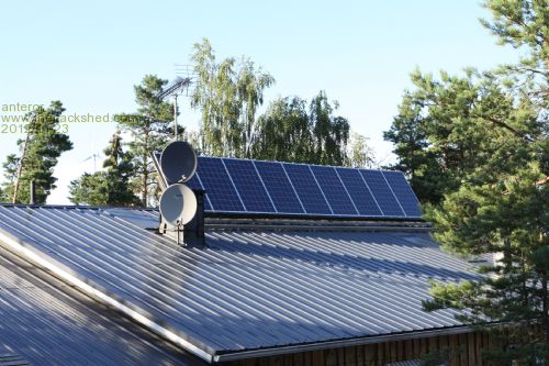

This is my solarpower unit.
I have two of these units, in other place, because of the shadow of
the chimney.
Together, 2750W and connected, to load my batteries,
without any charge controller.

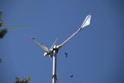

My windgenerator.
Connected without any charge controller to batteries,
with self made robust 3 phase rectifier.

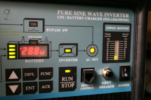

This is my inverter.
I have 2 units of these, 3000W pure sine vawe.
Have worked 24/7 without any faults for 7 years now.
