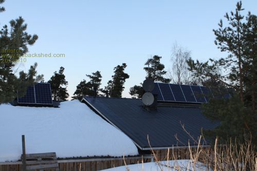

I have tested several MPPT and other solar controllers...
NOT good and do not work reliably.
The less vulnerable and complex electronics, THE BETTER
You DO NOT any of these.
You just connect the solar panels directly to load your batteries.
Nowadays the panels between 235-260-280W are all suitable to be connected
directly to load batteries, in to the 24V system.
Loaded optimal voltages are beteween 28-31V.
So, they do need any controller to load with full power.
I have 11 units of 250W solar panels and have connected all in parallel,
in a 3 unit groups(one group is 2 units..) and these groups have 20Amp fuse.(factory recommendation).
I have tried and tested these with several MPPT and I get exactly the same power
without any controller
I use this DC voltage control relay, to guide the overproduction, where I want
and protect against overvoltage, overcharging;
http://www.takowa.fi/fi/kauppa/1-vaihe-ac-dc/hrn-64
You connect this unit to guide/control overvoltage/overcharge via your inverter,
AC 240V or in some countries 110V Ac, to any chosen consumption.
You can connect panels and wind power, so much you want and guide all the power,
with these cheap and reliable relay / relays to any chosen consumption.
Etc
Antero
My windgenerator.
Has been working without any faults for over 6 years now;
Edited by anteror 2013-09-11

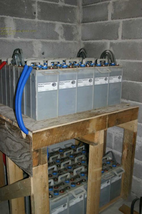

I have NICAD batteries, which are old used ice breaker ship batteries.
They have almost the same features, but not even near so good as NIFE
Edison batteries.
They have worked for over 30 years since manufacturing.
I have used them for 15 years now.
I have them 80 units 1,2V 500Ah, I have connected them in 4 X 20 unit
croups to make 24V 2000Ah.
They need to be run really empty once in the year.
That is all the maintenance they need.
You can charge them with any power and take..
BUT they will lose capacity year after year..and i can not rinse them
with water and the fluid is very poisones etc
SO.. good batteries is just, what we need, to be INDEPENDENT.
Solar and wind power is easy to have, to your own house in our time.
I will buy Edison NIFE batteries to my house after NICAD batteries.
That is what I want to leave after me to heritage to my children and to their children for decades to come.
Something truly sustainable..
Antero
Here you can see half of my batteries.
They say NIFE but they are NICAD batteries.
NIFE is the brand of manufacturer, which is nowadays SAFT batteries.
Made in Sweden.
Edited by anteror 2013-09-14
