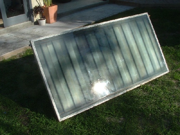

I found 3 of these solar hot water panels at the local
recycled goods shop and paid $60 for the three of them.
Has anyone out there built a solar hot water system using panels similar to these. They are "Sunbather" brand. (Sorry I forgot to measure the size)

Thanks for your replies guys. The hot water service is a gravity feed system so there is towns pressure water to the header tank and then the hot water is gravity fed down to the hot water taps. I wont be able to get the panels lower than the HWS so I probably wont be able to set it up as a thermosyphon.
Feral I will take some photo's of the inside of the roof and the HWS tonight. Also two of the panels I have
are as the photo shows which are made for horizontal mounting but the third is a vertical mount. Can they all still be used together?

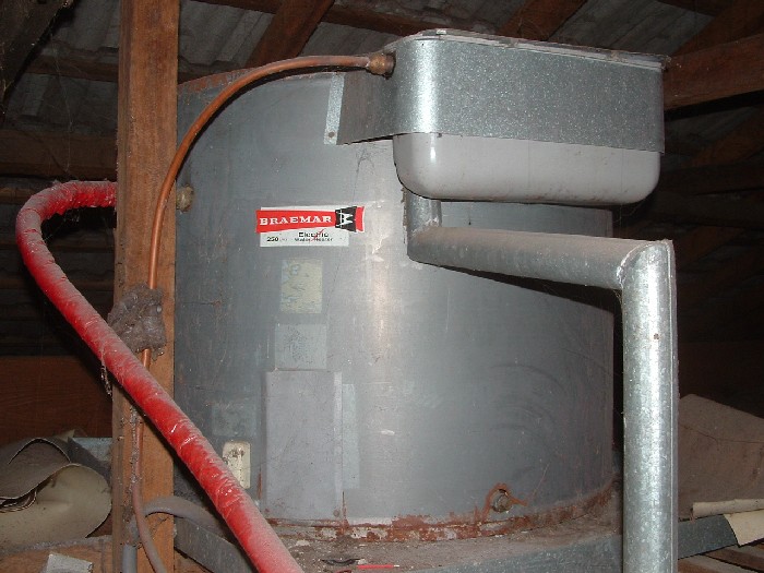

This is the HWS, Its probably about 25yrs old. Does anyone know if this style of HWS has a thermostat
that switches the element on & off to hold the water at the required temperature or is the element permanently on?

A fair bit of rust around the bottom of that holding tank ----- Don't know much about hot wter systems ,, but ,,the ones I've had are allways down under thehouse ,,fairly safe that way ,if they rupture-
( i'd hate to have one spill it's contents onto my lounge room or living room walls and such)
Think of it this way 25 years is a good life, get one installed under your house or adjacent to the kitchen , laundry ...

Sure it's got a thermostat, behind that little cover plate next to the power lead in.

Clogs, the tank you have can be used as it would be a copper tank open to the atmosphere as it has a float controlled filler valve keeping the 250 Lt tank filled with water. Is it possible to raise the height of the tank and by how much ?
If you raise the height of the tank will it then allow you to have it a little higher so that the low point of the two panels (horizontal mounted along the bottom of the roof) are then lower than the bottom of the tank ?
The heigh point of the panels,two only, when mounted along the roof should not be any higher than the red pipe on your tank. Better to be lower but level will require pump.
It does look as if it is possible but if the heights for the primary flow and return are insuficient then you will have to use a hot water circulating pump connected to simple electrical timer for 8 Hour day use only. If you use a hot water circulating pump, the pipes connecting panels to tank can be standard 1/2" lagged copper tube and I do believe that there is also poly pipe that will do for these tempretures.
If you can get the heights right and have the convection currents flowing the plug in the bottom of the tank gets connected to the bottom of one end of the panels and the top of the panels gets connected to a new additional Tee connection at the same place where the red pipe connects to the tank. A pump that is suitable would be Grundfos Comfort series 1/2 - 240 Volts Details at http://www.grundfos.com/web/HOMEau.NSF/Webopsl*g/F399452AC86 77450C1256C050039BAAA

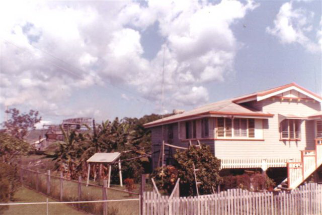

My father built one too in the late 50's. Though ours was at mains pressure and could be reconnected to 240v if the need arose(it never did).
here's an old pic of the installation.
The Shepard's crook can be seen extending well above the roof, and I too recall the annoyance of boiling water released onto the roof at the hottest times of the day.
I'm not sure how my father incorporated the Shepard's crook with the mains pressure though. I have always wondered.
