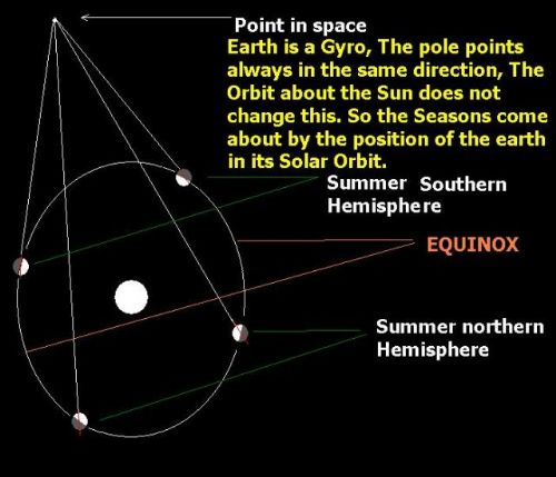

Greenbelt
Joined: 11/01/2009
Posts: 566
Posted: 06:03pm 24 Sep 2013
Hi Everyone;
A little Drawing to add to "Tinkers" suggested experiment with the Spheres.
Using a lamp to represent the Sun in a dark room, will shade the Earth Sphere for more Drama.
As you move the Earth Sphere around the Sun (Lamp) be sure to always point the Pole to a fixed point in the room, A nail head, Picture, Or the Corner at 23 Degrees off perpendicular.to plane of Orbit.
As noted in posts above, the Earth axis will over many many years change direction,(Gyroscopic Precession).
Our lifetime will not be sufficient to notice a change.
Cheers--------Roe
Edited by Greenbelt 2013-09-27
