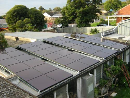

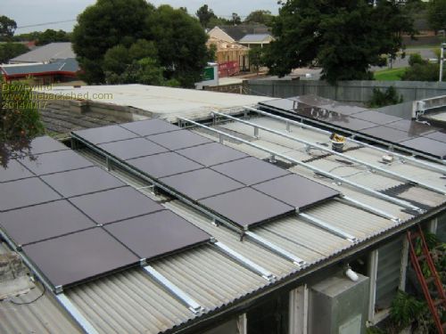

Downwind
Joined: 09/09/2009
Posts: 2333
Posted: 12:19am 17 Jan 2014
I was cheaper than that, and put my second hand panels on 75mm C section, at $20.00 for a 6.1m length (or was it 6.5m length ?)
All held down with 65mm roofing Tek screws and stainless mudguard washers.
I did put a rubber belting strip between panels and C section at the fixing points (rubber was an old supermarket checkout conveyor belt about 3-4mm thick)
To help stop the corrosion problem between galv steel and alley.
I also cut some rubber washers with a hole saw to fit under the mudguard washers.
It might sound a lot of work, but all up it was very simple to do, and worked out rather cheap for the area covered.
....................>>> several years later and have not seen a problem in any area.
The panels are a low output of 60W x 65V panels, glass top, at 12.5Kg each, so over 1/2 ton.
Why did i bother?... Well they were all free panels that i picked up on 2 pallets fork loaded onto the ute.
My workshop roof was doing nothing, and i had the area to use them, the only condition of accepting them was, they could not be used for a GTI application and no REC claimed.
There was 50 panels all up, and 2 extra have been added after the photos were taken, so about 3Kw free.
The cost of MC4 connectors and wiring, was far greater than the panel costs, and i thought the racking at under $300.00 for the area was also cheap.
Pete.
