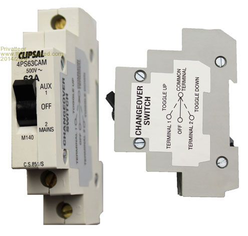

Any electrical wholesaler. Not brought one for a while but think about $60.
Edit: Make sure he/you puts a warning on switchboard about dual supply. RED label.Edited by Privatteer 2014-02-25

  Privatteer said   Any electrical wholesaler. Not brought one for a while but think about $60.
Thanks Privatteer....exactly what I was looking for.
Do these components have a "common" name in the industry, ie. what to search for.
Yes, I have the full set of labels on hand ready to use. He may be expensive but he is bloody good.

Damn it...its written on the side as a Changeover Switch, sorry.
Searched Changeover Switch on Evilbay and found it.
CHEERS!!!

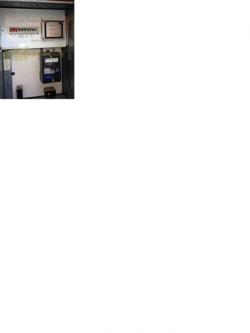

Hi Guys ,I have installed a Latronic AC transfer switch .
It is not cheap but works very well instant transfer from Inverter to Mains .
Wire the inverter to the primary input and the mains to the secondary .
Turn on the inverter and it changes instantly from mains to the solar system.

This is a picture of the switch installed
