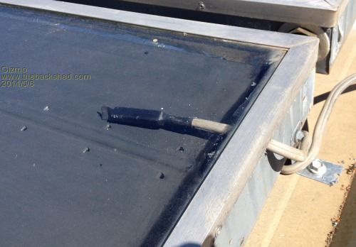

Yesterday as a experiment I fitted a couple of 22r 10w resistors into the panels. Connected in series, so each resistor was radiating about 1.5 watts, current draw works out at .27 amps. This morning the panels had a thin layer of ice, except for a hand sized area above each resistor, where it was bone dry, and the top 3/4 of each panel was also frost free, but wet with dew. Tonight I'll try the resistors in parallel, so each is radiating about 6.5 watts, current draw about 1.1 amps.
My 12v system can spare a amp or two, so its no loss.
GlennEdited by Gizmo 2014-05-07

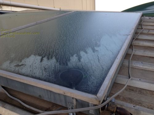

Posts: 5203
Posted: 07:56pm 05 May 2014
Photos of the resistor...
And the panel early this morning. You can see where the resistor sits under the glass.
Only the bottom corner had any frost on it, which makes sense.

Posts: 5203
Posted: 01:04pm 06 May 2014
Yeah may look into it. The heater resistors are working well, and I can spare the amps. I cant spare the water, so would need to feed the dumped water back into a tank.
Priced a frost valve, not cheap, so the garden irrigation solenoid and controller ( or add on for my existing controller ) would need to be built.
Honestly, the heater resistors are a simple fix. Silent, no water used or heated water lost. They are connected to my night light controller, so cut in at dusk and off as the sun comes up. I do have a couple of spare panels if it goes pear shaped.
