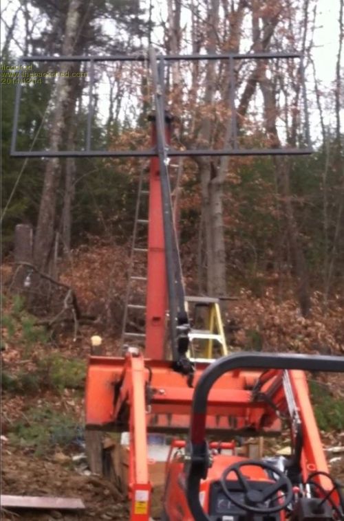

So I messed up and need advice. I'm building a solar tracker on a pole mount. Pretty large, 20' x 12' on a 11' high mast.
So I went to the scrapyard to find a pipe and ended up bringing home an I-Beam. It's 16' length.. I poured 3 1/4 yards of concrete (13,000 lbs) and mounted the pole 5' deep so now it's sticking up 11 ft.
I placed the array frame on the mount and now the I beam is not firm enough. Torsion and opposite web action will definitely buckle this beam when weight + wind are applied..
So I cut 8 angle irons and welded lateral bracing evenly spaced. This helped substantially, but I do not think it is sturdy enough yet.
My next idea is to get Sonotubes and 15 bags of concrete and encase the whole beam.
Will a 12" diameter concrete column with an I-beam encased be strong enough to hold about 750 pounds of panels and framing?

here is my home-made crane mounting the frame on the beam.. Now the beam has lateral supports

Floodrod what about bracing the tower. Pouring 3 or 4 concrete pads about 10 foot out form the base and use some 3 inch pipe to act as braces?

I tried Guy Wires and it did like nothing. The I beam still twisted easily from torsion. Not sure if pipes would be any better.
I picked poorly. An I Beam is known to be poor with torsion and force opposite the web direction. I should have researched and just bought a round pipe. But now it's too late.
From reading about i beams, seems encasing in concrete may be the way to go

I am considering drilling 6 or 8 holes in the concrete base and epoxying rebar. Running rebar the entire height in a circular cage. Then encase the whole I beam + rebar cage in 16" concrete round column form.
At the top, I will have to reinforce the exposed top portion of the beam and run the supports right down deep into the concrete column.
The triangle pipe support is still an option, but I already got loads of rebar and epoxy. So if the concrete column is sufficient, it can be completed for about $150 and look better, as opposed to $500+ and shelfing my front yard.

Did some calculations and verified with local engineers.
240 sq ft panels 11 foot high at 20 psf (overkill for my area) gives me a total force of 52,800'#'s.
So if I epoxy in six #5 rebars and install four 5/8 wedge anchors to the base of the beam (rated at 4,400+ lbs shear strength each), I am over 50,000# safe loading zone mark. Add in the strength of the I beam and the base connection far surpasses 90 MPH wind load.
I have some 1" rebar I may even throw in for extra measure.
