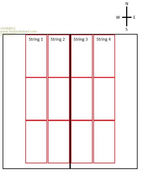

With the panels I have now are wired up in 3 series 2 parallel configuration, and when I get the extra panels it will be 3 series 4 parallel.
Hoping that this picture will help explain the final setup after the solar expansion.
At the moment I have only one string wired. Waiting on the last three panels to be delivered so I can setup and wire up the next string.
Once I have all 12 panels up on the roof they will be wired so the west facing strings will be in parallel with each other and the same with the east facing strings.

My comment would be that depending on you latitude and the pitch of the roof winter power production might be very disappointing.
it should be OK in QLD or with a flatter roof, I am at 33 deg south in SA and tilting them up so they face NE in the morning makes a huge difference.
the experimental system I done jumped from 4-6 kwh to 22 Kwh on a cloudy winter day when I tweaked the panels last year.

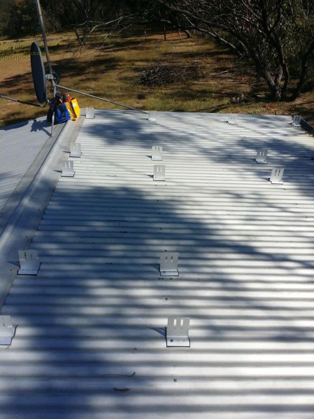

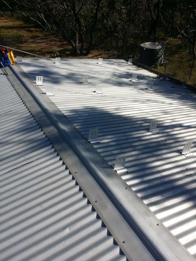

With your solar panel mounting, leave room to walk/craw between the panels. Between each row I have about 600mm, so I can get to each end of the panels. I would leave a walk way on the apex of the roof in your case.

Hi Yahoo2,
My block is in Western Australia and my Latitude is 33 degrees, 34 minutes south, so winter will be interesting for sure. But, with a combined total of 3600 watts of solar (not taking the de-rating factors into consideration. eg, east/west facing panels, only 22.5 degree pitch, temperature losses and cable losses etc.) I think that I will be fine for the most part. Once I have all the solar panels and the new battery bank, I think I will be set.

I will be leaving a walkway on the south side as well as room to walk along the pitch of the roof.
Once everything is sorted out with the mounting hardware I'll will be mounting a sprinkler system to the roof for fire protection along the west, south and middle along the pitch of the roof as I am close to a strip of bush which runs along the front (west side) of the property.

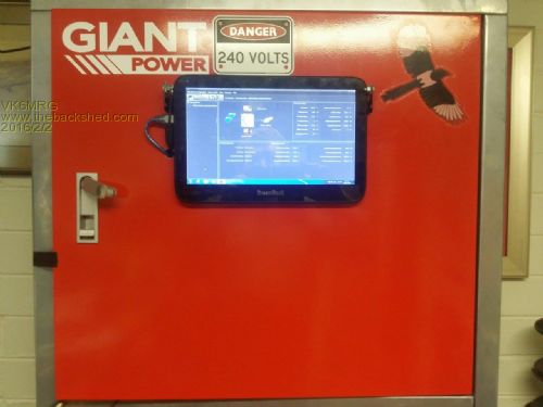

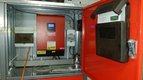

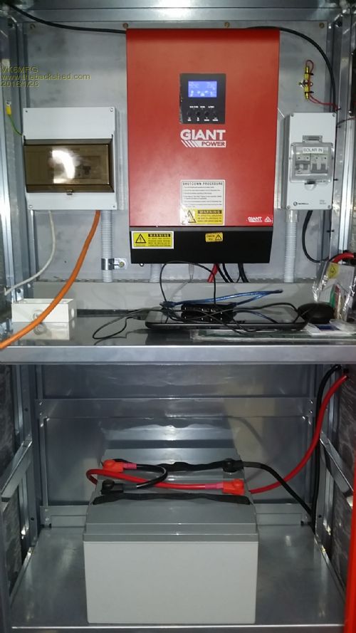

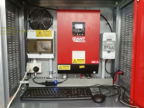

So this is the off grid system from Aussie batteries and solar. Details are at the start of this thread.
Here is a few photos of the current setup.
The other two batteries are on the bottom shelf just out of view.
Once I have installed a power point under the switchboard I will mount an old windows tablet PC to the front of the upper door for on-site monitoring.
I'm still trying to work out how I can have web access to the monitoring software but i'm sure I'll work something out.

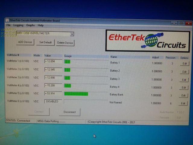

OK, I would like to upload my solar data from the inverter to PVoutput.org
Has anyone else done this?
And if so, what is required to do it?
I'm thinking that I'll need a PC or something running all the time and software to talk directly to the inverter or use the inverter software to save to a log file and import it to another program that talks to PVoutput.org
I don't really want to have a PC running 24/7. Maybe a Raspberry Pi or similar....
Any help would be appreciated.

So I have stumbled upon a YouTube person that is developing monitoring software along with another YouTube person for off grid solar.
Justin Case here
and Jeremy Ohara here.
I think that Jeremy is the software guru from what I understand.
Hopefully the software will be ready in the not too distant future and I'll be able to give it a crack.

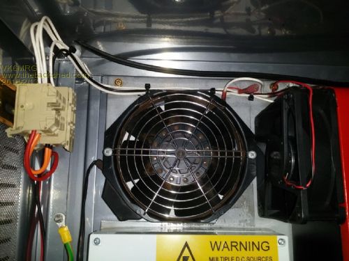

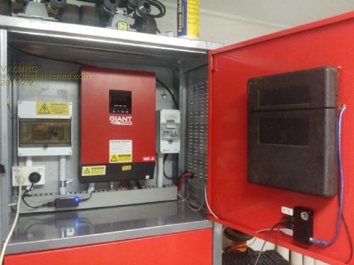

So I've mounted a GPO (General Purpose Outlet or power point) under the switch board, removed the cooling fan from the side of the enclosure (as it had very poor air flow caused by the slots on the side of the enclosure that it was mounted to), Turned the internal cooling fans over so that cool air blows up inside of the inverter and mounted my tablet PC to the front top door.
I will remount the cooling fan along the side of the IPS so that it sucks the hotter air out from the top of the unit to assist the two internal cooling fans.
My old windows 7 tablet PC (with cracked screen) mounted on the door for easy access when required. I have mounted a USB hub to the back of the door for a mouse and keyboard as the touch screen no longer works. I want to find and mount a fold-up shelf for the mouse and keyboard so they can be out of the way when not in use.
I think that is it for the moment.
Just a little update to show that the system is getting closer to being ready to install in the shed. Edited by VK6MRG 2016-02-03

So I've mounted a 240 Volt AC cooling fan to the top of the enclosure for when the system gets above 50 degrees C. This will be switched via a 48 Volt contactor in the switchboard. I just need to get the contactor and wire it up.
I'm also looking at mounting an external fan on the side of the inverter to assist the internal fans.
I may use an external fan speed controller that I made a few years ago so that the fan will alter it's speed with a rise in temperature, and when it's cool enough will shut down.

I have mounted the cooling fan to the side of the IPS and added the 48V wiring ready for the contactor when it arrives next week.
Another step closer.....

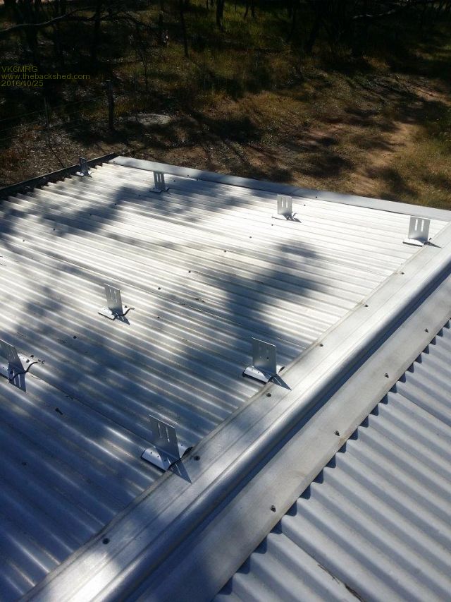

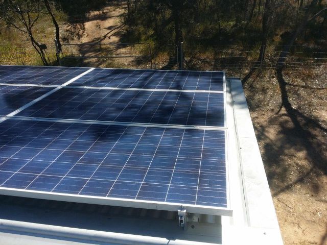

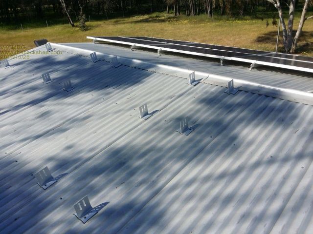

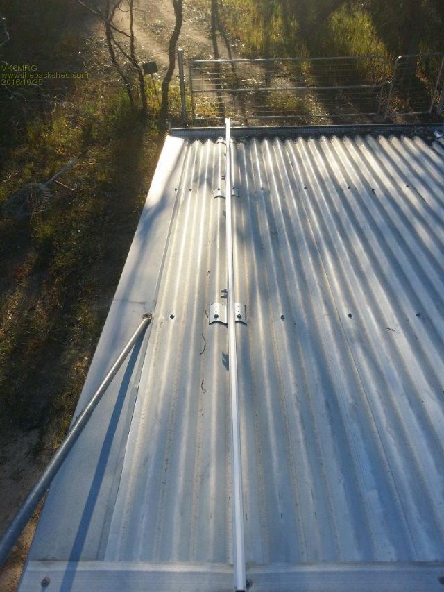

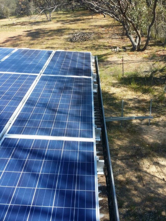

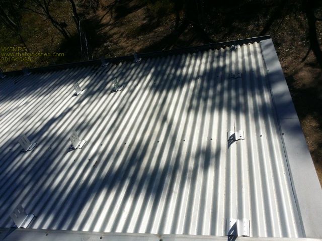

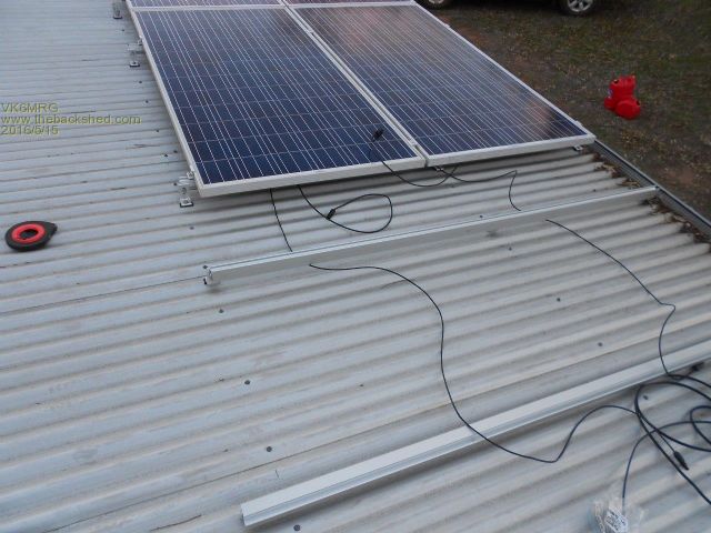

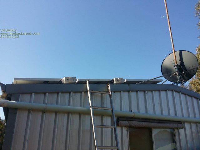

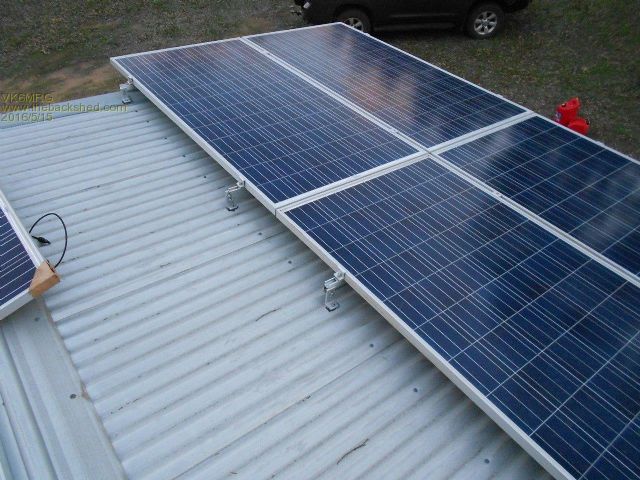

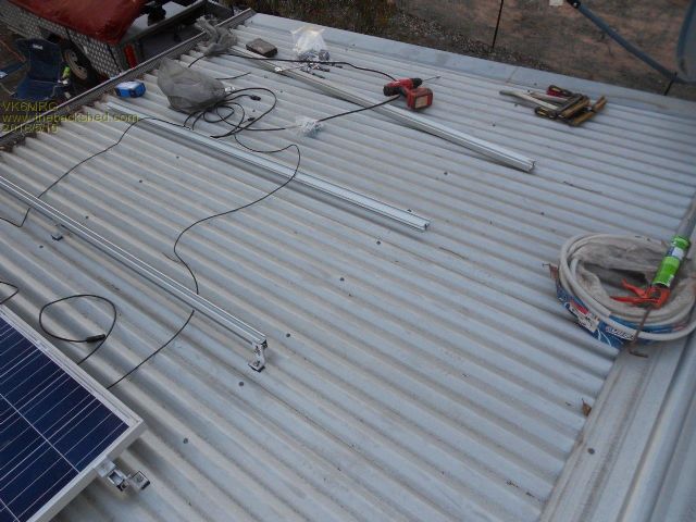

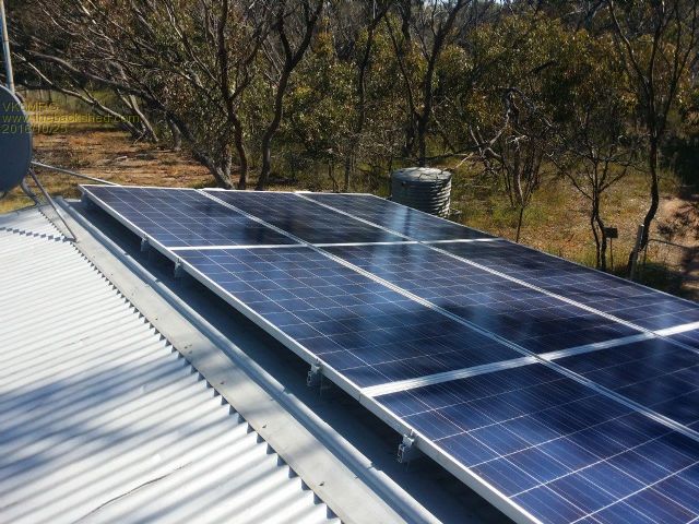

So, I have installed the system into the shed on my bush block. I will ad the few photos that I have taken .
At the moment I have 6 300 watt suntech panels which are east facing and later in the year I will add another 6 300 watt panels on the west facing side of the roof.
I have a ceiling fan, lights and a fridge in the shed and the system runs these loads with ease. Also enough capacity to run a vacuum cleaner or a kettle or even a small toaster oven.
As expected the capacity of the battery bank is very limiting, however this will be rectified later in the year with the purchase of larger batteries.
Overall I'm am very happy with the system.

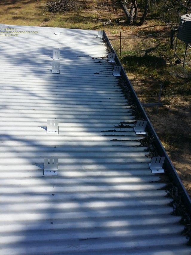

Posted: 01:27am 15 May 2016
watch the clamping zones on the panels
ie you're outside the recommended.
AS1170.2 requires clamps min 200mm from the edges of the roof = yours a fail.
Dont run them in string of 3 as they will run at 75V+ in the sun = charge controller fails everything goes up in smoke
perfectly OK to run them in pairs instead and Buck converter in the Charge controller needs to do less work = less use for the poorly vented enclosure and giant fan to band-aid that.
Pity i missed your thread - the Victron gear costs peanuts more, Lithum would be 10x the cycle life of the batts you got.
Keen to see how many "giants" you break in the coming couple of years.
good luck!
