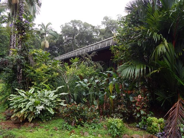

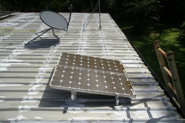

Some of my solar panels

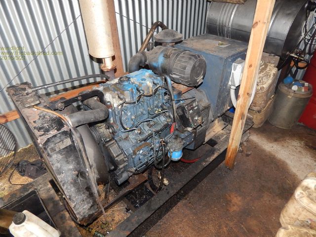

The VM Motori 22Kva 3 phase generator that I salvaged.

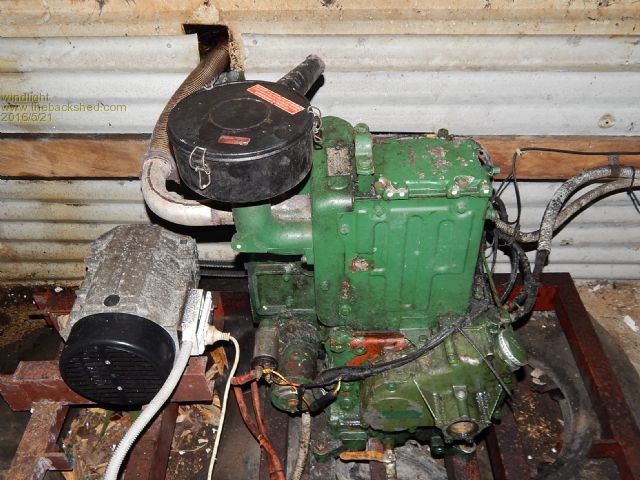

My largest lister, good for 2.5Kw.

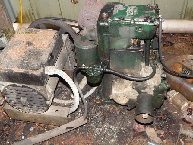

My little Lister, in use atm doing 1.5 Kw, coupled to a 55/110v alternator the output of which is rectified below

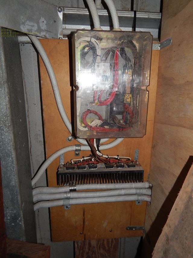

The thought of fiddling with this bunch of cables just drives me to drink.
