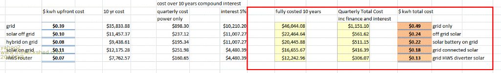

"How many out there are running 100% off solar power, no other generators, just 100% PV!"
Yes, in Portland, Vic, no generator, no wind, 100% solar. I have had wind and it is a great hobby, but it just doesn't charge every day like PV does. PV wins, wind assists but is not needed during the day, and we have long periods of no wind at nite. I will be putting up another w/g just 'cos I love them whirring and wizzing around and making electricity for free, just for fun. Best spend you money on more panels rather than a genny.
Over the years I have added to my system until I now have 20kw of panels (18 pumping and two ready to go up).
Very overcast knocks panels down to one tenth of their output, so that gives me 2kw which is just enough to get by with for the day and charge the batteries.
I am a rusted on Selectronic fan and have a few of them, from SA30's to a couple of PS1's, one 24 5kw and a 48v 6kw. All preloved.
I have used batteries that are doing fine, we don't use much over nite to save the batteries. My fridge is forced to run during the day to freeze two 3lt plastic milk containers against the evaporator, this lasts all night so the fridge doesn't run, little 24 inch 36 watt telly, and I run an air filter all nite too, doesn't use much on low speed, laptop (runs on power, battery buggered), and a CFL or two. CFL's are on a par with leds for power usage.
So how much solar is enough, I have lived with my first kw right up to my present array, I am pretty happy with it now and the law of diminishing returns is always present, at one tenth output in overcast weather, one kw returns 100 watts. That's back to the old days, $10 a watt!
MPPT, here is an example, I have a 190 watt 72 cell panel on my van. A PWM can return a maximum of 5 amps (max panel current) to the battery, that's 65 watts at say 13v. Mppt will use all the panel power, you are wasting far to much potential power with PWM. MPPT will return near 300% more power from this panel!
Sorry to disagree with you oztules, my experience with MPPT has shown them to be well worth installing.
I have 4 Midnites, they have become the brains of my system, they know the state of charge of the batteries. They have two highly configurable aux outputs that I use to control excess power use, I heat water with a 750 watt element (going heat pump soon, I was given one!). So now we have hot water on days when a flat plate solar water heater doesn't heat at all, there is still enough power in overcast light to heat water when collected with PV. I do have flat plate collectors.
Of course I have a lot of power available when the sun is blessing us that I am unable to use, that's the price you pay for having enough power when it is overcast, and in our climate, that's near all winter. To be realistic, we need 20kw with no generator, that was one of my goals, no genny.
As my system has grown ad hoc I have ended up with both a 24v and 48v system (oh, yes, the original 12v system is still there too, I use 12v for solar heating control, and car radios in various places).
How much does it cost? Far too much, I would have paid electricity bills for the rest of my life if we had stayed on the grid. (I'm an old bloke tho)
I justify the expense because it is my hobby (system all self installed), power security and the future, who knows what power will cost in the coming years.
We use 20kwh a day, more in summer pumping water, I filter used cooking oil into a vacuum to dry it, this runs a vacuum pump, a little eBay centrifugal pump, and a 200 watt heater to warm the oil for filtering, my old Toyota runs fine on it and has done many 1000's of km.
We cook with a gas stove but have a microwave and no probs to use the electric frypan during the day. We use a little electric kettle during the day too. The best way to cook with electricity is the slow cooker, they only draw 100 watts or so and tea is ready when you are, convenient.
So keep on buying panels folks, that's the way to go, and as I read in a post here they are cheap used, nothing wrong with the 190's, there are quite a few of those advertised, but do invest in MPPT for best return from your panels, it is money well spent. The Midnite is among (if not) the best, pretty pricey, but after the money has gone you are left looking at a very clever piece of electronics that can do a lot more than charge batteries, made in USA. I have the 150's, 4 250w panels or three 190's in series.
