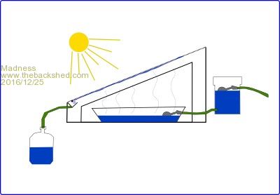

Another option is a solar still as shown below, water is condensed on the glass lid and runs into a plastic trough.

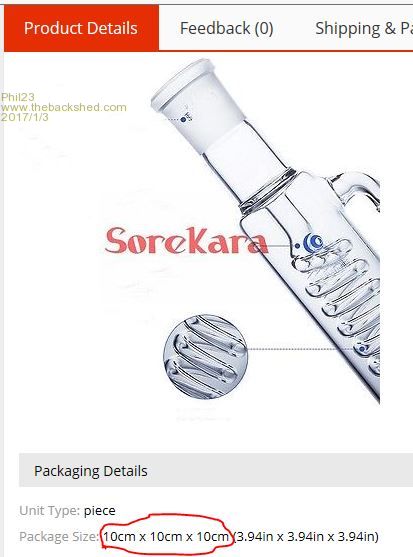

For less money than that I can get one of these Condensers but would it be suffcient?

The real problem with distilled water in batteries are the metal ions (if any).
De ionised water is arguably better, especially if you buy your distilled water in a plastic bottle, you have no idea where it came from, how it was made, or what it was previously stored in.
Freshly made, properly distilled water that has never contacted any metal is the very best thing of all.
The problem with solar stills will be the very low quantities and the high possibility of contamination because it takes forever to make any useful quantity.

Posted: 12:12pm 25 Dec 2016
  Madness said   For less money than that I can get one of these Condensers but would it be suffcient?
There !
That is it, the real thing.
I thought they would be a more expensive than that.
I am going to get me a couple of those.

I need about 10 litres a month, my current source is $1 per litre.
RO filters are around the same price as a glass condenser, all going well the condenser should last indefinitely.
Based on the information provided my plan is to get a glass condenser as per above,

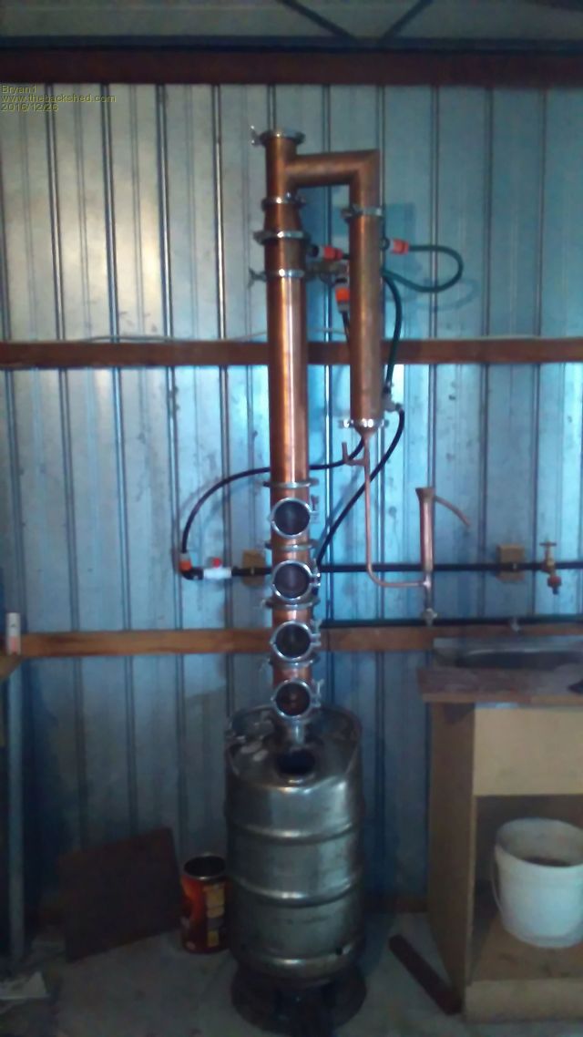

Posted: 06:18pm 25 Dec 2016
G'day Guy's,
Well not sure how long my deluxe water distilling appliance will stay up but here it is...
