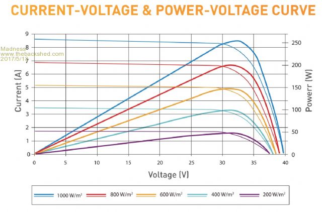

Madness
Joined: 08/10/2011
Posts: 2498
Posted: 01:25am 13 May 2017
This graph for some panels I have says volts stay the same at different light levels.
isochronic
Joined: 21/01/2012
Posts: 689
Posted: 01:49am 14 May 2017
thanks for that
I am thinking, if a panel power max is aligned to a reasonable battery charging voltage (and the battery is protected from over-voltage) the panel will automatically be operating close to the optimum point
Edit - I guess that then leads to whether the temperature of the panel needs to be allowed for, as well.. If it gets hot, the voltage drops..maybe too much..hhmm.Edited by chronic 2017-05-15

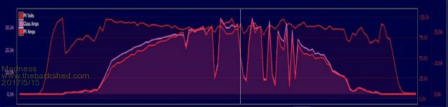

Madness
Joined: 08/10/2011
Posts: 2498
Posted: 04:39pm 14 May 2017
MPPT as the name says is tracking maximum power point, the graph below is from one of my Midnite Classic MPPT charge controllers. It operates at a lower voltage earlier in the day and late but during the day with clouds coming over there is little change in the volts.
Top red line is PV volts, other red line is PV amps, violet line is Amps out of the controller.
Edited by Madness 2017-05-16
isochronic
Joined: 21/01/2012
Posts: 689
Posted: 05:40pm 14 May 2017
What is the load (controller out) voltage, I am guessing 24 v ?
[nice chart too..]Edited by chronic 2017-05-16
Madness
Joined: 08/10/2011
Posts: 2498
Posted: 08:55pm 14 May 2017
It is 48V, there is a lot more information available but I made it simple for clarity.
isochronic
Joined: 21/01/2012
Posts: 689
Posted: 09:40pm 14 May 2017
Doh ! I was looking (squinting) at wrong scale ! (30 etc on left but that is current not volts, now I see volts scale is on right ).
