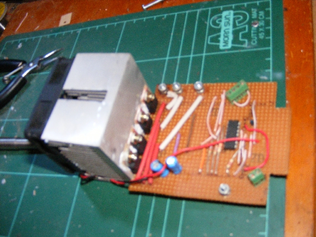

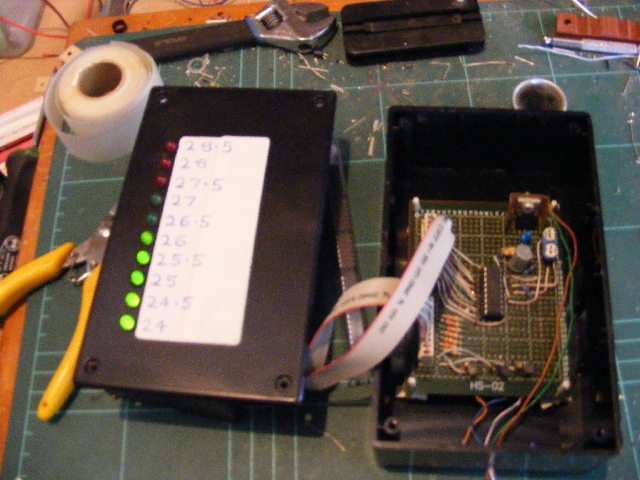

Well after studying Amanda's LM3914 charge controller schematics for months I built a cut down version of circuit 1. Basically the first led comes on @24 volts then each led lights up in 1/2 volt increments and when the batteries hit 27.5 volts the first dumpload starts. Likewise when the batteries hit 28 and 28.5 volts 2 more dumploads start. My first dumpload will be about 2 amps, second 4 amps and the third 8 amps. The dumpload board is based on the TC4469 fet driver on 12 volts as my controller boards works on 5 volts I needed a minumuim of 10 volts to drive the fets on hard. All the credit goes to Amanda and as far as an effective analogue controller this baby has to rate very highly.
This is the LM3914 circuit
This is the dumpload circuit
Cheers Bryan

Well Guy's last weekend I got to install that dumpload controller and tonight I checked it and it's working perfect. When I installed it I turned everything off and made sure the the dumpload started at 27.5 volts and sure enough as it was sunny I got a hiss from the radio everytime the dumpload connected. currently I only have my 4 amp dumpload connected and after near a week of no shed activity the batteries are sitting on 27 volts and the dumpload was still warm @ 6.30 pm just on dark when I checked it. Sure it's only a analogue controller but I'm positive it will work for years with only the dumpload load to be refined.
As I put this thread up it seem awhile ago and I hope I haven't trod on any feet with this simple but efficitive controller as I aint had a reply.
Cheers Bryan

That sticker with the voltages scribbled on it ruins the presentation though. Perhaps that one's just for assembly? That type of plastic can be a bitch to label so on one project I drew up a label, printed it out then laminated it and glued it over the face. Not super professional yet served the purpose.
I like you're processor fan cooling for the MOSFET's. Neat and compact. I'm sure you'll get years of reliable service. Simple sound designs seem to go forever. Well Done.
